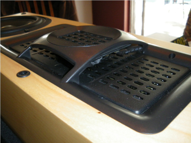

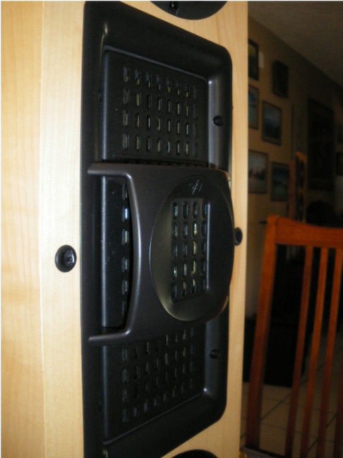

More neo10 and Neo3 fun.....just bought one of these to use as a center channel. Can't beat the price plus free shipping!
BG Radia Z-62 High Performance 200w Loudspeaker with Neo10 and Neo3 planar panels - Cherry | AV-Express
I will be modding with better damping like Bonded Logic on the inside, but seems like a steal giving the clearance price. Curious so see how the coaxial mounting thing works.

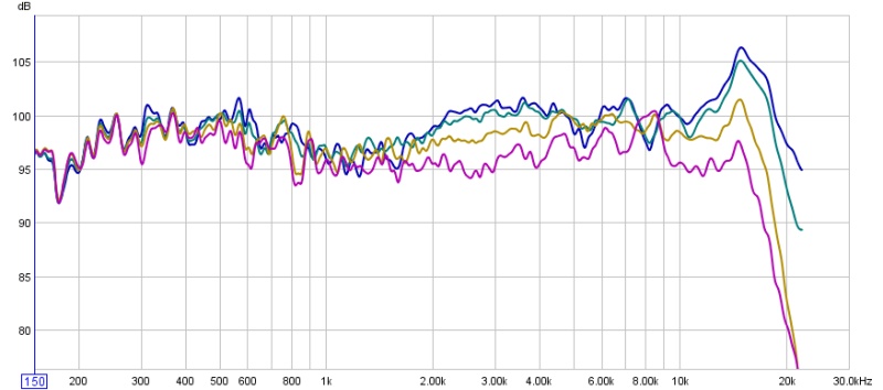

I've been curious about BG's coax approximation for some time as the arrangement's a bit unusual. I'm inclined to think of it as a compact MTM but it's not immediately obvious to me how much sticking Neo3 in front of the Neo10 tends to widen the Neo10's horizontal dispersion---measurements on this should be interesting. The back cup's left on the Neo3?
Yes, back cup is on Neo3 and then there is a thin sheet of something soft btw its back and the front of the Neo10. Horizontal dispersion is next to nill as expected. Looks like my seat in the middle is it....everyone else be damned.
Sounds pretty decent so far. Bass is a little tubby, but I will be filtering out below 80Hz anyway, so no problem.
I think the coax arrangement mounted vertical with a nice woofer next to it would be sweet.
Greg

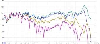

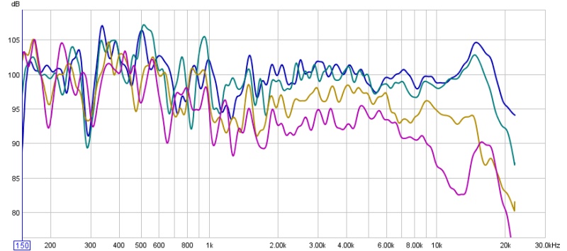

Neo10 directivity's shot. Ouch. I was hoping for better.
What does that mean, mine have just arrived.
Do the Neo10 etc have "Thiele / Small Parameters" or is that all out the door with this type of driver?
It means I'm disappointed in the performance of BG's coax module.
