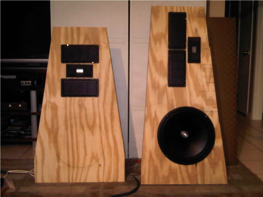

Agree; you might notice I built a nude first. 😛 But dipole waveguides are interesting on things like the Neos for directivity purposes and it's not clear to me symmetry cancellation of diffraction holds for cone woofers. Also interesting to explore baffle tradeoffs other than the ease of construction favored by flat, U, and H baffles. Bunch of research topics which may or may not prove to have something useful behind them.you pretty quick get into horn territory - with all the fuss of pro and con and the never ending discussions connected to it
This is into a 3-6 ohm dummy load or real driver in about the same range so the additional load of the Saffire's line ins should be negligible. I did the oscope measurements with the Saffire attached.Maybe difference between sound card and osci measurement is related to the huge difference in input impedance?
Tried zooming in dB but not in frequency. Will check on that next time I'm doing IMD; this is with 32k point FFTs so I'd expect the 1.5Hz resolution to clearly resolve the tones.
Something that I always do when designing a system, is at some point when I think that I am liking the basic crossover points and general relative levels, I will solo each driver to hear exactly what it is doing. I've been keeping the crossover point on my design btw 2.5 - 3KHz. Well, when listening to just the mids and Raal together today, on some vocals, I was hearing some distortion. I had the music quite loud, so I assumed that it was the lower range of the Neo10, so I moved the lower crossover point from 300hz up to 400hz. This did not help. I then solo'd just the Neo10 and no problem. Solo'd the Raal and there it was! Wasn't liking the 2.5Khz. All slopes are 24dB/oct. ended up all the way up to 4KHz and all was good. Neo10 sound just fine that high. Actually, they sound great, giving a little more umph and thwack to snare drums and mid heavy transient sounds. I do NOT want to see what this will do my polar response, but hey, something has to give with priorities and tradeoffs.
To bring this back around to your own project, I would suggest you try listening to just the Neo3. You might find that it gets a little harsh due to your lower xover point. Try closer to 3-4KHZ. You might be pleasantly suprised.

No need to keep it tied to my build; this thread's intended to be more general than that. If you're driving the Neo3 hard a high cross is probably needed to clear the distortion spike around 2kHz---see the blue curve in the Neo3 data in post 1 of this thread. Does this also show up in your measurements? My typical levels with my 1.7kHz Neo3 to Neo10 cross are 5-10uW RMS and 500uW peak on the Neo3 (uW is not a typo; it's what I get from TrueRTA after calibration). That's below the green curve in the same figure, so for me the Neo3's not excursion limited until comfortably below 1kHz. A 1.7kHz LR6 cross clears that easily; in a previous iteration of this system I crossed the Neo3s at 1.6kHz LR6. I've crossed the Neo3s as low as 1.2kHz but found the results from 1.5kHz and below unsatisfying; need to go back and revisit them with more attention on phase matching at the cross and IMD as the THD data suggests 1.4 or 1.5kHz should be viable.Try closer to 3-4KHz.
Listening to individual drivers is quite helpful in my experience. I do it often, both with the Saffire's output mutes or by sticking my ear next to one of the drivers. One of the things I like about digital crossover and EQ is the ease of auditioning and measuring different configurations. While I personally don't care for the directive sound, my experience is the Neo10 makes an excellent full ranger and I prefer the Neo10s by themselves to a high cross to Neo3s. I find the vertical directivity glitch between the 10 and 3 annoying with crosses from 2kHz up and noticeable at 1.8kHz. 3kHz+ is a non-starter for me, but then directivity is the dominant speaker design criteria for me---for a lot of folks it's volume. So where 3kHz is what's needed to satisfy their requirements 1.7kHz works for me and I may eventually lower the crossover. (I wanted to spend some time getting used to 1.7kHz first and, as I'm currently fussing with power amps, the system's undergoing a lot of changes around which amp is handling which driver. I'm reluctant to complicate my subjective impressions of the amps by changing the crossover and EQ at the same time.)
See posts 1 and 20 in this thread. Any Neo10 front/rear asymmetry from the Neo3 cable is below measurement noise so I expect equally good matching once I get around to vertical polars. My avatar should give you some ideas about knocking the back cup off the Neo3W, though I believe some folks take them off with knives or chisels. You could probably also get some without back cup from Madisound since they're sold that way in the Nao Note driver set.
I was reading through Zaph Audio site re the Neo3PDR & he had this to say " Note: these were tested with the rear chamber in place. Later, with a different pair, I also tested with the chamber removed. The tweeter was far too overdamped in that case, and I recommend leaving the rear chamber installed." ?

Interesting info here. I am moving away from better directivity I think....not sure yet, but something has got to give with this combo of drivers I've got. I don't have any Neo3 around, so I can't really help out there and it sounds like your power levels are considerably lower than mine. Mind you, I don't listen like that all the time, but it needs to be there and be CLEAN when I do wanna rock out. Average levels when I heard the straining of the Raal were around 85 dB SPL with peaks 10-15 dB higher with good, non-overcompressed material.
Also thinking about filtering the Dipole 15s below 50Hz and adding a pair of Rythmik Audio 15" servo subs along each wall behind the baffles. Not that the Dipoles really have any problems at anything less than VERY loud levels, but hey, I like my headroom. This is to be my own personal "BEST", so go big or go home.
Below is version 2.0. My attempt to control the side wall reflections more BEFORE adding acoustic panels. If I could afford more Neo10, I would make a virtual coax to surround the Raal. That would be sweet! If I ended liking some smaller cone drivers, this was my original intention. To kind of create a large oval around the Raal. Inspired by the Legacy audio Whisper and Helix models.

Oh, sorry, my bad. Distortion knee on the Raals in your measurements is 2kHz so basically the same reasoning ends up applying for 140-15 crossovers though. 😛 The Neo3 has more low end grunt than any ribbon I know of; not surprising given its larger Sd.I don't have any Neo3 around, so I can't really help out there and it sounds like your power levels are considerably lower than mine.
No change with frequency zooming as well as dB zooming. TrueRTA shows a flat frequency response but I only have the one octave resolution demo so that's not very useful.Had no such issues - have you tried to zoom in to see if its a display problem?
I get the same 100% CPU problem with ARTA as with RMAA, so no love there either. I can record a .wav in Audacity and FFT it in Matlab, but that's starting to get a bit silly.

Disclaimer: I'm recovering from a surgery yesterday and am still a bit of a froot loop from the anaesthetic so this post may need a correction or two.
The digital crossover, EQ, and preamp I'm using here is cheaper and more capable than the Parasound Halo P3 and Ashly XR-1100 it replaced. I don't have any analog sources, but the ADC blocks on the CS4272s in the Saffire are quite good and are included in that cost. Granted, the thing needs a PC to run it, but the accounting gets kind of complex there. A pair of balanced MiniDSP+MiniDIGIs is USD 400---USD 175 cheaper than my PC cross and USD 225ish cheaper than the P3 plus XR-1100---and offers roughly comparable performance---no PC required other than for programming, but linear phase is much harder and the parts spec slightly lower. From a fidelity standpoint, the best power amp channels I know how to build DIY for around USD 45. They are, however, limited to roughly 0.5W peak. At 110dB in a three way you're looking at 50 to 100W per channel which can be DIYed for USD 100 to 150 per channel depending on design choices. A decent used commercial amp provides two channels, typically costs USD 500 to 750, and is lower performance. If you're one to DIY speakers but not amps then obviously triamping is going to cost, but I don't see triamping (or quadamping) as intrinsically cost prohibitive---and if the budget's tight you can drive the DIY cost down at the expense of some performance with chipamps.
I've no plans for measurements over 100dB; would have to make major system reconfigurations to get the amps to run that high. I think the ~80, ~90, and ~100dB data I posted could be extrapolated to 110dB with reasonable accuracy. However, the Neo3's rated to 50W peak, so it'll just hit your 110dB target, but is rated for 10W continuous. Testing it at 110dB gets a bit tricky; see the thermal compression in Segfried Linkwitz's 64W burst tests---there's a dedicated thread on them in this forum as well as some discussion in Stig Erik's build thread. I would calculate wedge thickness based on the foam's NRC as a function of frequency. Easy to stick a sheet of it between source and mic and do a frequency sweep to get the absorbtion before cutting, though with nude Neo10s I would use front and rear sheets.
You're just hitting the old axiom of speaker design that's straightforward to build a good speaker a loud speaker, but building a good loud speaker is much harder. This is particularly true of directivity. My attempt at a three way point source dipole falls at the low SPL end of the design space. The Note also offers excellent horizontal directivity for about the same cost in drivers but makes greater sacrifices vertical directivity---the vertical listening window John Kreskovsky specs is too narrow to work well for me personally and I'd definitely need a ceiling absorber to manage the vertical time alignment---along with incurring the complexity of 3.5 way design and a baffle to obtain higher SPL. Stig Erik's build is optimized for a specific listening position and, as I understand it from his posts, relies on a dead end-dead end room configuration to manage the lack of coherency in the reflected wave pattern.We are presented with seriously conflicting design objectives. What a conundrum we're in!
