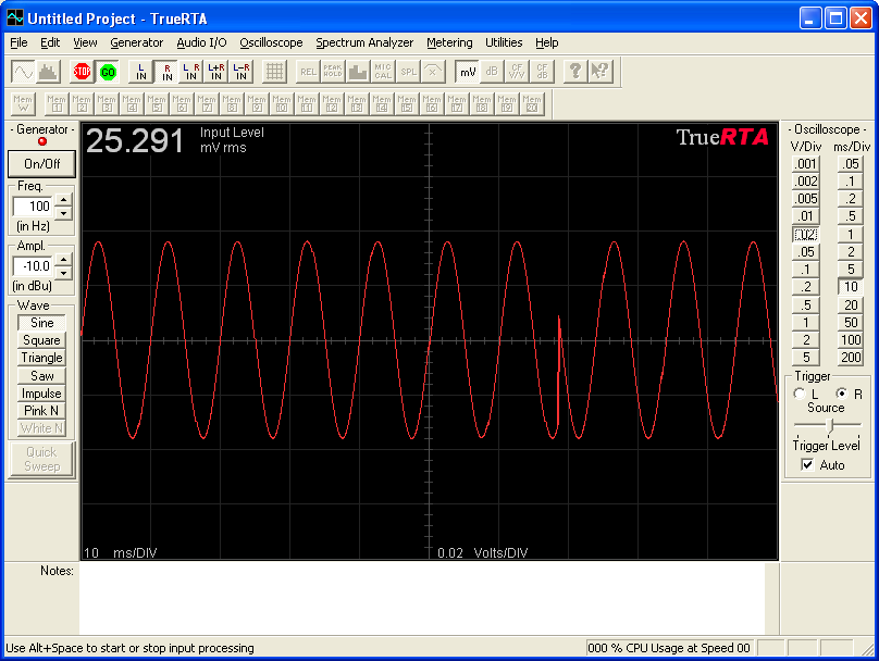

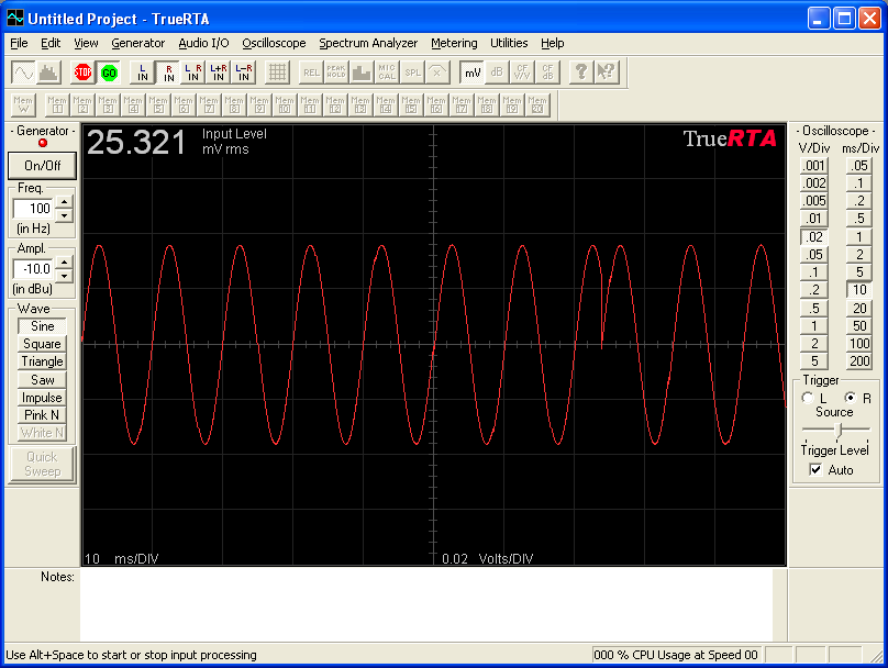

This, of course, calls for pictures. The first two figures are output discontinuities caused by Arbitrator's lack of windowing not creating smooth transitions between blocks. As the 18SWS1100s output significant SPL up to 13kHz or so these discontinuities effectively reduce the speakers' SnR pretty much everywhere. The same issue occurs with the Neo10s, though the discontinuities are smaller. The whole point of writing Cross Time DSP was to get rid of these glitches (see discussion of stream based versus block based DSP in the links above) and, while I'm a little too close to this to qualify as an impartial observer, I'm scoring 100% discrimination in favor of stream based time reverse IIR in something that's arguably a reasonable approximation of single blind A/B testing. Changing to over to the Squeezebox and uprezzing to 24 bit seems to have wrung a bit more performance out of the system as well. A lot of that's probably just from getting away from the CD player's failing transport but blind A/B between 16 and 24 bit source files on the Squeezbox is strongly in favor of 24 bit. I'm not sure where the difference comes from, but I'll take it. When A/Bing between the two 16 bit sounds somewhat grainy.

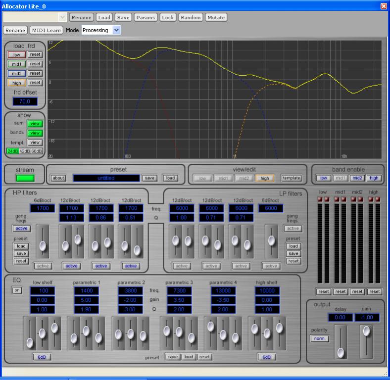

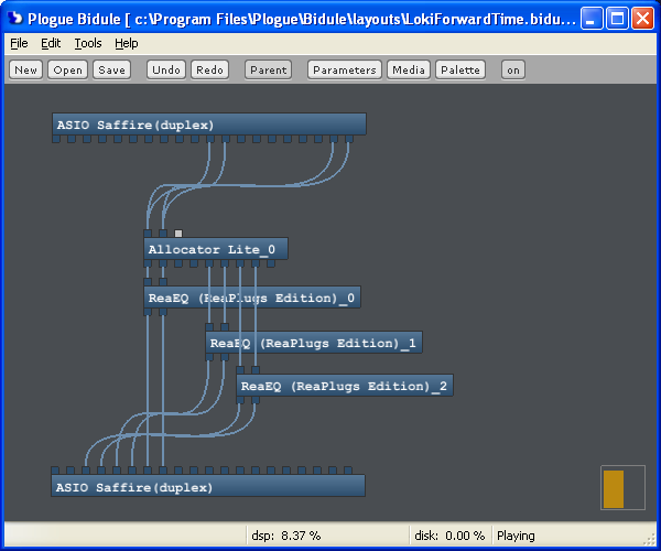

The last two figures are the Allocator Lite and Bidule configurations I'm currently using. The Allocator Lite settings are just a copy of what I was using previously in the forward time portion of full Allocator. Since Thuneau VSTs don't support all pass filters the ReaEQ VSTs are added to Bidule to provide the dipole cancellation allpass discussed in the Cross Time DSP docs. Only the ReaEQ_0 instance actually has a cancelling allpass---the other instances are just there to match delays between channels.

As the 18SWS1100s output significant SPL up to 13kHz or so these discontinuities effectively reduce the speakers' SnR pretty much everywhere. ....

Well, CD players with tracking troubles are nothing new. Neither are 24 bit samples. Removing the discontinuities from unwindowed, block based time reversed IIR is what you'd expect from a global SnR improvement; sound's a bit smoother overall and you notice more details if you're listening critically.(and, you didn't mention how it sounds after those you've done)
One possible explanation for 24 bit sounding better is it's a DAC thing. The DACs on the CS4272 codecs in the Saffire 40 I'm using for playback are 19 bit. The NJM4565 op amps Focusrite uses as output buffers are quiet enough to hold that, as are the LME49710/49990 and LME49600s on the power amp. The LME49713 channel loses a bit or so to current noise but, other than the noise floor, seems objectively and subjectively identical to the 49710 and 49990 channels. In other words, whatever's going on shouldn't be the result of hearing differences on the 17th or 18th bit. The power amps have unity gain and there's about 6dB of gain built into the Saffire's outputs, so with this system's efficiency and my typical playback levels the CS4272s are usually operating between -6 and -30dBFS, depending on which driver you're looking at and the music's PSD. So the music is playing back with around 12 bits RMS of dynamic range with 16 bit samples and 13 or 14 bits with 24 bit samples. That 16 bit sounds grainy and 24 bit sounds smooth when A/Bing between them therefore seems to suggest the difference between 72ish dB SnR and 85dBish SnR is audible. My place is pretty quiet but the ambient noise floor still is maybe 55dB SnR in the midrange and 70dB on the highs. The dynamic range of any given type of hair cells is about 45dB with the cochlear amplifier acting like a class H preamp to get the ear up to 130dB. While the brain's spatial processing allows you to hear things below the ambient noise floor of an omni measurement mike, directly hearing the SnR difference between 16 and 24 bit would seem to require ~25dB of noise rejection and cochlear amplifier slew rates an order of magnitude higher than published psychoacoustic data. Both of these seem improbable, so I'm inclined to reject this line of reasoning.
An alternate explanation for 24 bit sounding better is reduced truncation error when converting in and out of the double processing performed within Cross Time DSP and Allocator Lite or full Allocator. Since the source data from the CD is 16 bit it would initially seem improbable this matters. However, since inverse allpass processing moves spectral content between samples there's quantization in phase as well as in magnitude. With a typical music PSD and a typical recording a 1kHz sine would usually be around -40dbFS. At 44.1kHz positioning such a sine with 1 degree accuracy requires resolution to -75dBFS at its zero crossings, rising to the 24 bit precision limit of -144dBFS within a sample or two of its crest. The audibility threshold for phase errors depends somewhat on what psychoacoustic data one's looking at but the rule of thumb I've arrived at is you want it to be flat to better than 15 degrees between a few hundred Hz and a few kHz, ideally within 5 degrees if you can do it. This would imply 24 bit sounds better because the extra two or three bits it makes available allow more accurate time domain placement of waveform crests.
Yes; I have a variety of characterization data with various amounts of forward and reverse time processing. The only thing which moves the SPL is deliberate EQ. Besides, the primary value proposition for swept sine or chirp measurements over of MLS is their significantly better noise rejection---tossing delta functions into a properly implemented swept sine raises the reported noise level but hardly moves THD.Are you sure the HF response of your 18SW1100s is intrinsic?
