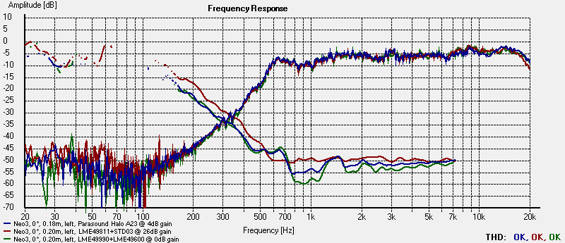

Thank you, first measurements are promising. Electrical measurements are below the distortion floor on the Saffire---gonna have to upgrade its op amps---but the impact on the driver from getting the amp GBP up and operating at unity gain to take some of the stress off the Saffire DACs is interesting. That THD hump on the Neo3 at 1.4kHz appears to be a pendulum resonance. So far I've only figured out ways to make it worse (my record so far is boosting it to -20dB by attaching an oscilloscope probe to the driver 😛), but there should be ways to make it better.

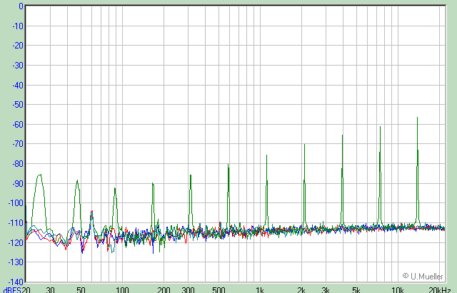

Apropos of the couping issues being discussed in DQ828's build thread I thought I share some of this weekend's crosstalk data from my amp project. There are various advantages of putting amps onboard speakers---tidiness probably being the main one, particularly if cable sleeves or a snake are used for the inputs---and I happen to be working with a compact triamp which represents something of a best case for aggressor signal rejection. The amp channels are 2cm by 5cm with balanced inputs whose shield stops 5mm from the board and the passives are 0805 and 1206 resistors and caps. In the attached figure blue is the noise floor of my measurement setup, red and teal are the amp output with the board literally sitting directly on the 18SWS1100 magnet in a couple different orientations right over the voice coil, and green is the DS/Rnonlin multitone IMD signal I like to use in such tests. Specifically, red is with the board horizontal and teal is with the board vertical and parallel to the Neo10. Horizontal should be minimum field coupling to the 18SWS11000 and vertical maximum. Pickup from the Neo10 is roughly equal in both orientations and would reduce with the board vertical but perpendicular to the Neo10.
audioTester seems to have some issues resolving peaks---the tones should be even at -55dBFS and a look with the oscope confirms that's what's happening on the wire (I have to get around to trying ARTA). But, possible audioTester dodginess aside, I have yet to find any placement of the amp board where I can get any crosstalk from the drivers to show up on the amp output; there's no sign of an IMD floor lifting above the noise floor. There might be a few peaks coupled in with the board vertical but this data is averaged across several samples to try to go fishing below the noise floor and even then there's a couple dB of variation in the peaks around the averaged noise level. So I don't see the bobble at, say, 520Hz as significant.
this mass ratio usually is already way good enough - even for lightweight chassis as the NEO's
Yea, verily. I've not seen an Mms estimate for the Neo10 but for the Neo3 I recall it being around 0.03g, a 100000:1 chassis:membrane mass ratio. Cone drivers are usually more like 1000:1 and I would expect the Neo10's probably comfortably above 10000:1.
Ok, got your point...
Let me know if you come up with any ideas. 🙂 I'll see about doing the same check on the other drivers.
Had no such issues - have you tried to zoom in to see if its a display problem?
Maybe difference between sound card and osci measurement is related to the huge difference in input impedance?
