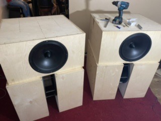

Dual 18"s facing each either in a 922cm2 slot, ~ 5.5inches wide, 20inches deep. 29 inches tall. The term musical subwoofer, in my humble opinion....is just a subwoofer that stays accurate through its upper passband. I don't want to exactly point at a driver, but rather using properly by only letting the driver do what it can do very well.
I'm not an expert by no means but I study really well and created some ideas
People refer to the AETD18H+ as a musical subwoofer....there's a formula for this type of driver, you can find an equivalent in most brands...lightish cone, high motor strength, low qts, low qes, low Fs, low le, high vas, nice amount of xmax. I'm not sure if I got the formula exactly right but from what I recall this is a formula for a driver thats good for horn loading as well? Dr Geddes doesn't entertain many specs for bass drivers....that says to me that the idea of a musical sub has nothing to do with sub bass....and likely more to do with midrange that a driver is effecting.
I personally think GD from filters may be an issue, vented designs not geared towards scientific SQ, placing the cutoff too high in the passband and creating a strong offset of time to peak energy in the bass region when combined with steep low pass filters...likely around 100hz, pushing GD way out.
Another issue may be decay....is it possible that these heavy cones, have a little too much decay somewhere in the passband? personally I think its more a design flaw than a driver flaw. If you aim for high SQ in every part of the spectrum you end up with Drivers that can't be seen moving during normal playback. Or at least barely moving regarding sub bass....
Its likely that if you stop forcing a driver into its "red" they are all "musical"
