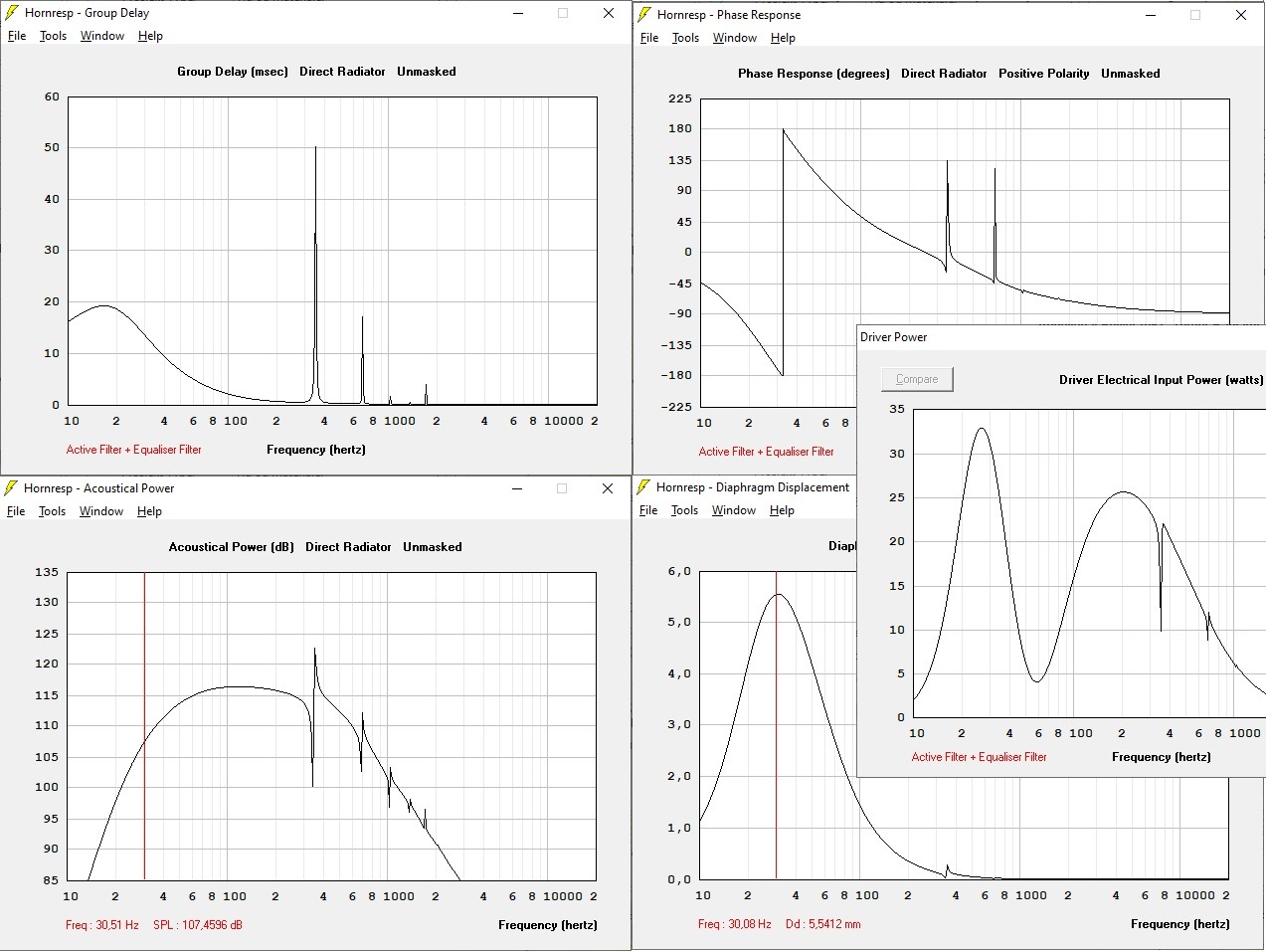

Here's the previous sim with the double 15" vented (black) vs sealed (gray), equal power (28,3v/two drivers), equal box volume (223 liters).
I use offset 2nd order Bessel around 200hz to almost-phase align.
No highpass unless I use them outdoors, 5,5mm xmax.
Was important to me to have resonance at the lowest point of most of my music collection, so I would not need a highpass filter.

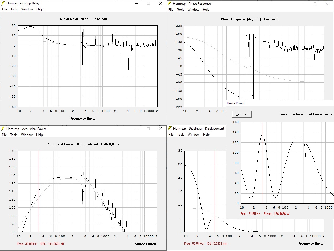

Here's one more, if I adjust the response to be somewhat compareable with a Q 0,5 +5db 30hz boost and a 2nd order hp to protect the driver , I run out of xmax with only 35 watts, do note the somewhat similar phase and group delay with only these modest adjustments.
That's 107db/32W vs 115db/136W, quite the difference IMO.

Those graphs illustrate what I mean very well. By using the port, you've gained 10dB more sensitivity (if I'm reading the relationship between the graphs correctly) rather than lower F3 - but that's a fine tradeoff that you can make. You can trade between lower F3 and higher SPL by adjusting box size and port tuning to suit your needs.
However, look at your phase graphs. On the ported box, the port tuning (from the impedance graph) is at 65Hz, and you can also see that that is the frequency at which the combined phase passes through -90deg, which is 180deg from the HF response at +90deg. So you have the classic 180degree phase shift of a helmholtz resonator.
You seem to have a similarly huge phase shift on the sealed version though, which is not necessary - it is possible to build sealed boxes with better response than that. I think it might be because you used the same box volume for both sealed and ported versions, whereas (for a given driver) each configuration needs a different volume for optimum behaviour.

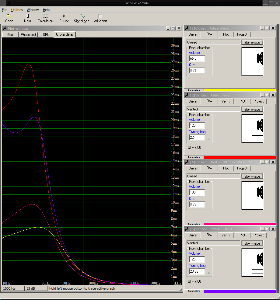

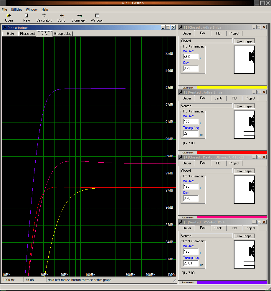

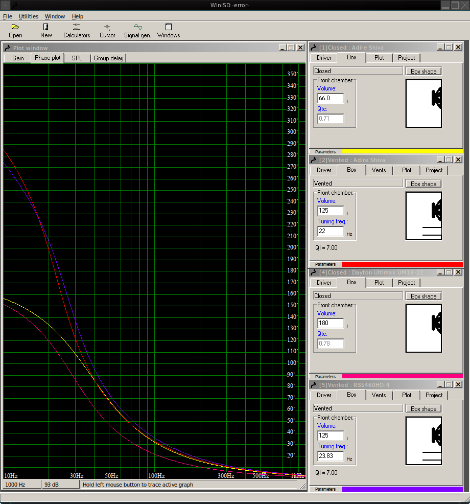

I've attached three screenshots from an old version of WinISD. Yeah it's not the greatest sim, but it includes the necessary effects here for comparison purposes. There are four combinations shown:
- Adire Shiva sealed (yellow), achieves 87dB at HF and F3=38Hz with 90 deg phase shift at that point. Small box.
- Adire Shiva ported (red), achieves 87dB at HF and F3=22Hz but 180 deg phase shift. Medium box.
- Dayton UM18-22 sealed (pink), achieves 88dB at HF and F3=26Hz, with 90 deg phase shift. Large box & expensive driver.
- Dayton RSS460HO ported (purple), achieves 93dB at HF and F3=26Hz, with 160 deg phase shift. Medium box and expensive driver, but blows the doors off everything else except in phase coherence.
The red/yellow comparison shows you can reach lower and louder with a given driver using a port, but it will cost you in group delay. Sealed boxes are not a panacea - a sealed box is never going to match a ported box with the same driver in terms of making SPL down low.
The pink/red comparison shows that you can match the low SPL of any chosen ported box using a larger and more costly sealed solution, and it will sound better because it will have about half the group delay.
The purple/pink comparison says that since you were willing to spend big on a driver, why not go back to ported and get EVEN MOAR SPL. But it will cost you group delay again.
This "X >> Y" tradeoff ratchet can continue as long as your wallet holds out: two of the UM18-22 in a 360L box will give you the same SPL and F3 as the one RSS460HO, and they will fix the group delay! And if you're willing to buy two UM18s, you can probably afford a couple of 21" in a ported box, and eventually you have to change your name to Danley.

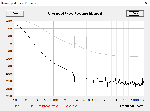

In both of your sealed plots (first pic, and grey line in second pic), there is exactly 180 degrees of phase shift between 65Hz (your F3) and HF.
In the sealed plots I showed (yellow and pink lines), there is exactly 90 degrees between the F3 (38Hz and 26Hz, respectively) and HF.

180 degrees is equal to flipping the polarity, but regardless of that phase is something to take into account at the crossover to the next driver, my vented enclosure has perhaps about 35 degrees more phase shift than the "virgin" sealed enclosure from 30-300Hz, the maximum range of this box with double 15" is intended as 27-300Hz. What happens below this frequency is for the most part uninteresting to me, based on analysis of my music collection, but I still get very nice in-room response to about 13hz for organ music when the mood strikes me.
35 degrees difference is hardly anything to write home about, just don't use a "textbook" filter because they never work that well anyway.
