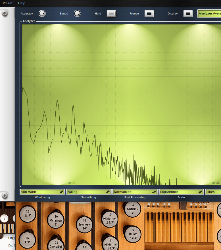

Somewhat correct but the organ is different. 32 foot flue pipes (i.e. not reeds) have very strong fundamentals. The screen shot below is the output of a low E from the 32 foot Untersatz on the Eisenbarth pipe organ disposition. The audio is actual sample recordings of the pipes. I used the E because my spectrum analyzer only shows down to 20 Hz. the last 4 semitones would have the fundamental off the display.A common error: when you hit the last key on the piano, you hear a sound folks identify as a certain note [sorry, I don't know the musical note]. Some part of that sound is 27.5 Hz (or whatever near-there the tuner felt provided the right sound along mixed with all the other partials you hear when that piano key is hit). Organ notes too. For the low notes, often the "official" Hz is present in diminishing amounts.
B.
Sorry I cut off the units on the Y axis. Each bold line is 12dB.
Wonderful to see data and your helpful comments. Thanks.Somewhat correct but the organ is different. 32 foot flue pipes (i.e. not reeds) have very strong fundamentals. The screen shot below is the output of a low E from the 32 foot Untersatz on the Eisenbarth pipe organ disposition. The audio is actual sample recordings of the pipes. I used the E because my spectrum analyzer only shows down to 20 Hz. the last 4 semitones would have the fundamental off the display.
I would only add that an organ pipe - as your plot shows - is not like a pipe in high-school science class. Even a single organ pipe has complex overtones curated by the builder in all kinds of trick ways, top to bottom and sides. And as a musical instrument, keys and I suppose even pedals, have other pipes added all the time.
Just to circle back to speaker acoustics, in a church or in a room at home, big variations in how the organ sounds at different seats. As much as I love watching the console (when possible), the sound half-way back suits me better. Toronto is blessed with some excellent organs, baroque and modern.
And just to circle back to psycho-acoutics, the picture of frequencies in the low bass is far from what you hear due to Fletcher-Munson that everybody on this forum certainly knows all about. Unless the lowest notes are far, far louder in the plot than the middle notes, you hear mostly the middle notes (and your brain invents the virtual fundamental).
Ben,Unless the lowest notes are far, far louder in the plot than the middle notes, you hear mostly the middle notes (and your brain invents the virtual fundamental).
As written, that is not exactly true- each note contains harmonics at multiples of the fundamental frequency that can be heard whether or not the fundamental is reproduced, exceptions being synthesized notes created with no, or very reduced harmonics.
