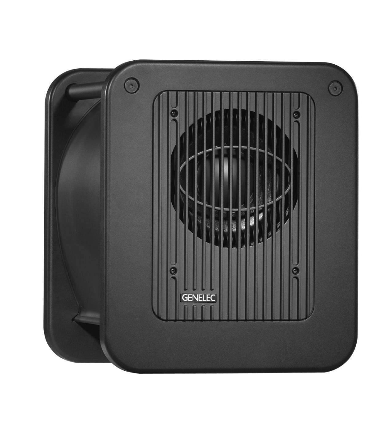

Resembles the Genelec 7050B in one of our production suites. They used a rolled aluminum enclosure. The flared, floor-firing port is just visible on the left.

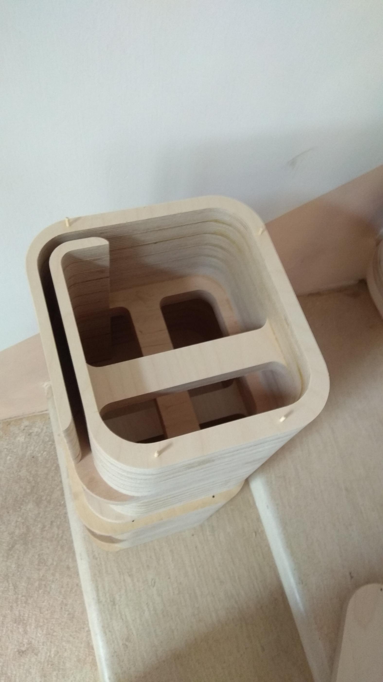

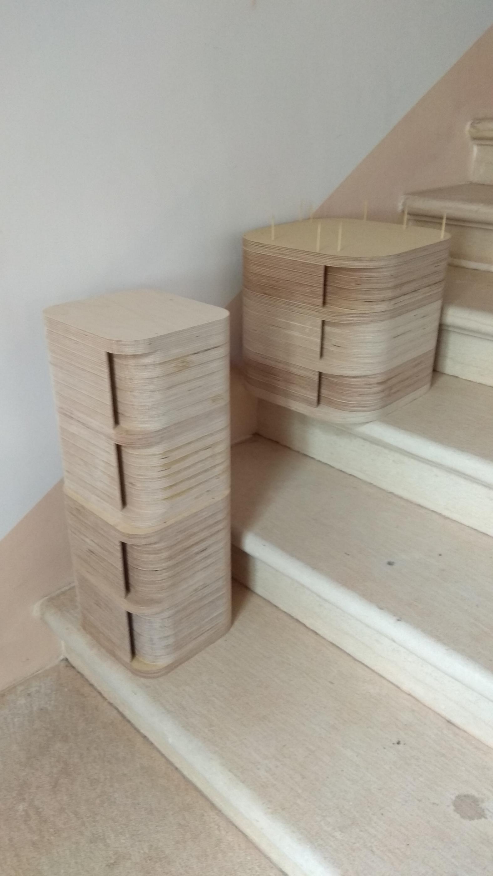

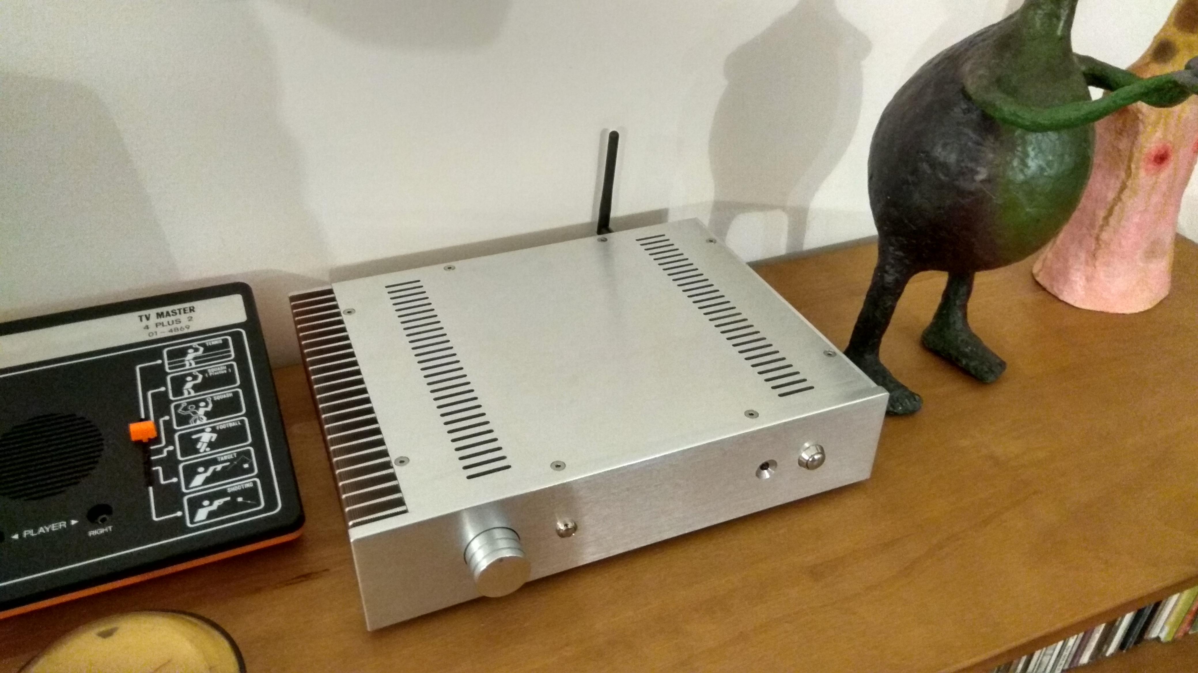

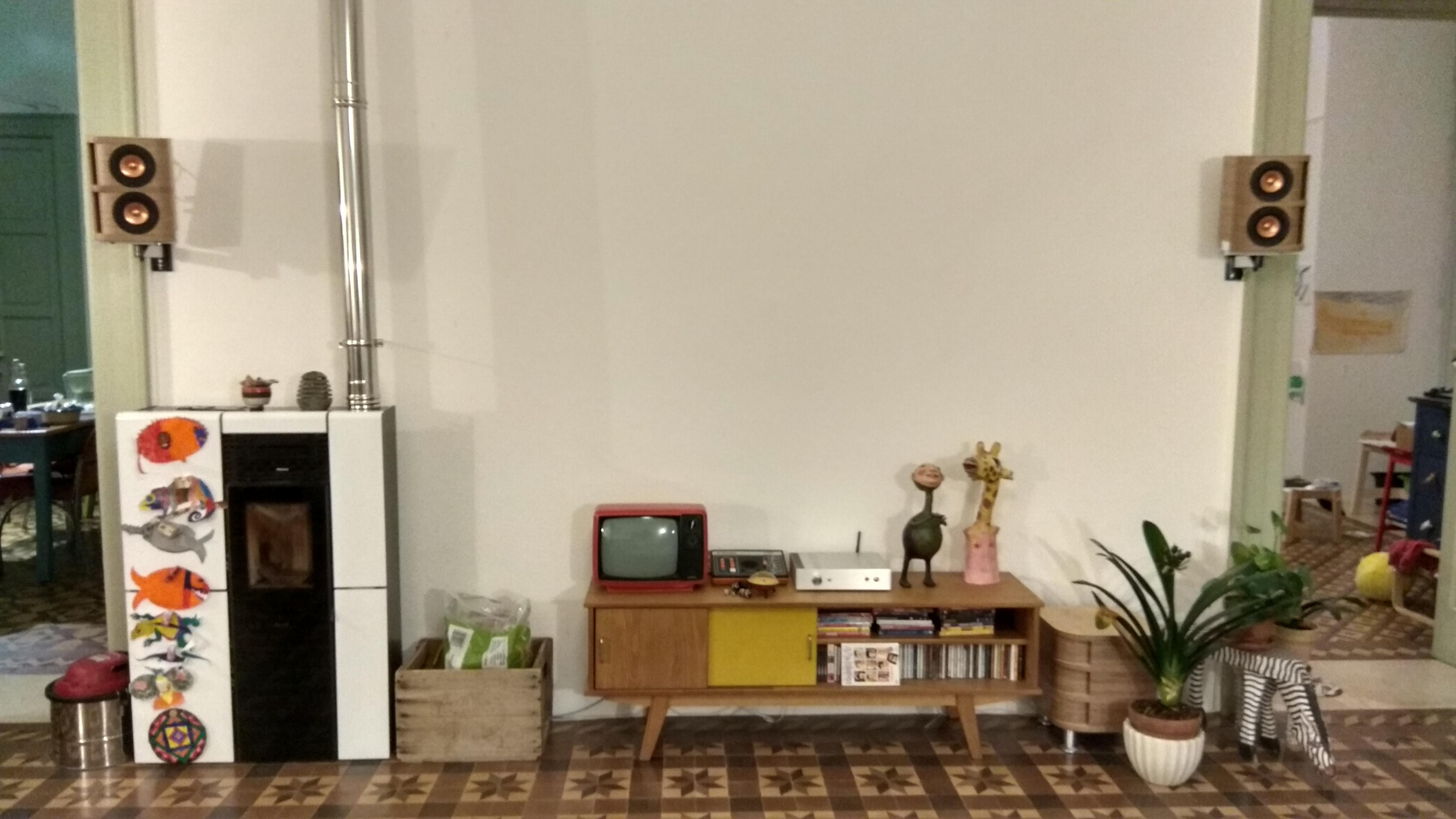

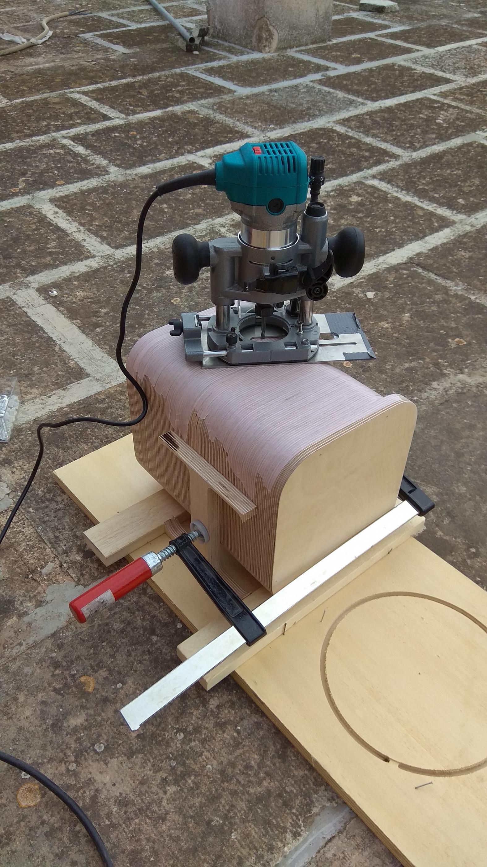

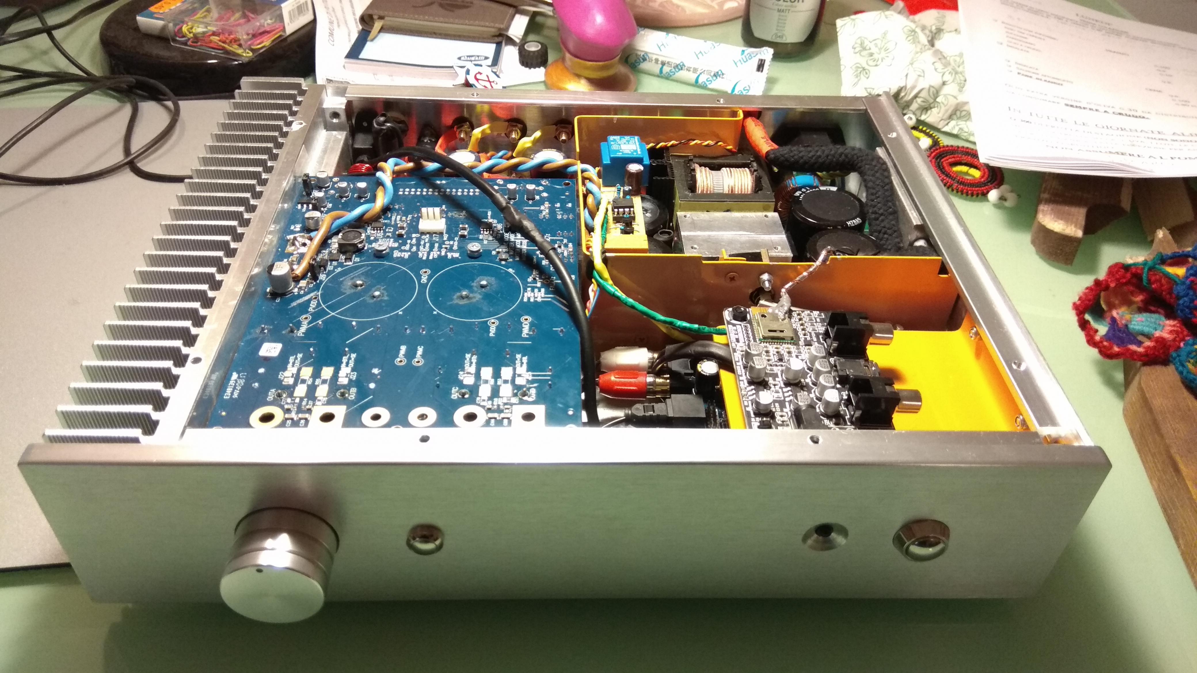

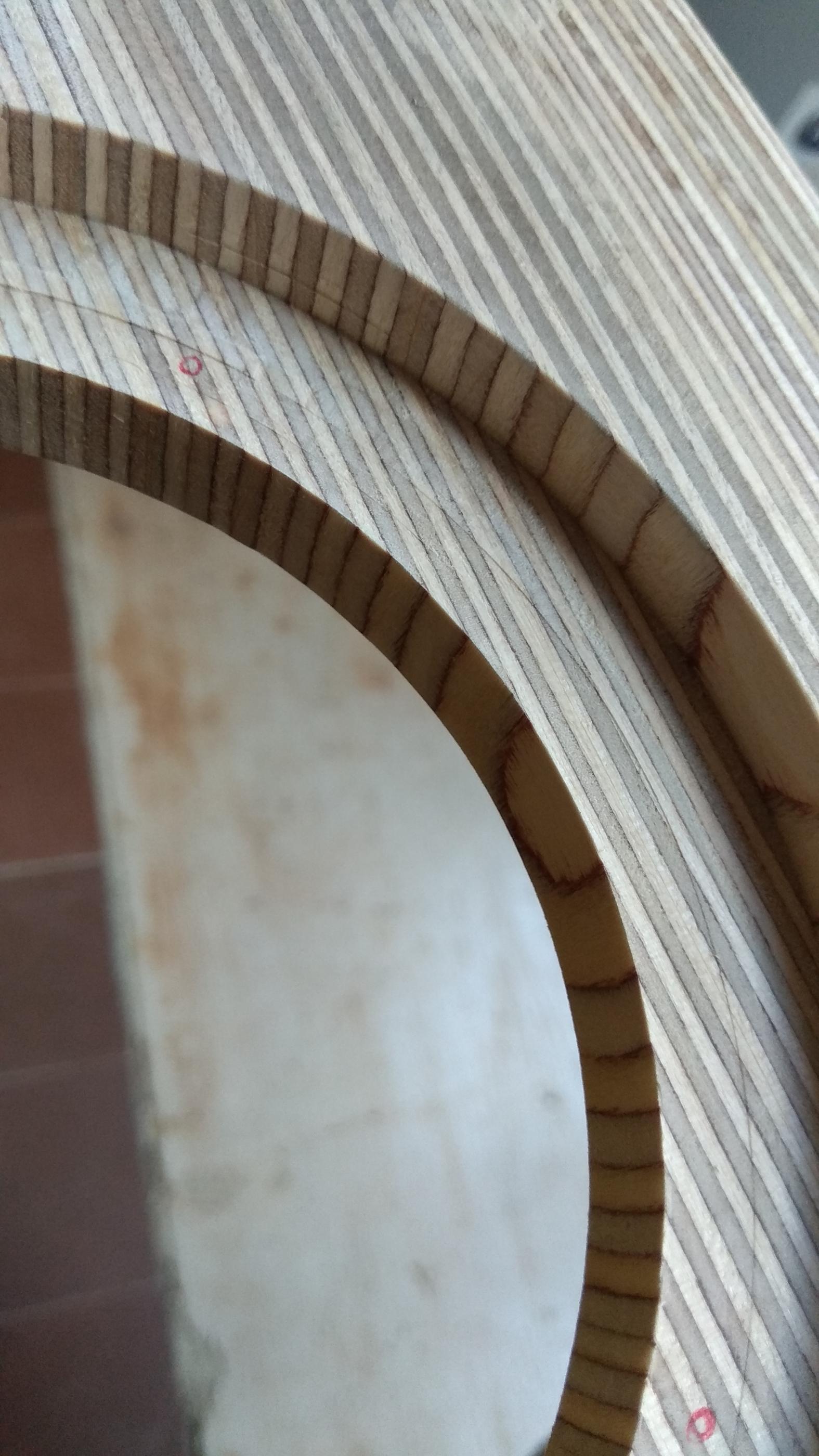

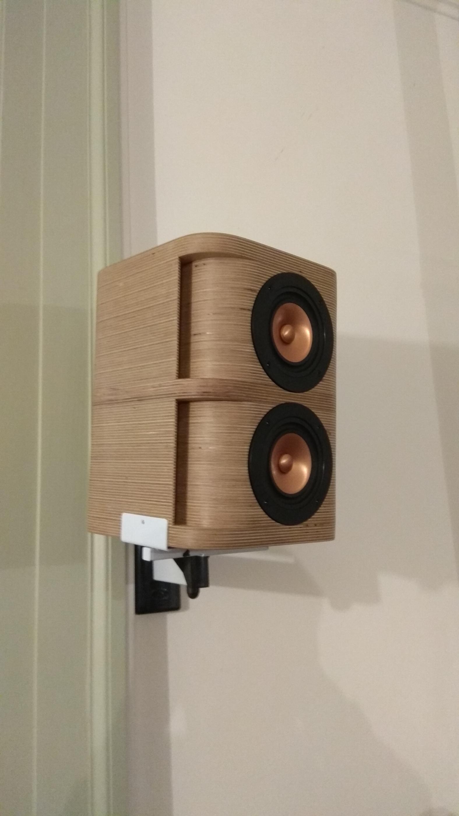

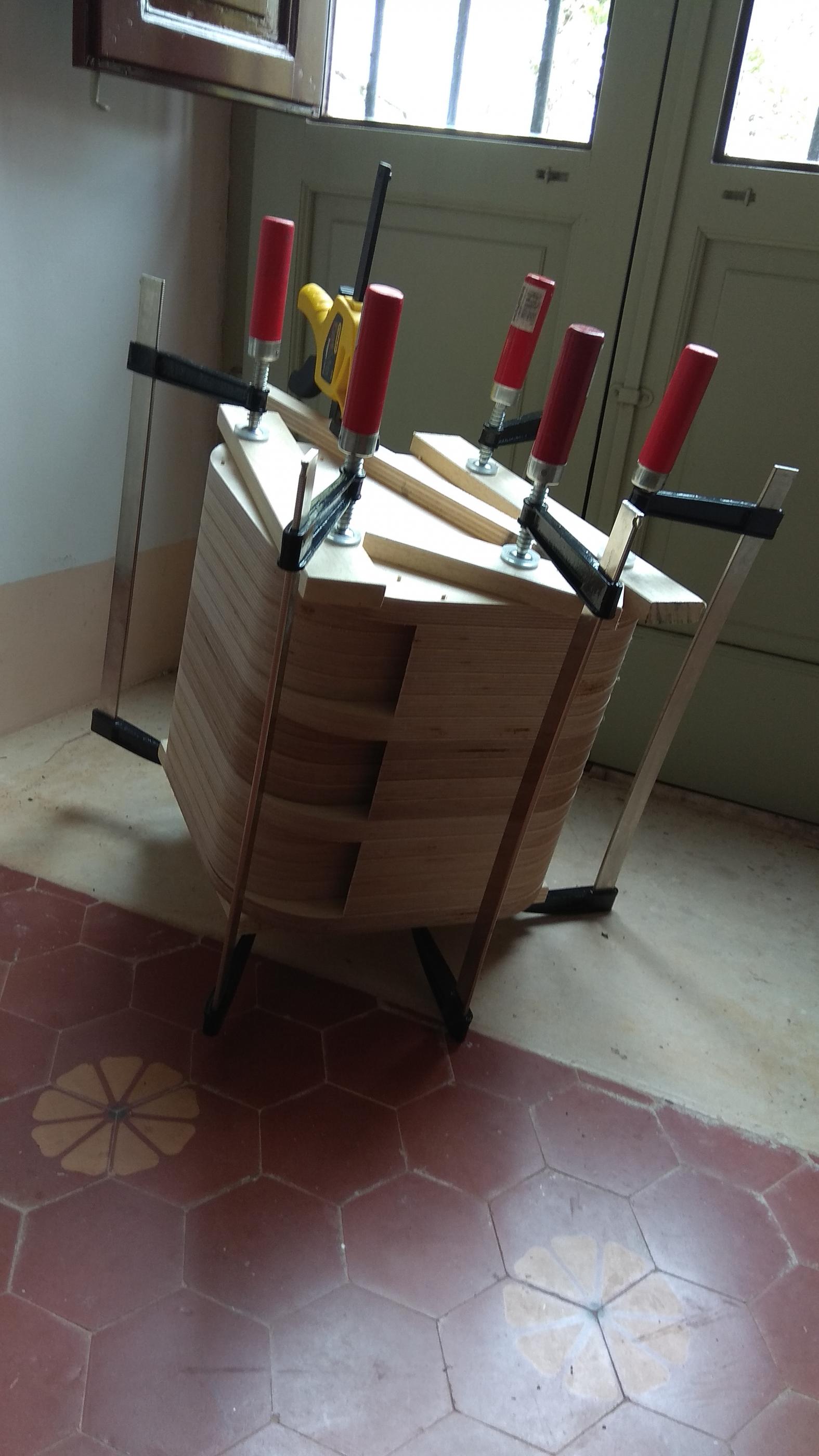

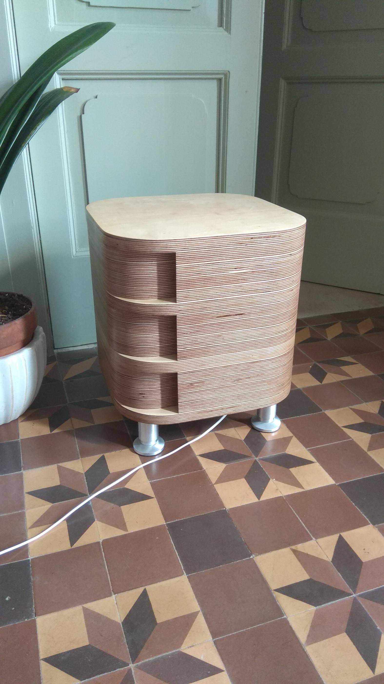

ok so i just thought id write a quick follow up, now the project is finished and providing my daily sounds.
it was a mammoth undertaking, and grew from a single subwoofer to a full on dual sub, dual fullrange system with a 6 channel minidsp powered amp. it took over a year to complete.
massive thanks to everyone who helped me, and apologies to anyone i bugged too much. i learned a MASSIVE amount about everything from woodworking, to circuit simulation, to heatpipe use.
there are about 2 dozen threads ive started over the last year covering every aspect of the project, so i wont link them all here.. instead ill just post some (bad) photos:

given the awful acoustics of my room, i have to say, after a round of eq with the minidsp and umik mike, it sounds pretty damn good. i had to boost the roll off on the top end, and kill some peaks in the bass, and now its relatively flat from 28 hz up to 20k..
