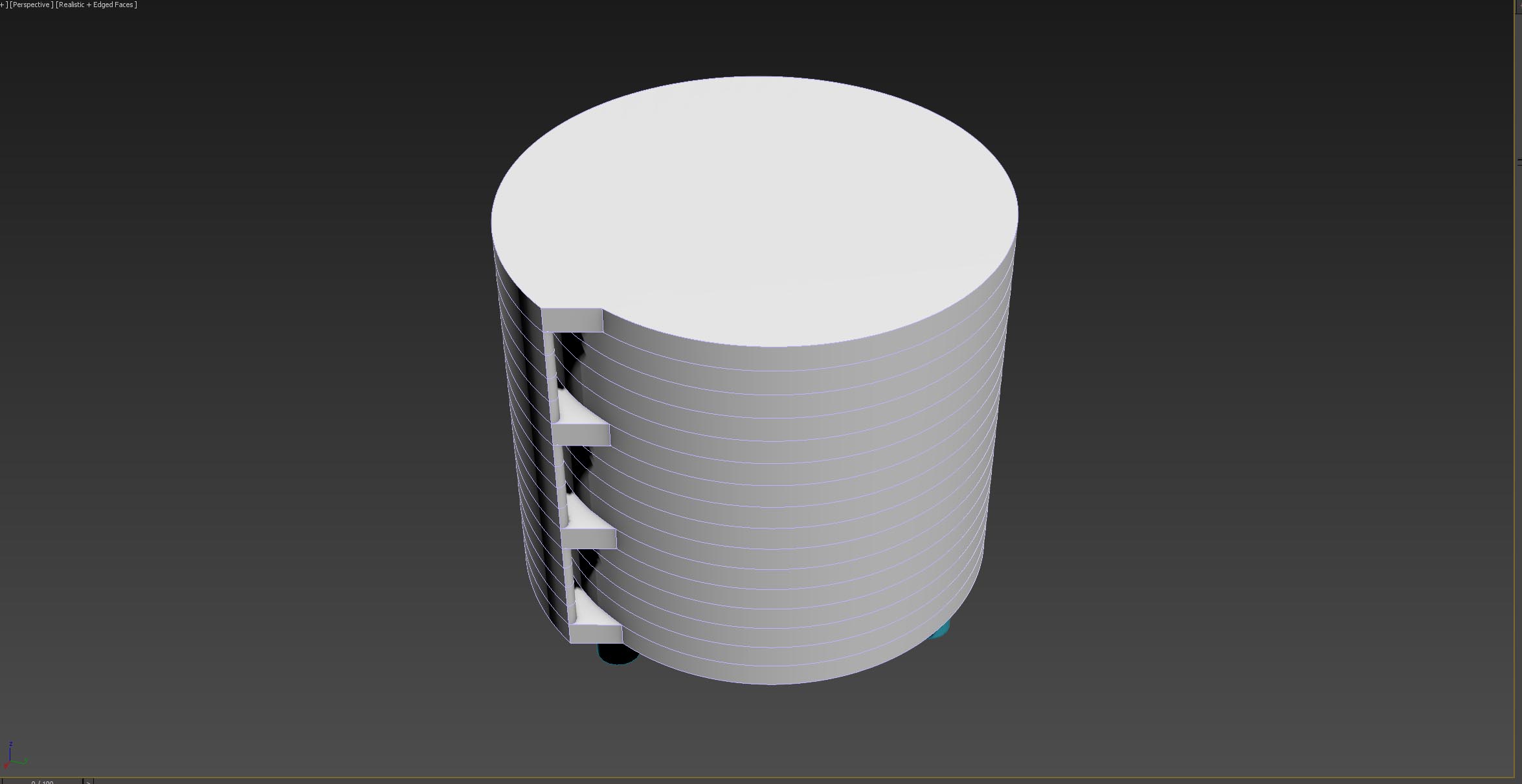

Resembles the Genelec 7050B in one of our production suites. They used a rolled aluminum enclosure. The flared, floor-firing port is just visible on the left.
