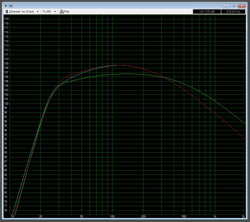

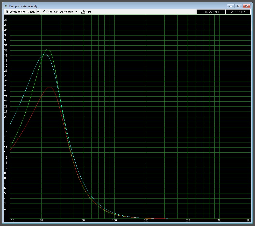

ok so a redesign to accommodate the larger speakers i received.
i had to increase the internal volume *and* widen the ports to keep velocity down.
end result is it looks a bit tubby now. its actually only 2 litres more internal volume, but it looks much bigger.
quite annoying!
anyway, attached are an spl graph at equal power input (green is 8 inch, red line is 10 inch, blue line is 10 inch in old 8 inch enclosure.) a port velocity graph, and a quick screengrab.
both graphs are shown without lowpass filters. obviously with lowpass the 10 can go much louder than the 8, but not in the old cabinet, vent velocity gets very high

im definitely keeping the 10's. from my simulations the difference even in the same cabinet as the 8's is minimal. bit more spl, couple of hz higher f3/6/10
ive spoken to my cnc guy, who says its no problem swapping over to 22mm plywood, which will make the thing a bit taller, and gain a couple of litres in volume.
-unfortunately if i increase the width, it goes from a 2 sheet job to a two and a little bit sheet job.. and that wood aint cheap.
so im probably going to compromise somewhat on ideal cabinet dimensions.. but like i said, differences in performance are not large, and the 10 inch driver has a ton of headroom (double the power handling, larger area, more xmax) , so i can eq them a bit to make up any deficit.
the vent velocity gets a touch high (30m/s at xmax) , bit as i understand from david/planet10's comments, the actual vent velocity in such a restrictive vent will be lower than the simulations suggest. also, i am literally never gonna run these things flat out..

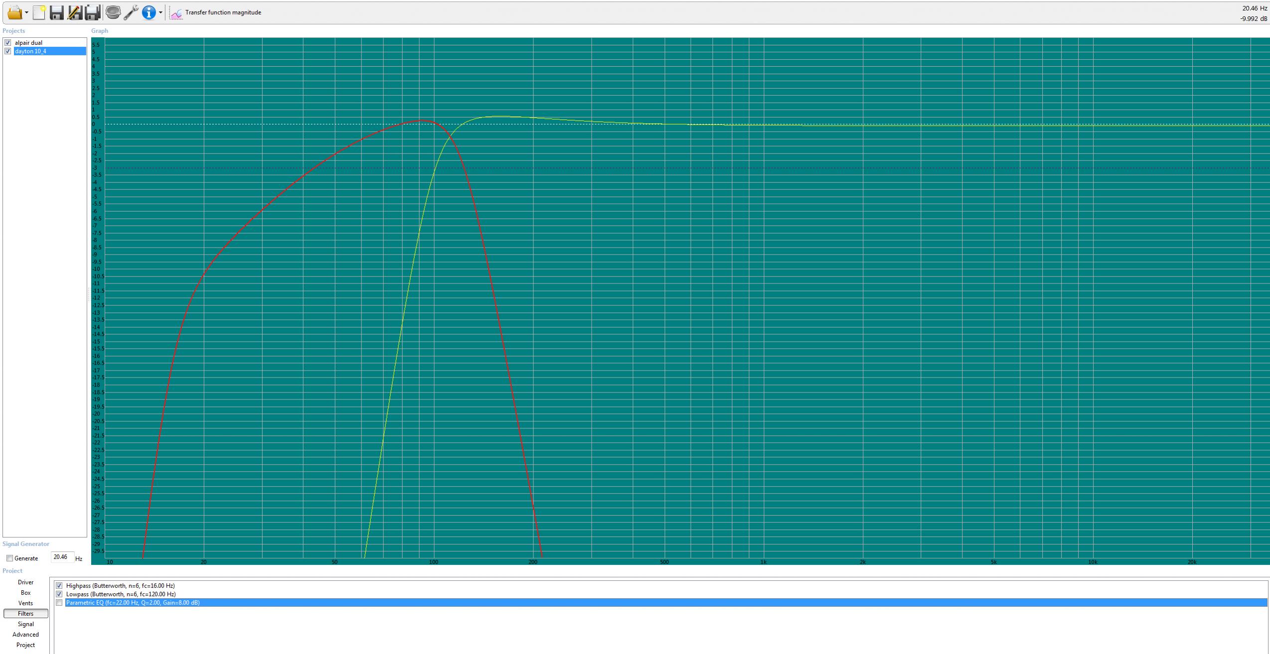

it has been pointed out to me, that the sub i have will exceed the maximum potential of the dual alpair 7 cabinets ive chosen with only circa 150w of input.
my simulations approximately correlate with this.. at xmax the mains ( 2 alpairs in a box) will hit about 105db
with 150w input, one of my subs will do about the same..
this obviously leaves a lot on the table with my sub drivers.
ive been playing around tuning them lower, then eq'ing them up to get more extension with the headroom i have.
with a 20 litre cabinet, and port tuned to 20 hz instead of the circa 28-30 i was considering before, i can keep within xmax with a 10db boost at 20 hz, while matching the spl of alpairs.
this drops my f3 point to 20 hz or so.
id note ive been told that
a) spl/power etc are not relevant
b) f3 is meaningless
c) a nice gentle slope off in bass response is desireable.
id also note that
a) music generally doesnt contain 20hz content, but movies sometimes do
however, with heavy duty subs, and relatively small high ends.
is it a reasonable idea to tune the subs lower, to eq and take advantage of the extra excursion and power handling available?
attached are 2 screengrabs
one is the alpairs (dual) and the sub, tuned to 20 hz, with alpairs at xmax, and subs adjusted to similar level.
-note ive put a lowpass on the sub at 120 hz, and a higpass on the alpairs at 100 hz.
the other is the same setup with a 10 db boost at 20 hz. just within xmax
- id say the slope of the non-eq'ed sub looks quite good if i get big room gain.
-eq'ed one shows eq headroom possible within xmax if i have gaps in response.
one thing i also note.. amplifier apparent load in eq'ed scenario peaks at 765 VA
im not sure quite how this would relate to the amplifier rating in watts i would need to achieve such eq..

Make it variable. You can tune the loading of the woofer by the proximity of the floor.
dave
Can you expand on this? I'm trying to make a sub that fits under a couch and I was thinking of using 1" legs. How does the floor loading affect the woofer's parameters? Is it like extra added mass? If yes, do you know how to approximate it before actually building the box?
I never like to see a sim where the derivative of the FR crosses zero more than once — ehich the 2nd does, i’d pick the 1st one. Don’t forget room gain.
