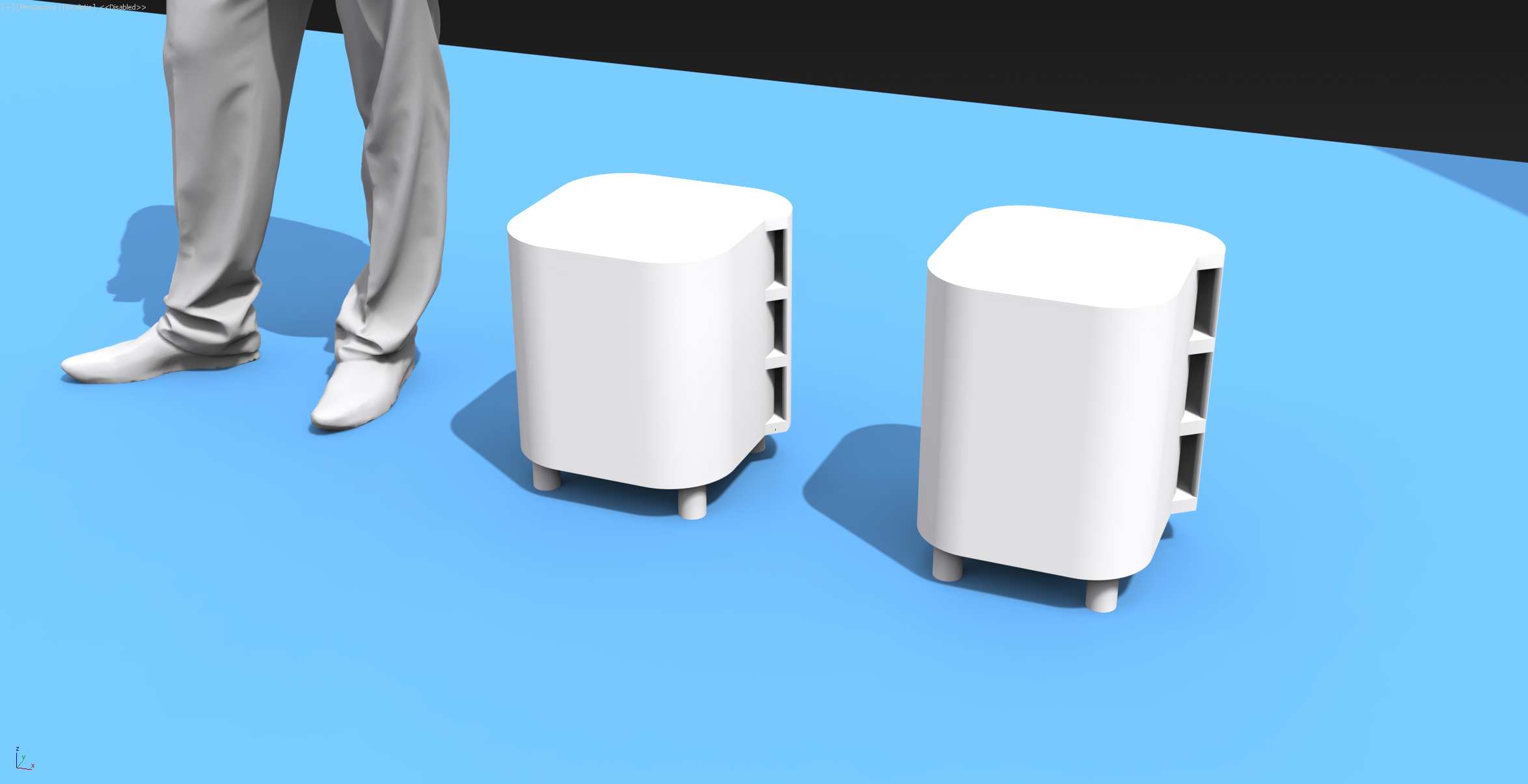

out of interest i modelled a box version with standard construction techniques and 18mm mdf.
considering the box form is more space efficient ( for stacking maybe)
its impressive how much bigger it looks that the other two, with the cylinder appearing the smallest. if you overlay them you can see the box is smaller along its 90 degree axes than the cylinder, but the corners fill visual space much more.
Prefer the radius squared one.

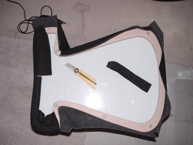

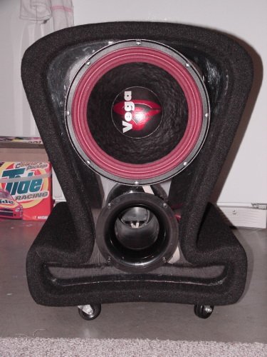

This design brings back alot of memories! I started about 13 years ago making multi-layered horns out of 3/4" MDF, never going back to using that material again! I highly recommend using Baltic Birch (13-ply).

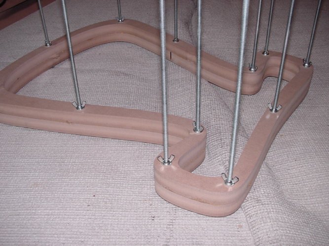

My first ever multi-layered sub I built back in 2001, external source for CNC work & using 1/4-20 threaded rods. I prefer using dowel rods & Harbor Freight clamps.

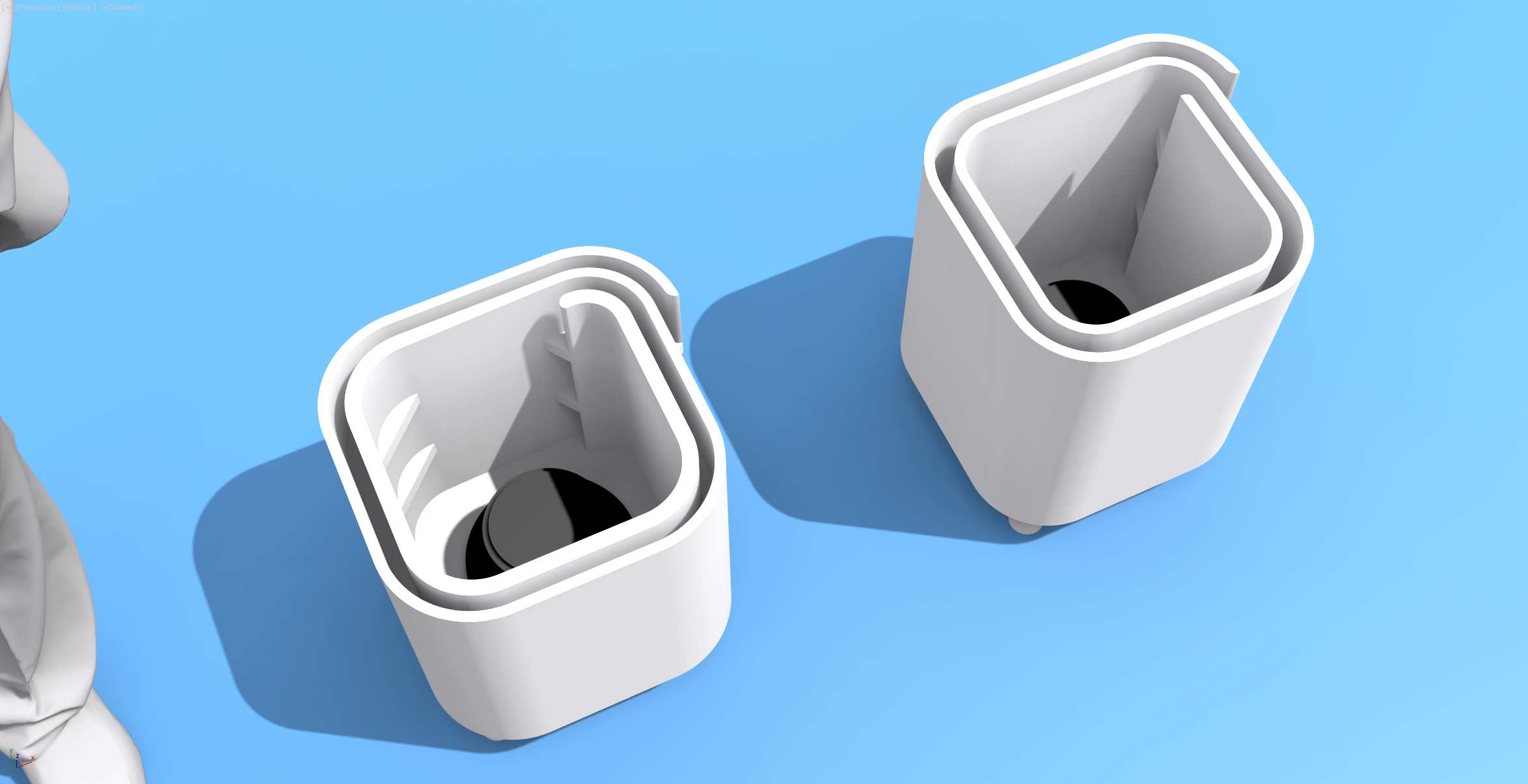

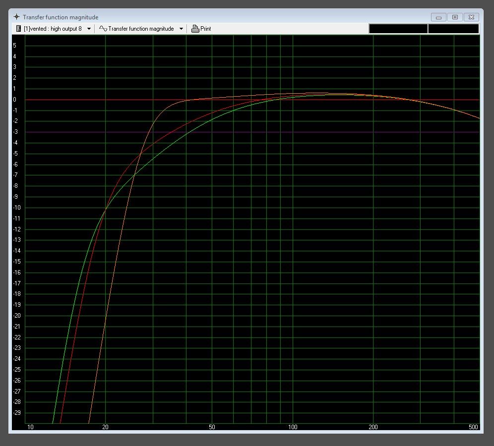

ok so ignoring that wierd website, and following the winisd guidance, here is the latest iteration.. its 17.4 litres internal, with 1.5x9cm slot ports, 1.2m long.
box is tuned to 23.5 hz.
The shorter one on the left is the new one.. its mainly shorter because ive switched to a realistic 18mm material thickness rather than the 20mm previously.
ive also increased the inner wall thickness to `15mm, and added some corner bracing.
the rounded rectangle design was chosen because a) i like it and b) it allows for longer grain lengths in the plywood, hence more rigidity (i think?)
ive also attached the response curve, orange is my original, green was the suggestion by Planet, and the red is my new one which tries to keep cabinet size and port velocity down whilst approaching Planet's advised response curve.
