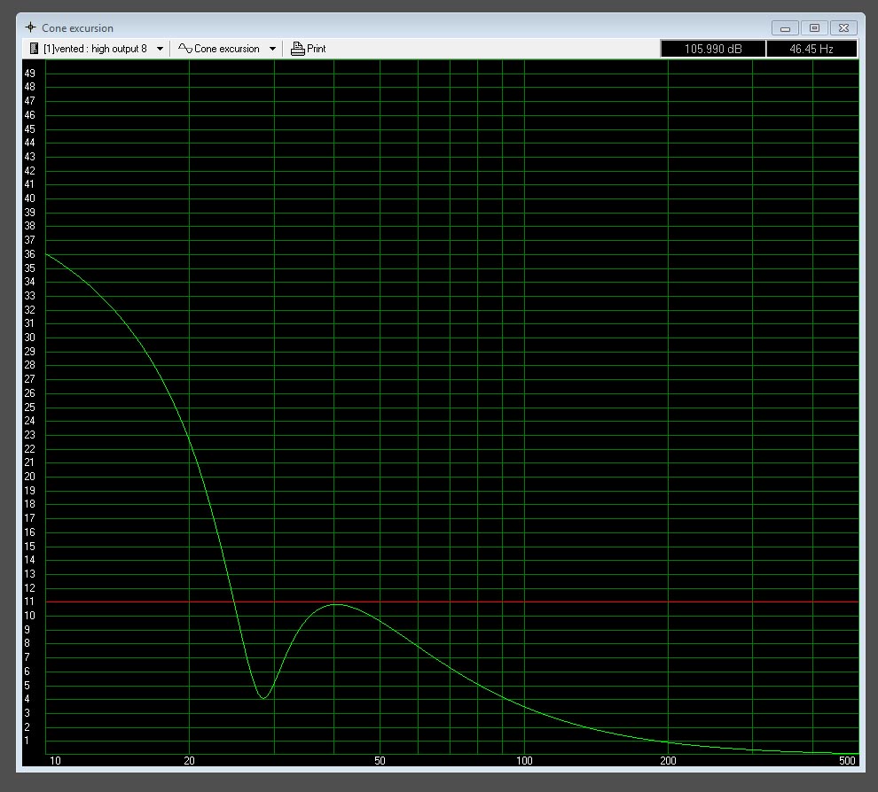

ha.. the xmax graph without the filter goes through the roof under 25 hz. with 250 watts it arrives at 40+mm excursion
to keep it within xmax i can only feed 25 watts to the driver.

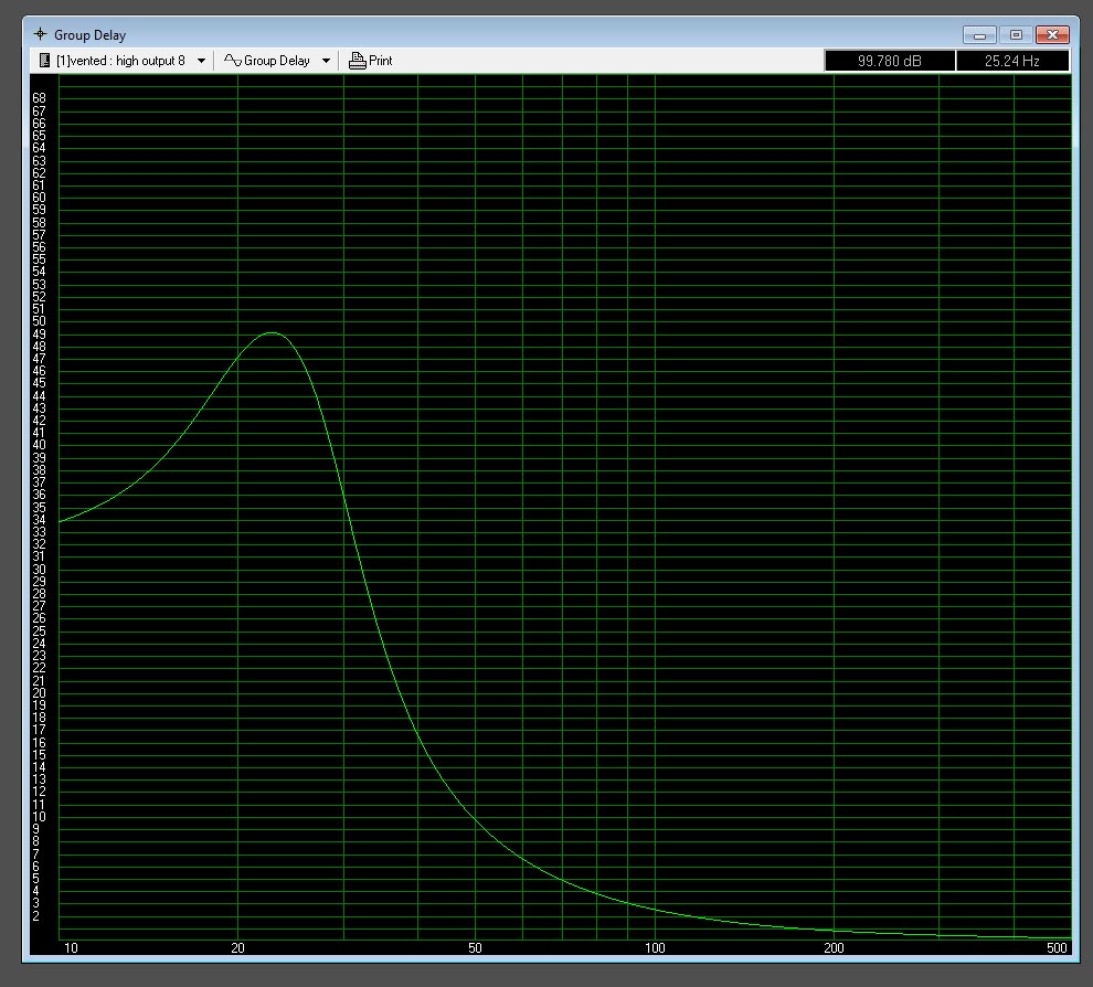

anyway as noted in my edit to the previous post. i think a small adjustment to the filter and recognising the purpose of my design (its never gonna run at full whack i think) it should be ok.

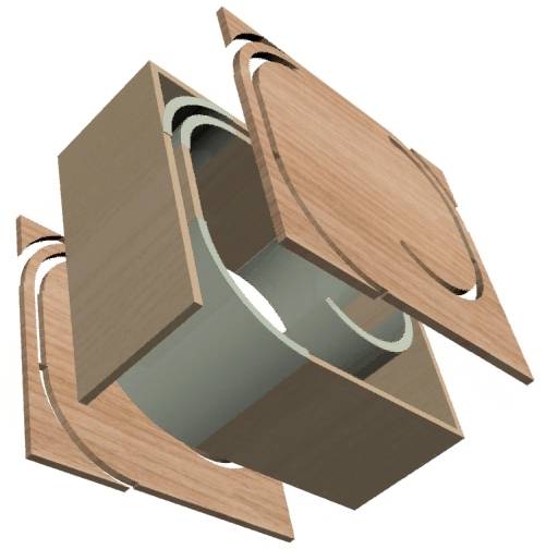

ive not tried modelling with a thicker wall on the inner surfaces.. it would require either shrinking the internal volume ( making vent shorter, would not complete a full rotation of the box -structural weakness)
or moving the vent outwards to retain the internal volume, which would make the vent longer, requiring a narrower vent.
or do either of those and change the height of the box to compensate, although then i have to change vent height and im limited by material thickness.
-which i have not decided on, depends what is available.
neither of them a deal breaker obviously, but do you not think the 1cm thick *double layer* walls with 2cm x 6cm bracing rings every 10 cm would be quite rigid? i cant imagine a 1cm thickness flexing much over 10cm..?
id obviously choose the densest plywood i could afford..

As a translam those rings are not nearly as effective as braces. The double wall can be very effective (our full-on miniOnken boxes demonstrate this)
DEnsity is unimportant. Stiffness is. And since you are not using the ply in the direction its stiffness is most apparent strength. Extra mass without a gain in stiffness is going backwards.

I’d actually look at using this in a 17 litre sealed box. Looks to match room gain pretty well. A sealed box is more capable of handling EQ.
Played a bit with a vented box. The same 17 litre tuned to 20 Hz looks good. But the 3 of 2x8 cm vents would need to be 2072 mm long. Reducing those to 1x7 3 off reduces vent length to 894mm althou that is below the recommended minimum vent size — i don’t see that as an issue with such high resistance vents.
dave
ive tried a sealed box,
to try to match the spl around 30-40 hz with eq or a linkwitz transform drives the excursion to the moon.
however, im obviously missing something.. you said "looks to match room gain pretty well"
could you explain what this means? i thought the flattest response to the lowest frequency was the ideal..
your two suggestions provide smoother falloff, but hit f3 at 41 and 52 hz.. mine hits f3 at 29 hz.
obviously you know something (many things?) i do not about desireable response curves!
