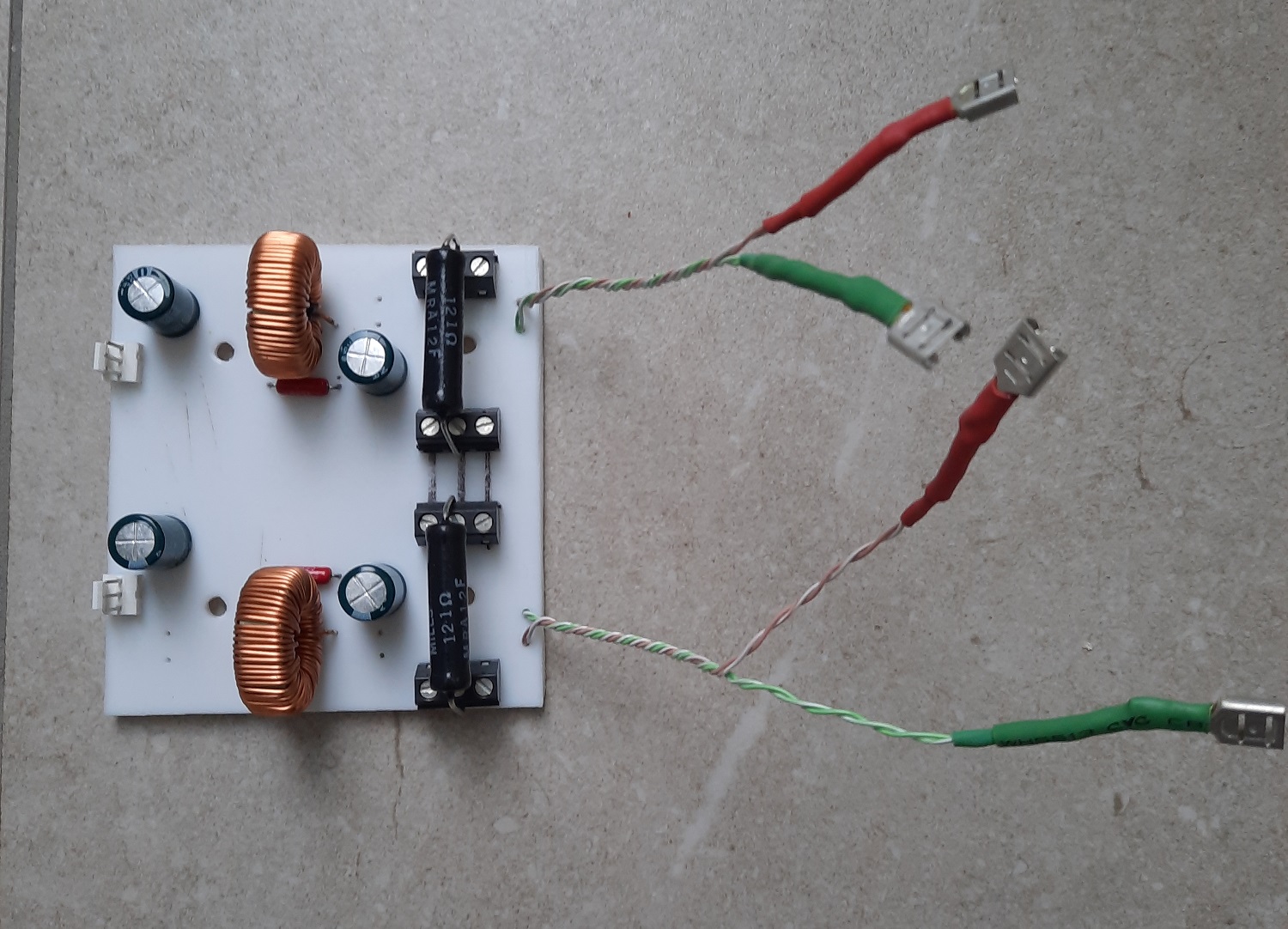

Very interesting ... I switched the amp back on - with my CRO attached to the +ve DC rail of one of the SLBs.
Spiky ripple ... which went smooth as soon as I pulled that fan connector apart! 😱
So, yes, the fan is feeding crap back into the +ve DC rail.
So I will build your CLC filter onto the end of the DC supply to my fans.
For each: 2x 220uF/25v caps plus a 220uH inductor, with a 54.9 ohm res in parallel - sound OK?

Yes, give it a try. Maybe (optional) bypass the second cap with Wima MKS 2.2uF film cap.

Will do - but would there be any value (in terms of the end result) in increasing the value of the caps ... from 220uF, to say 680uF?

Sure, it will bring the corner frequency lower and farther away from the switch mode frequency so the attenuation is greater. I actually use 1mH ferrite core radial inductors because I happen to have them and 1000uF caps.

I'll use 680uF caps but will stick with the 220uH inductors, due to space limitations in my cases. 🙁

Well, happy to report the CLC filter does remove the spikes that the fans were feeding back into each +ve DC rail. So the ripple on the +ve DC rails is now nice and smooth.
And this is without adding that Wima bypass cap you suggested (I forgot it, when I was building the filtered fan PS 😱 ).
Pic attached.

Great work Andy! What are those beefy 120ohm resistors for? To slow the fans to make the fans even quieter?
Sort of, X. The +DC rails are ~21v; those 12w Mills reses reduce this to about 11v for the 12v fans. Then the auxiliary Noctua cable reduces this even further.
I should've probably just soldered the reses in place, with this rebuild of the fan power supply (instead of re-using the Phoenix connectors) ... but I guess I can do some experimentation with slightly larger-value reses, to see if I can get the fans quieter - without the mosfets getting too hot.
Andy
Incidentally, X - can you tell me what having the ~50 ohm res in parallel with the inductor does ... compared to not having it?

It absorbs potential oscillations in the CLC “oscillator” circuit. 🙂
