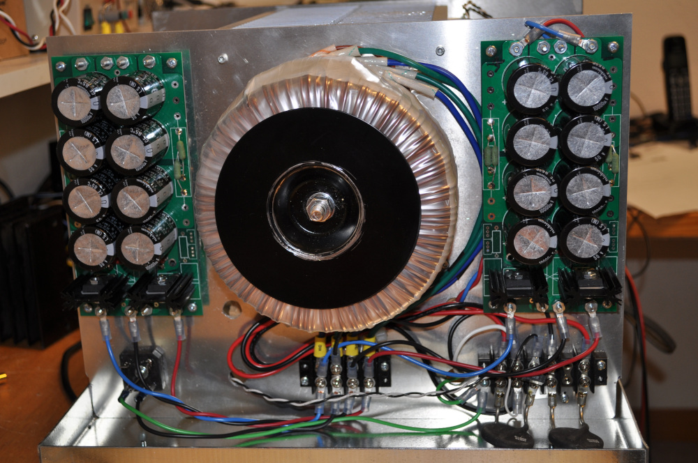

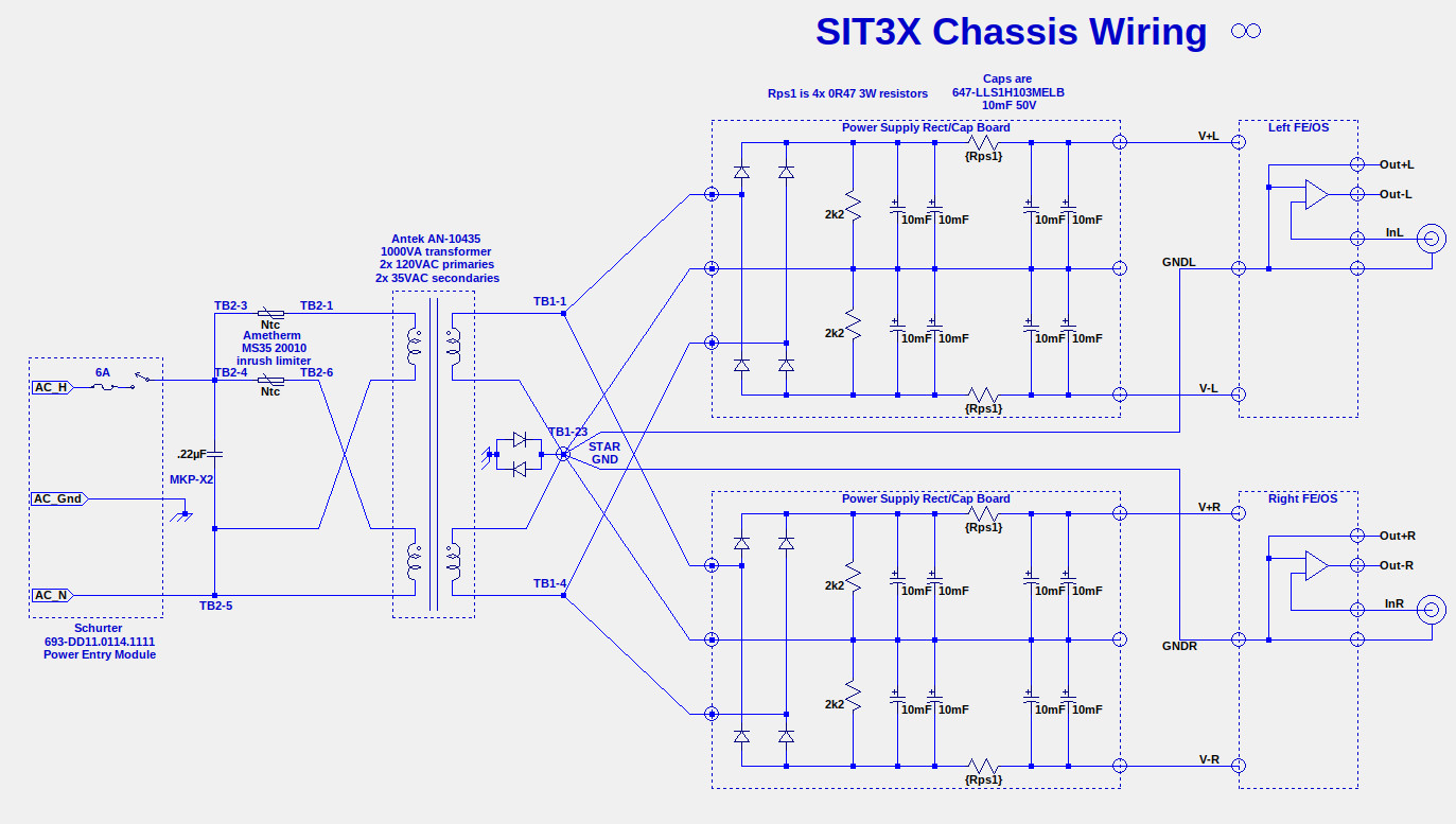

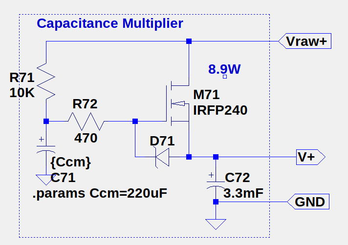

I did some power supply related measurements today. The basic power supply for the SIT3X is show in the first image below. The V+ and V- rails measure +/-45V DC with 44mV RMS ripple.

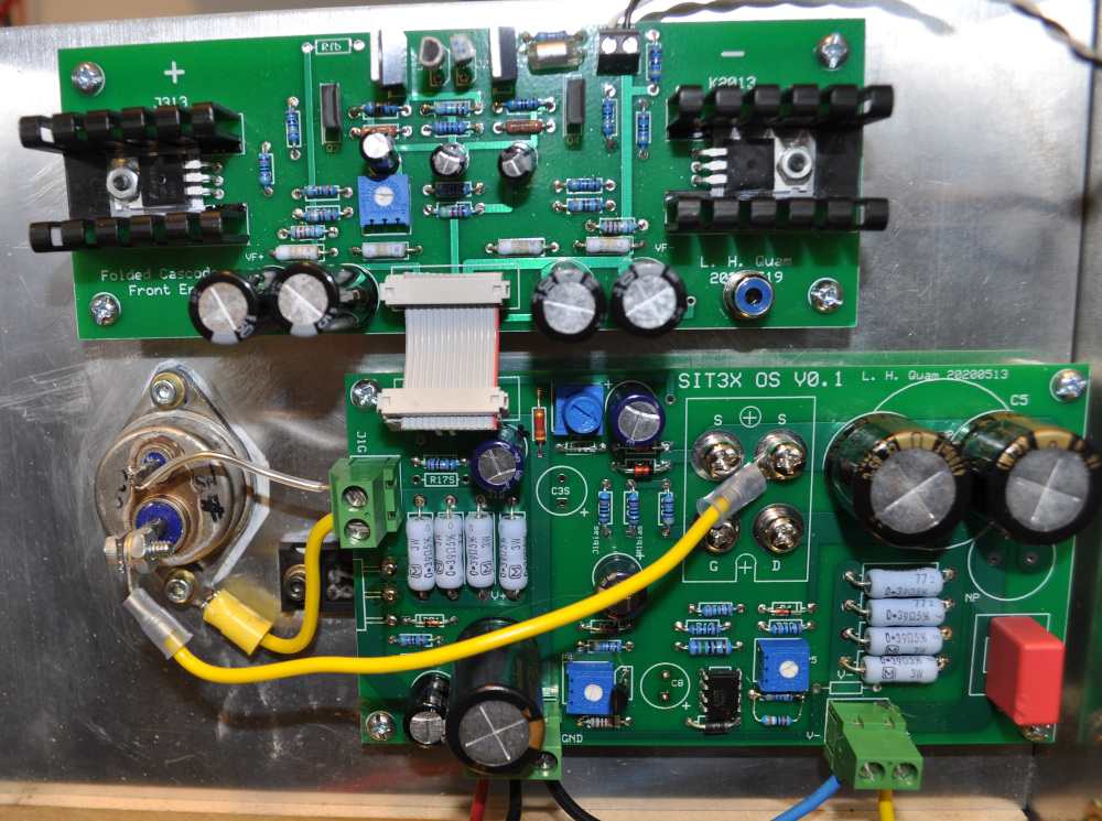

The capacitance multiplier on the OS PCB is shown in the second image. The filtered output measures somewhere between 100uV and 300uV RMS noise, basically below the measurement limits of my Fluke multimeter.

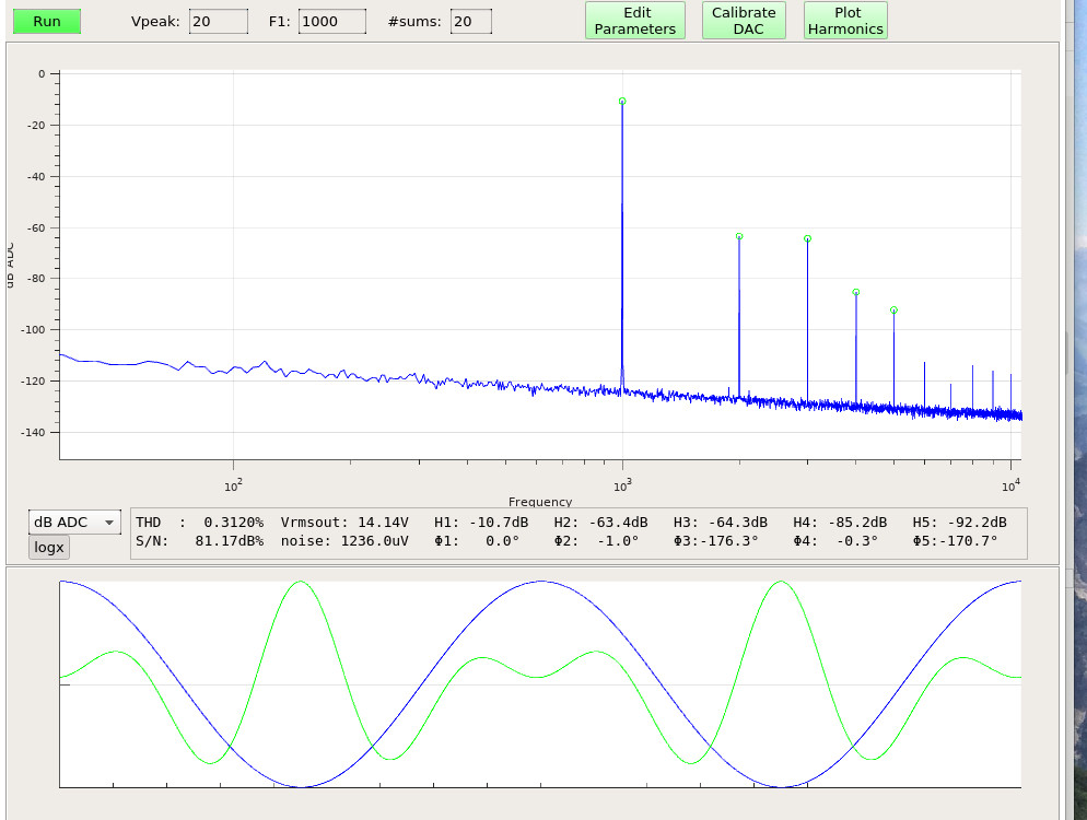

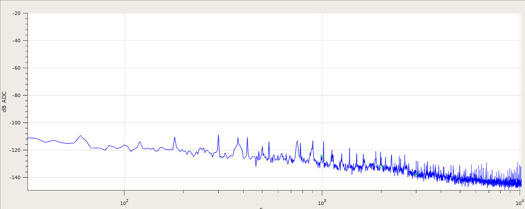

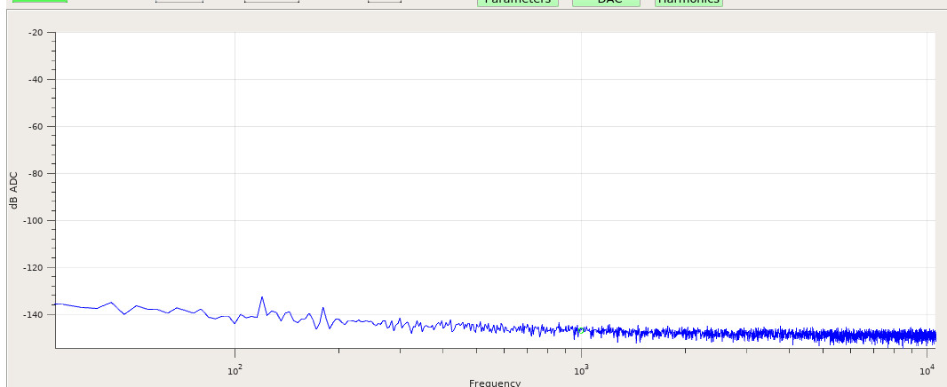

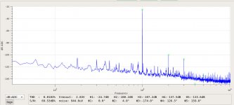

Here are some spectral measurements of the SIT3X speaker terminals with an 8R load.
  1. The first image is spectrum of the output with the OS stage only, ie. the FCFE ribbon cable jumper has been removed. I measured 0.1mV RMS noise across the speaker terminals.
  2. The second image is the spectrum of output with both the FCFE and the OS stages and 0V input. I measured 0.4mV RMS noise across the speaker terminals.

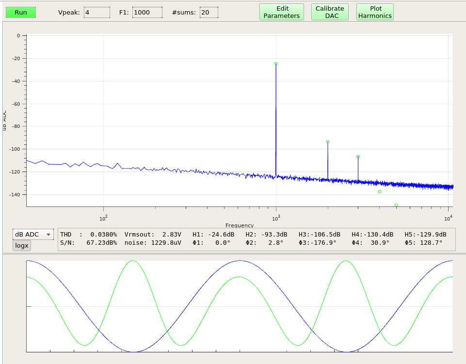

  3. The third image shows the spectrum for 1kHz, 1Watt into 8R.

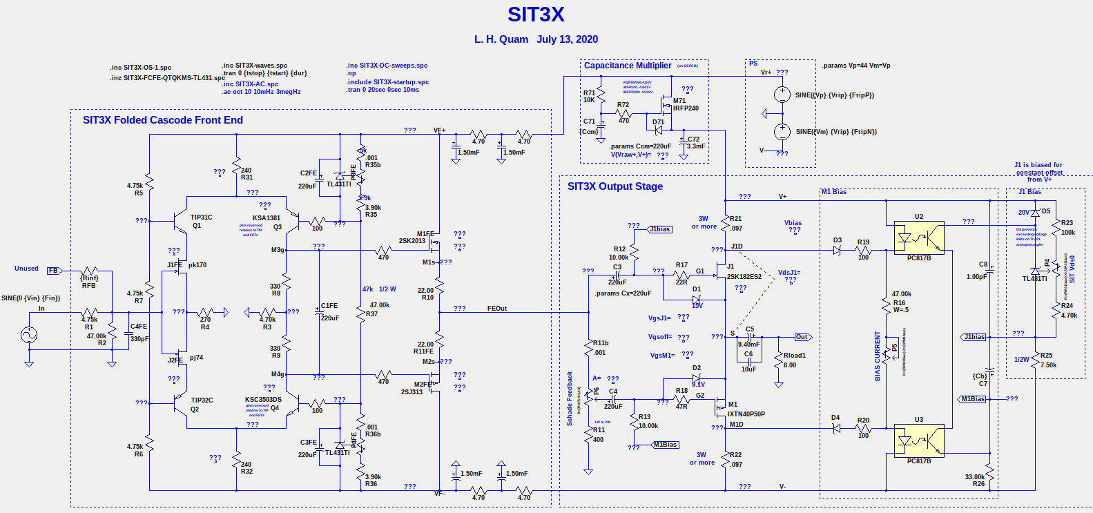

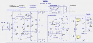

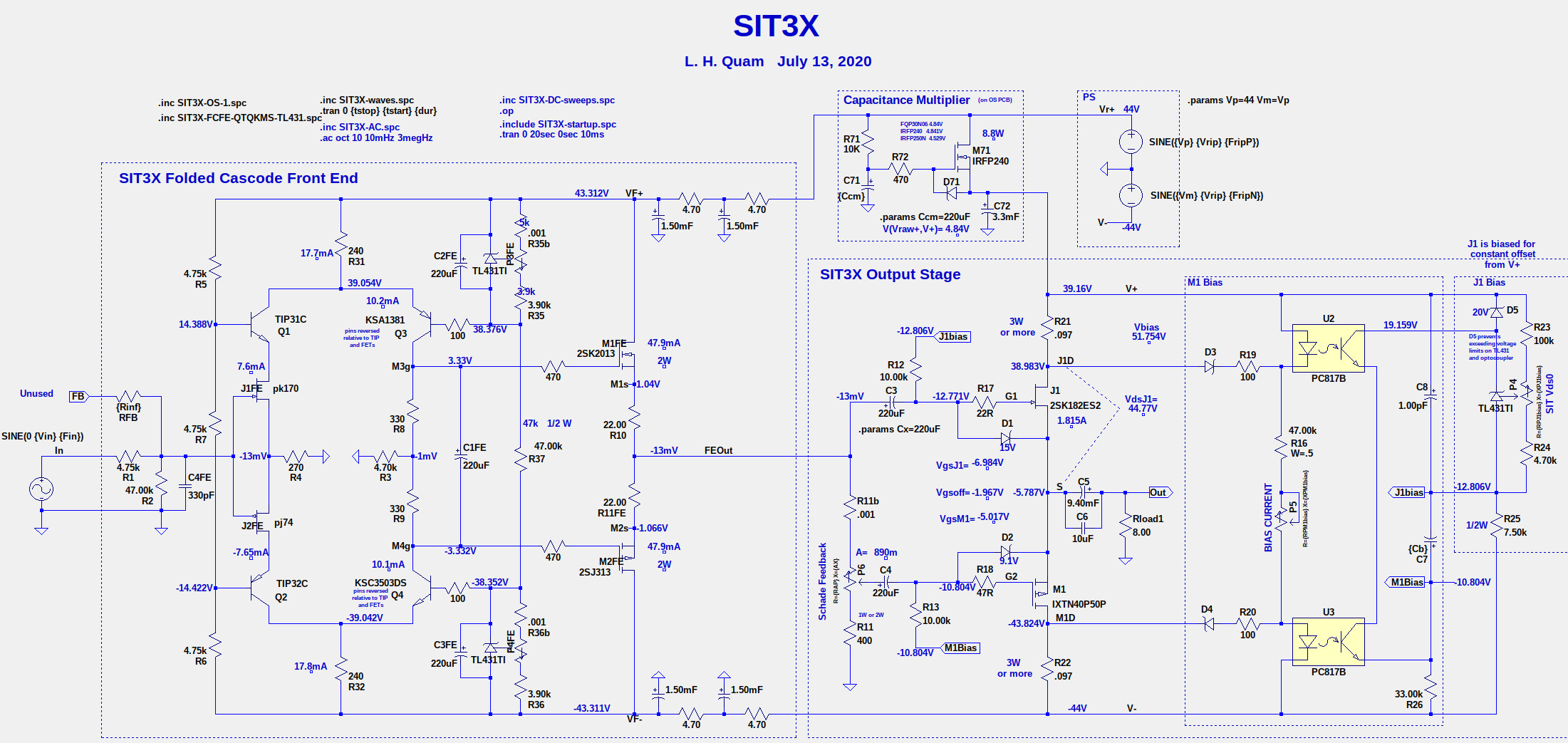

Finally, after fixing PCB layout errors, circuit modifications, and changes to FETs and resistor valuse, I have good results with the SIT3X build. The circuit measurements agree quite well with my simulations. I find that the "distortion-cancellation" (actually Schade feedback) pot has a significant influence on the distortion spectrum, H2, H3 and higher. Below is a schematic for the current state of the FE and OS circuits.
Is is important to understand that this circuit has no feedback in the FE and no global feedback. The OS contains a adjustable Schade (local) feedback on the PFET connected to the negative rail.

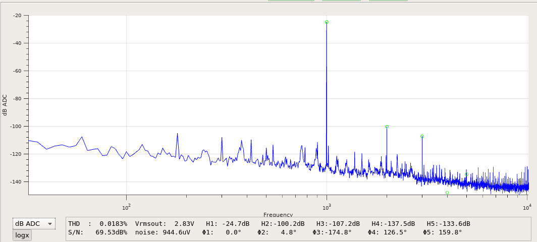

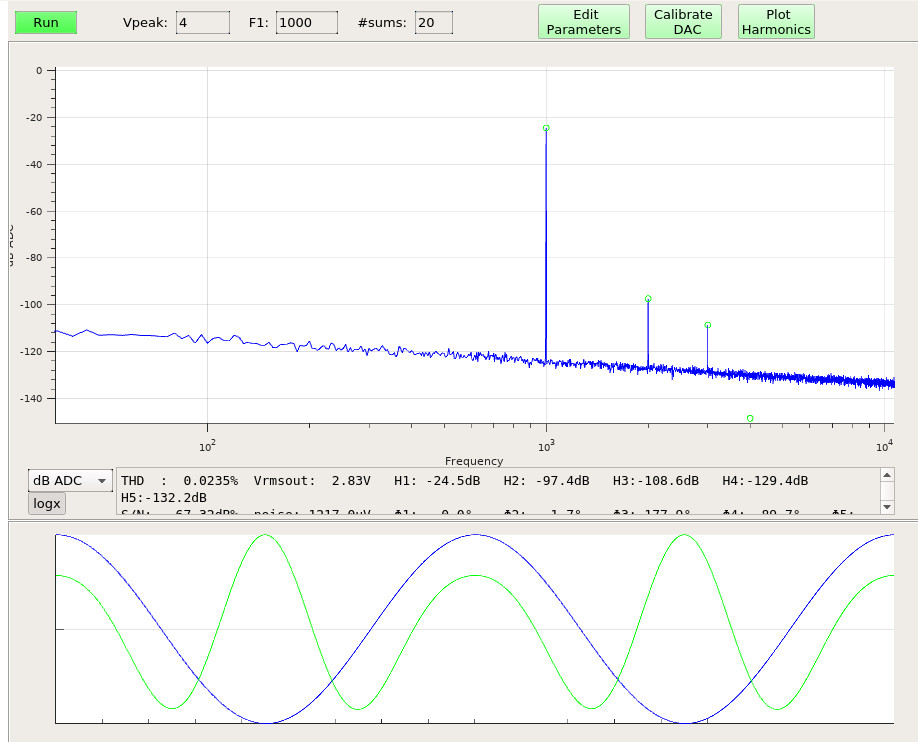

Here are distortion spectra and residual waveforms:
  • 1kHz, 1 Watt, 8R load
  • 1kHz, 2 Watt, 4R load
  • 1kHz, 25 Watt, 8R load
  • 1kHz, 50 Watt, 4R load

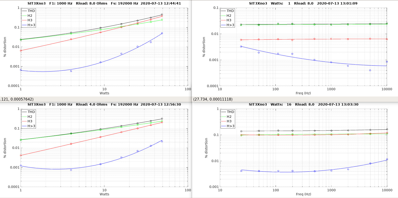

The spectra and residual waveforms do not change significantly with the load resistance.
The power supply noise (harmonics of 60Hz) is below the noise level.

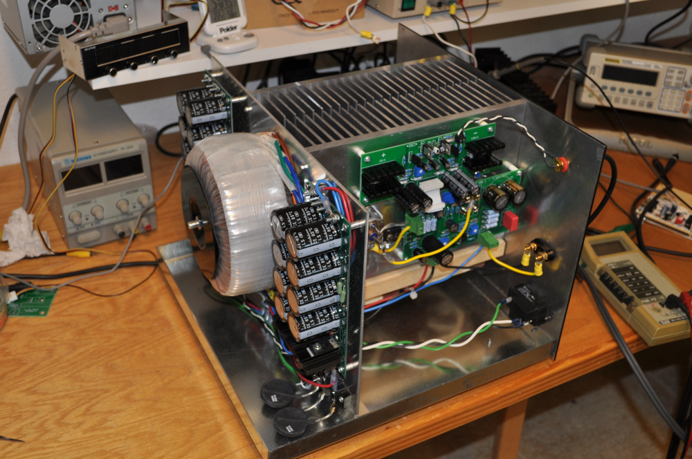

Also, where will the fan(s) be mounted? On top of the case?
How tall are your heatsinks? Are they adequate?
I have 4 each 8" tall HeatsinkUSA that look like the same profile.

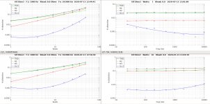

I completed adjustments of both channels of the SIT3X. Bench measurements show THD<.5% at 50W and THD<.02% at 1W. By adjusting the "magic distortion pot", the spectra are largely insensitive to the load resistance.
