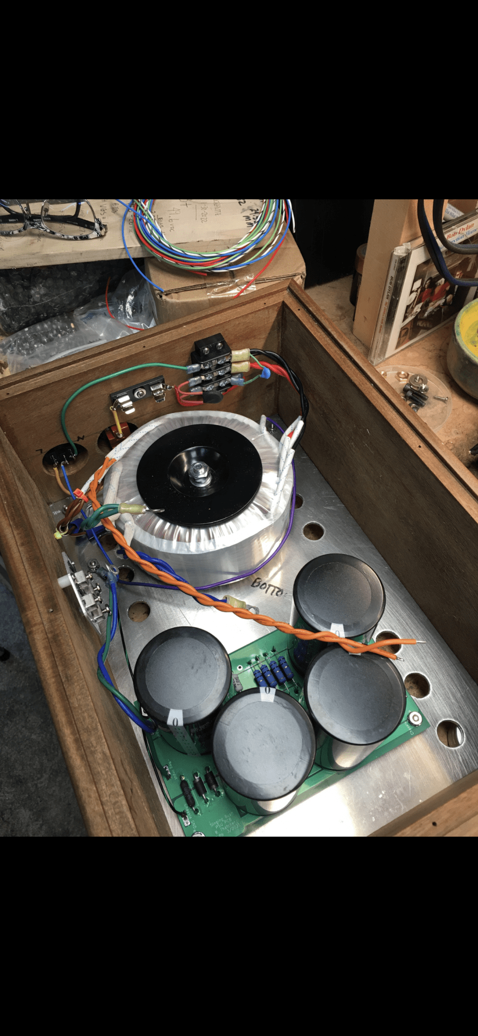

This one
Reactions: Mikerodrig27
That is a location where you can install a film capacitor to bypass the electrolytic capacitor. The audio signal passes through there so it can be a builder decision. It will work electronically without the bypass capacitor. Some have no doubt put audio grade electrolytic cap in position C2 also. 🙂

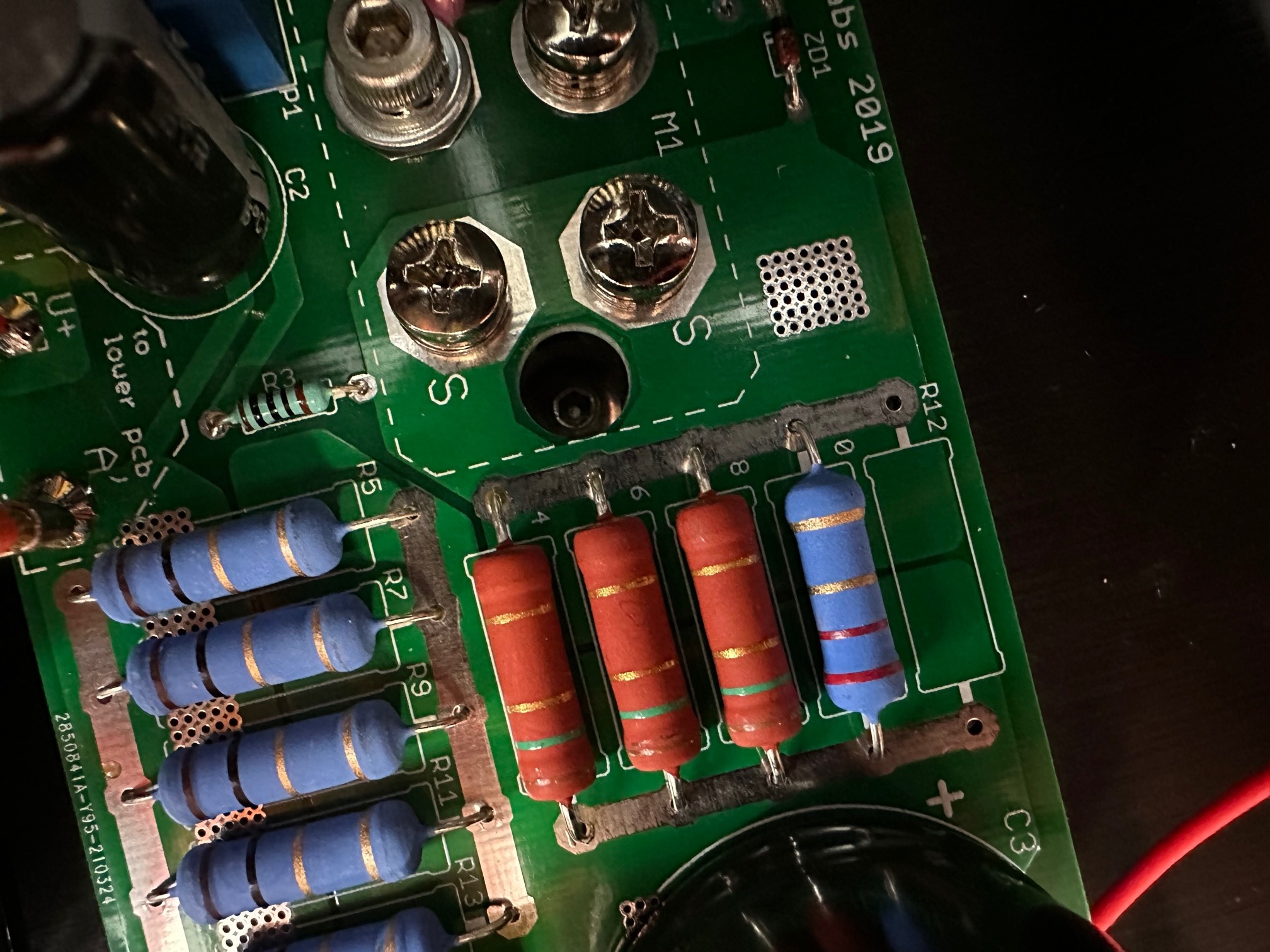

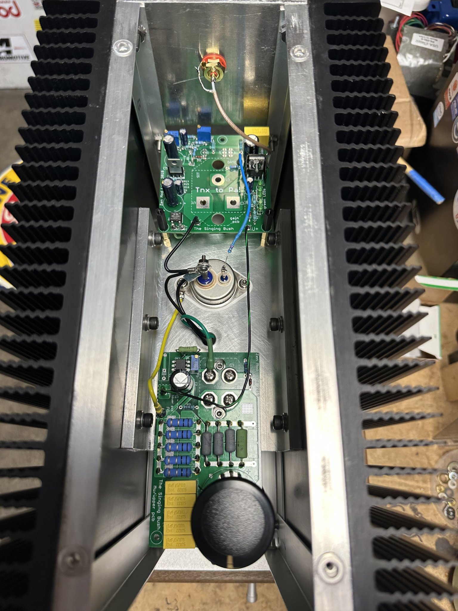

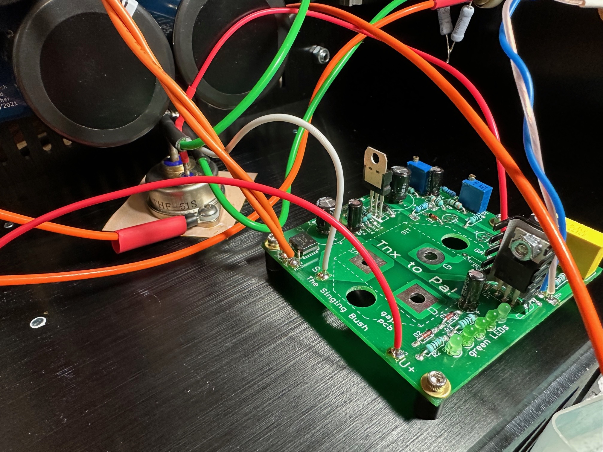

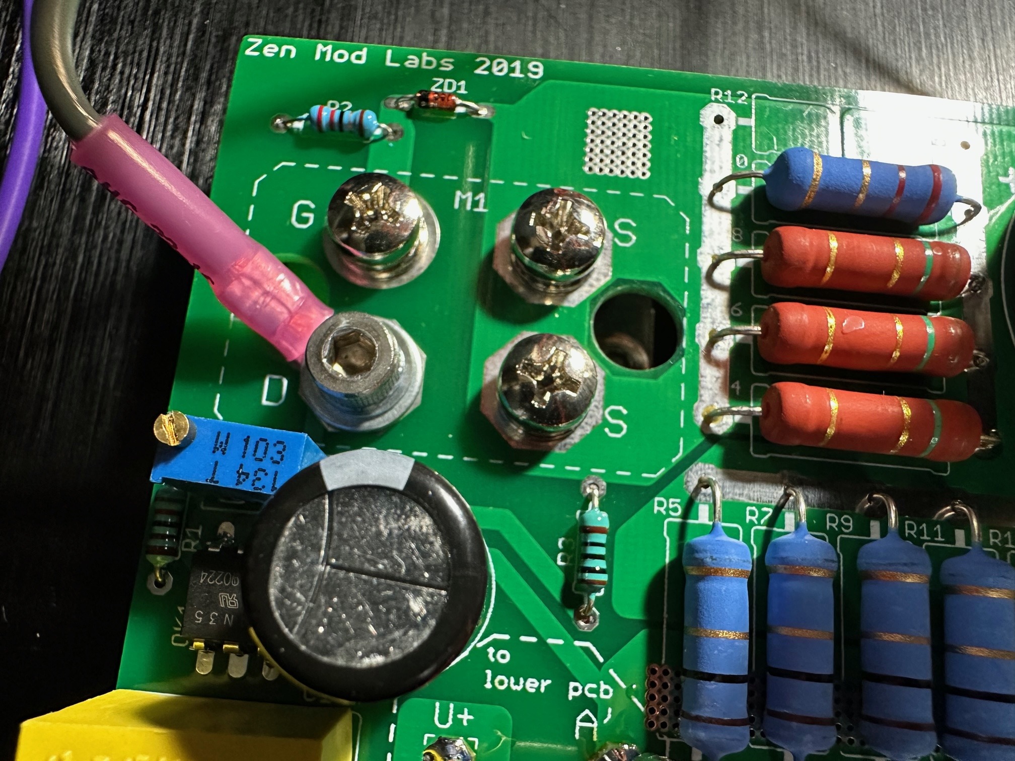

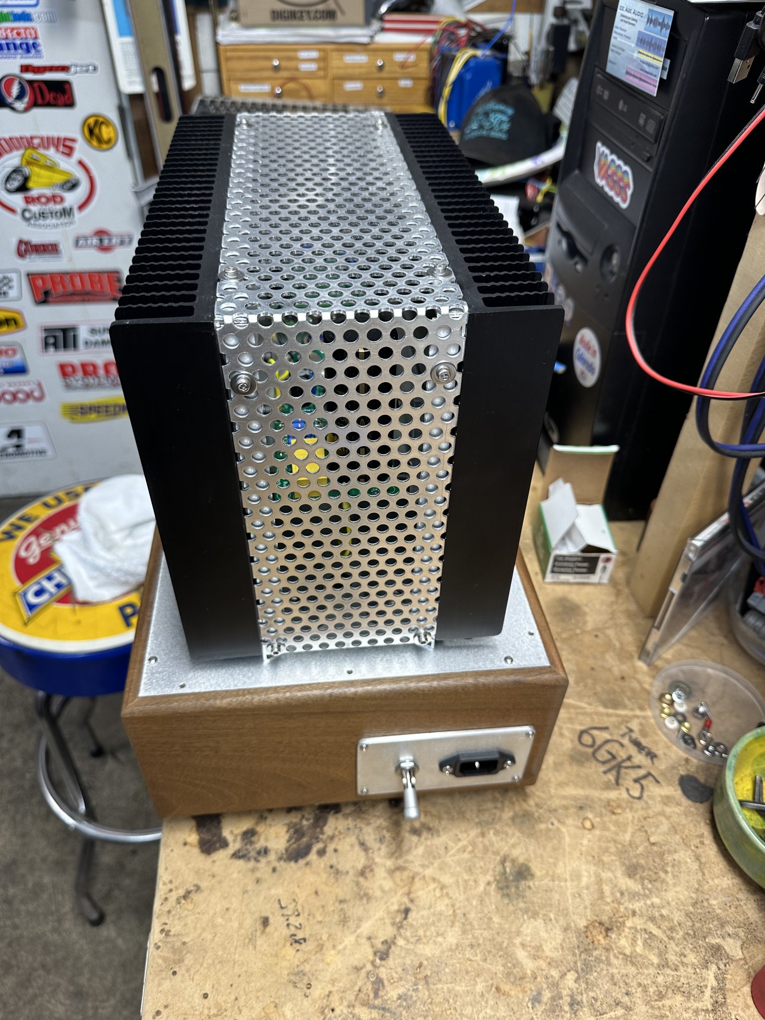

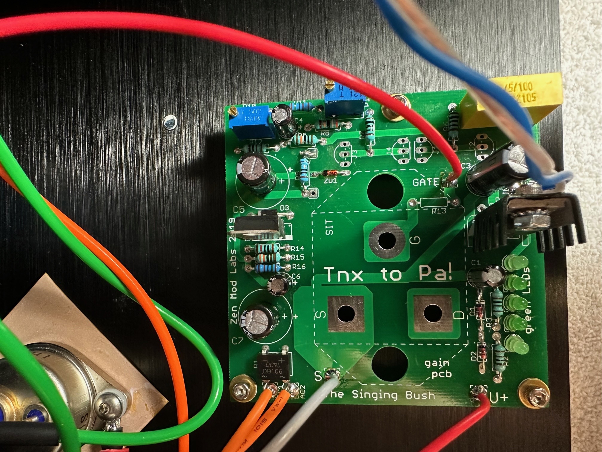

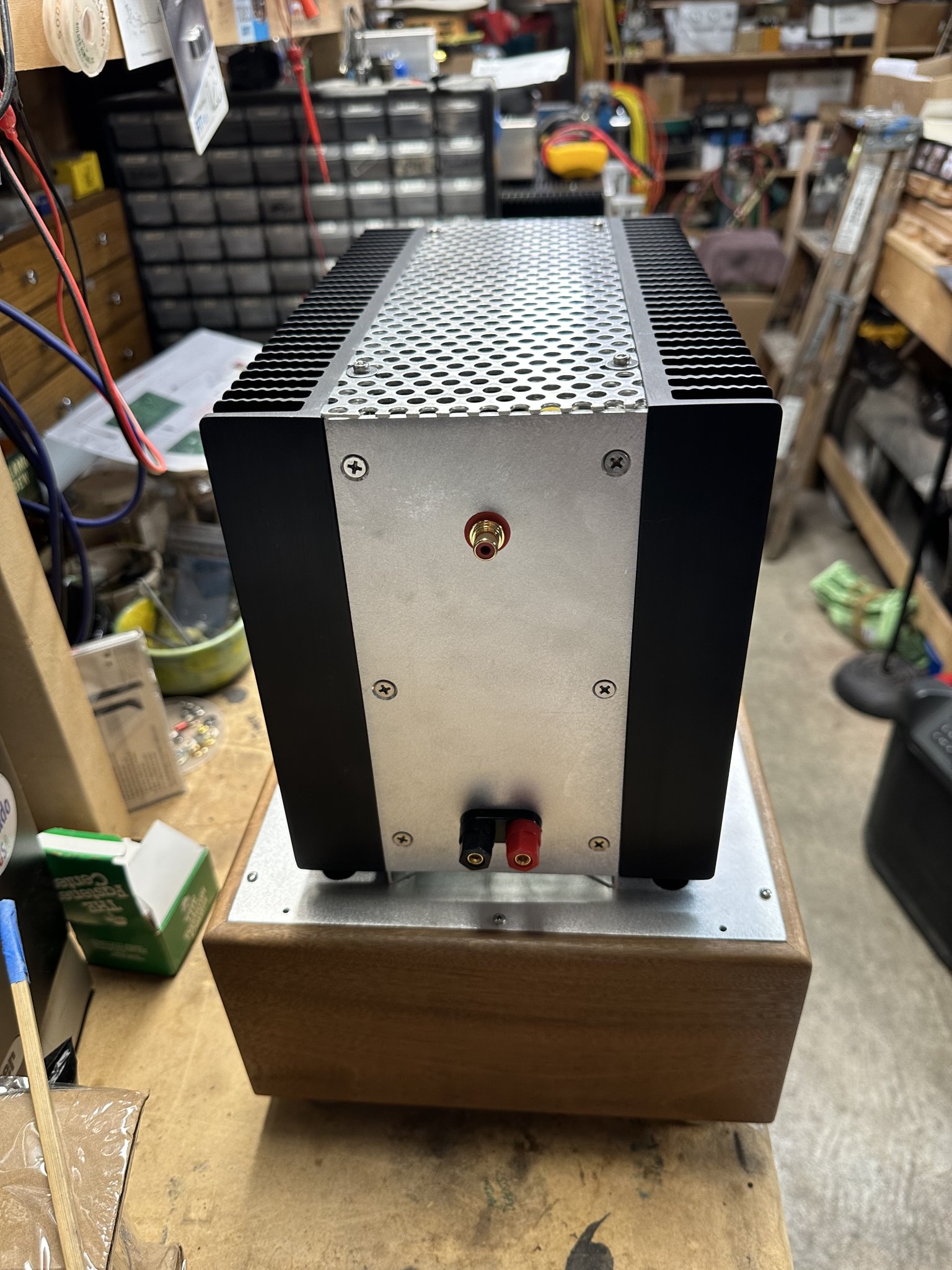

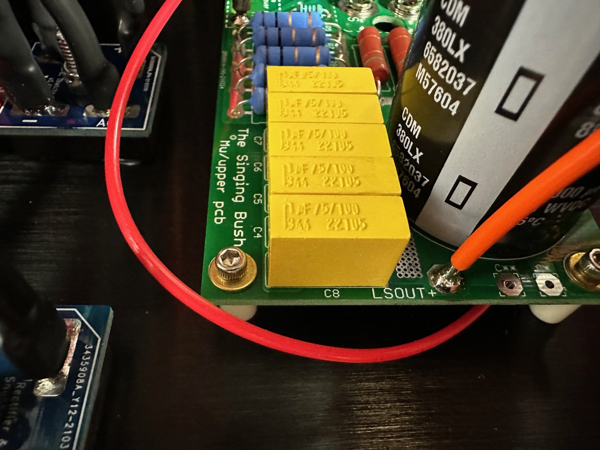

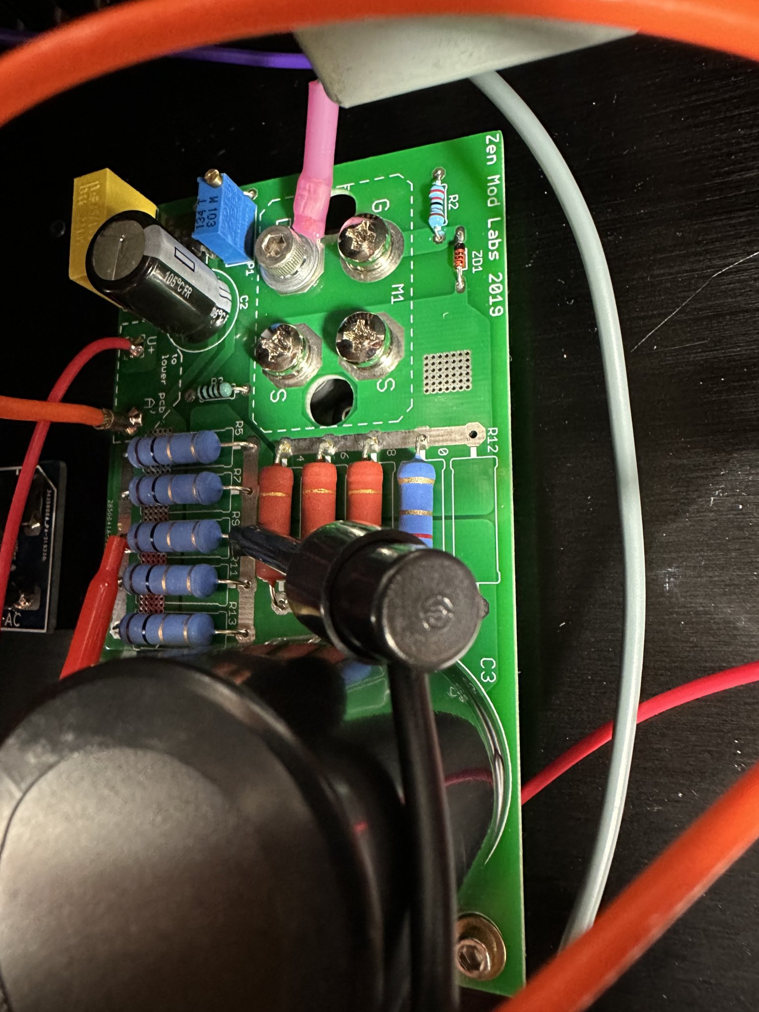

Looking good Monk. I too am at the point of firing up the first channel and unfortunately blowing fuses... THF-51S Version
1 - Both channel power supplies fire up fine on a 6.3A SB fuse. 400VA into 66mf-10mH-66mf for each channel. ~68VDC unloaded. Softstart is the store board with default values.
2 - Started SIT board per procedure and everything worked as expected, including adjusting P2.
3 - Connected SIT drain wire, 4A SB fuse in V+ line and turned it on, Iq quickly went up beyond 0.5V across R5/7/9, etc. and before I could click it off, main AC fuse blew.
4 - Double checked Tokin D-S resistance, still 0.9R. Resistance across R1&P1 on Mu board is ~18K.
Will get some better pictures posted, but any recommendations on initial troubleshooting? Thanks!

Thanks ZM. no rush. More pics attached, realize I need to flow solder to top side of resistor leads when zoomed in here.

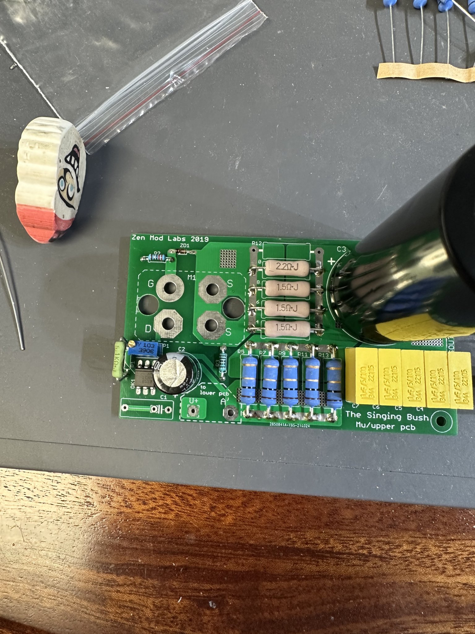

usual drill - check positioning of all zeners, also resistors , also optocoupler ....... even if I can't see anything wrong on pics
now, if you don't find anything wrong with that, you need to commence few tests
did you read this one : https://www.diyaudio.com/community/threads/the-singing-bush-tips-n-tricks.357497/post-6290565
Thanks - yes read and followed the start up tests, no issues at all with the SIT board start up. Checked all resistors and zeners, optocoupler in correct orientation as well... puzzled. Will do more tomorrow night with fresher eyes.
