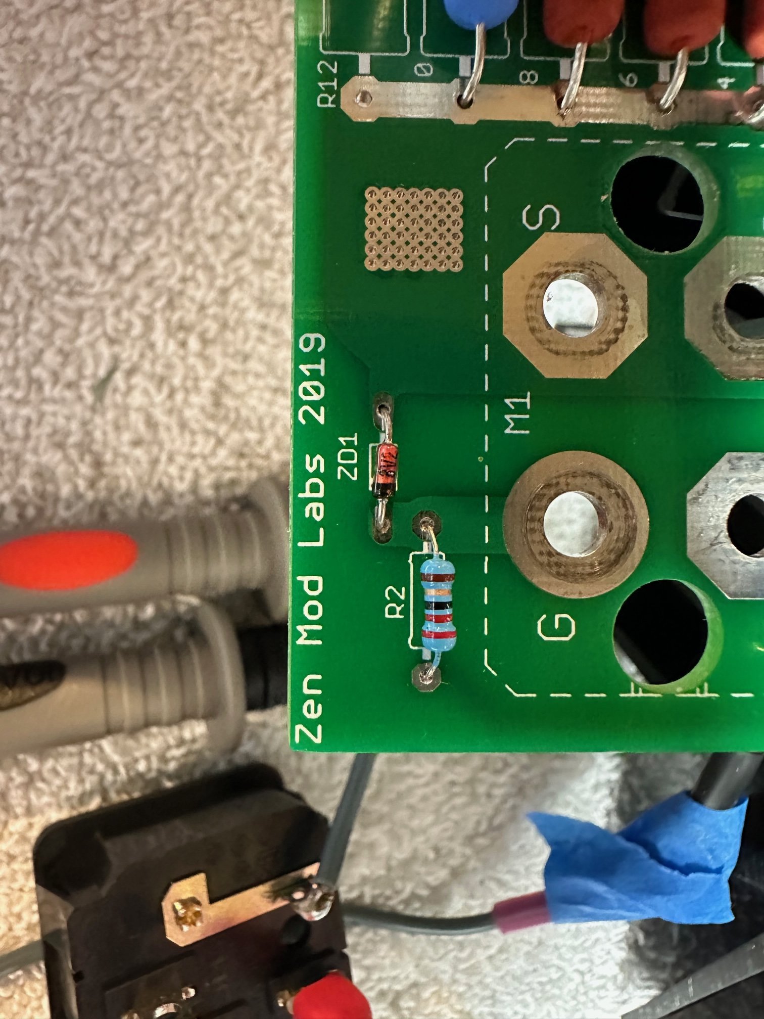

Little time this evening to unmount mu board. Nothing looks out of the ordinary to my eyes. Not sure how to test the zerner w/o removing from the circuit, which I can.

can you test just Mu, applying power and just for several seconds - connecting fat wire (going to lower pcb/SIT Drain) to GND, while having DM connected to observe Iq?
which pucks are you having in Mu?

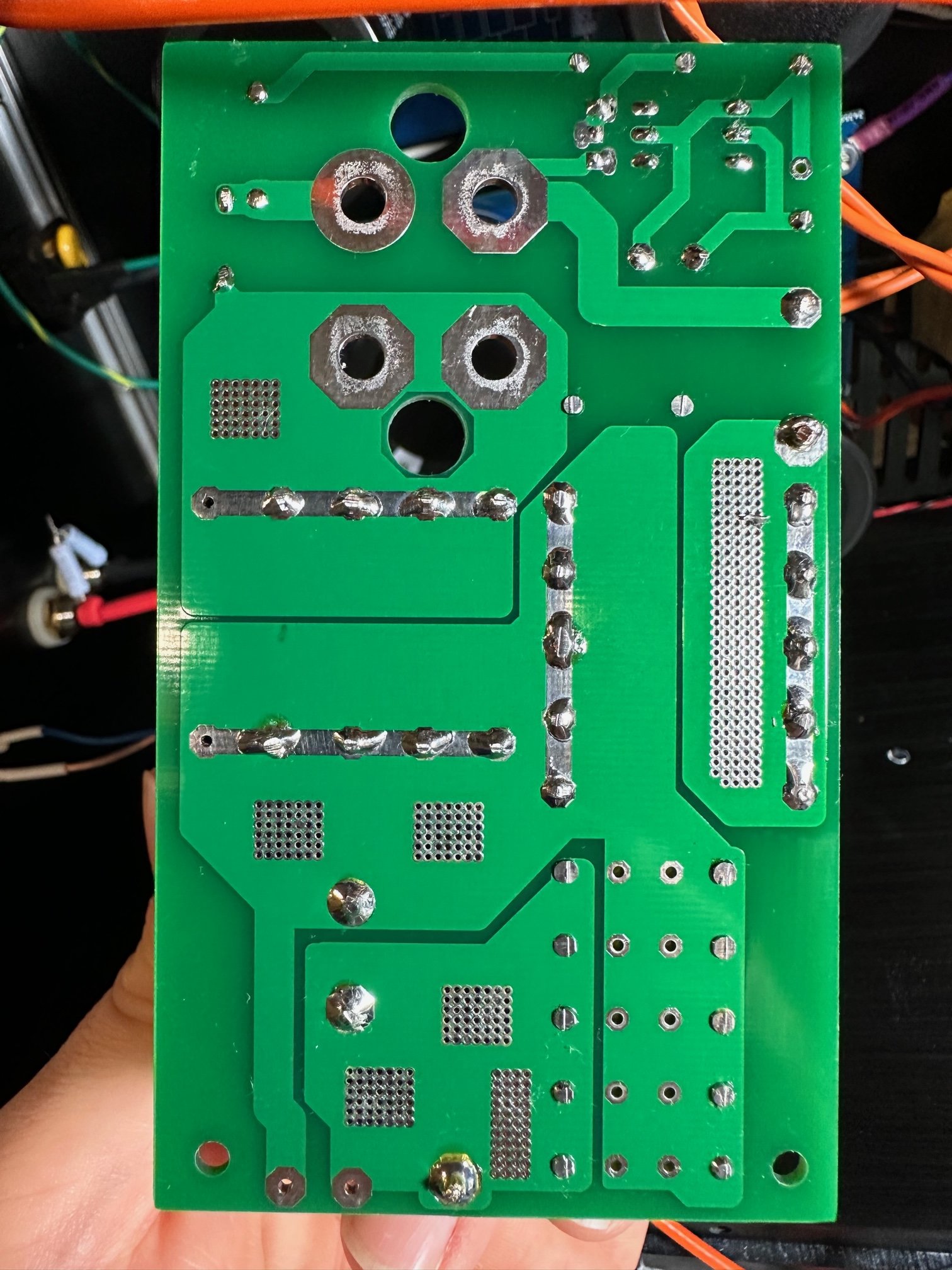

if you did remove pcb from puck, zener is all yours to check with diode test of DMM

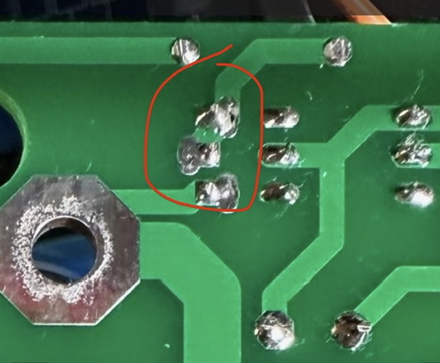

there needs to be mid connected with one outer pinAny chance you may have had a short here? That’s only thing that caught my eye

I missed the forest for the trees 🙂there needs to be mid connected with one outer pin

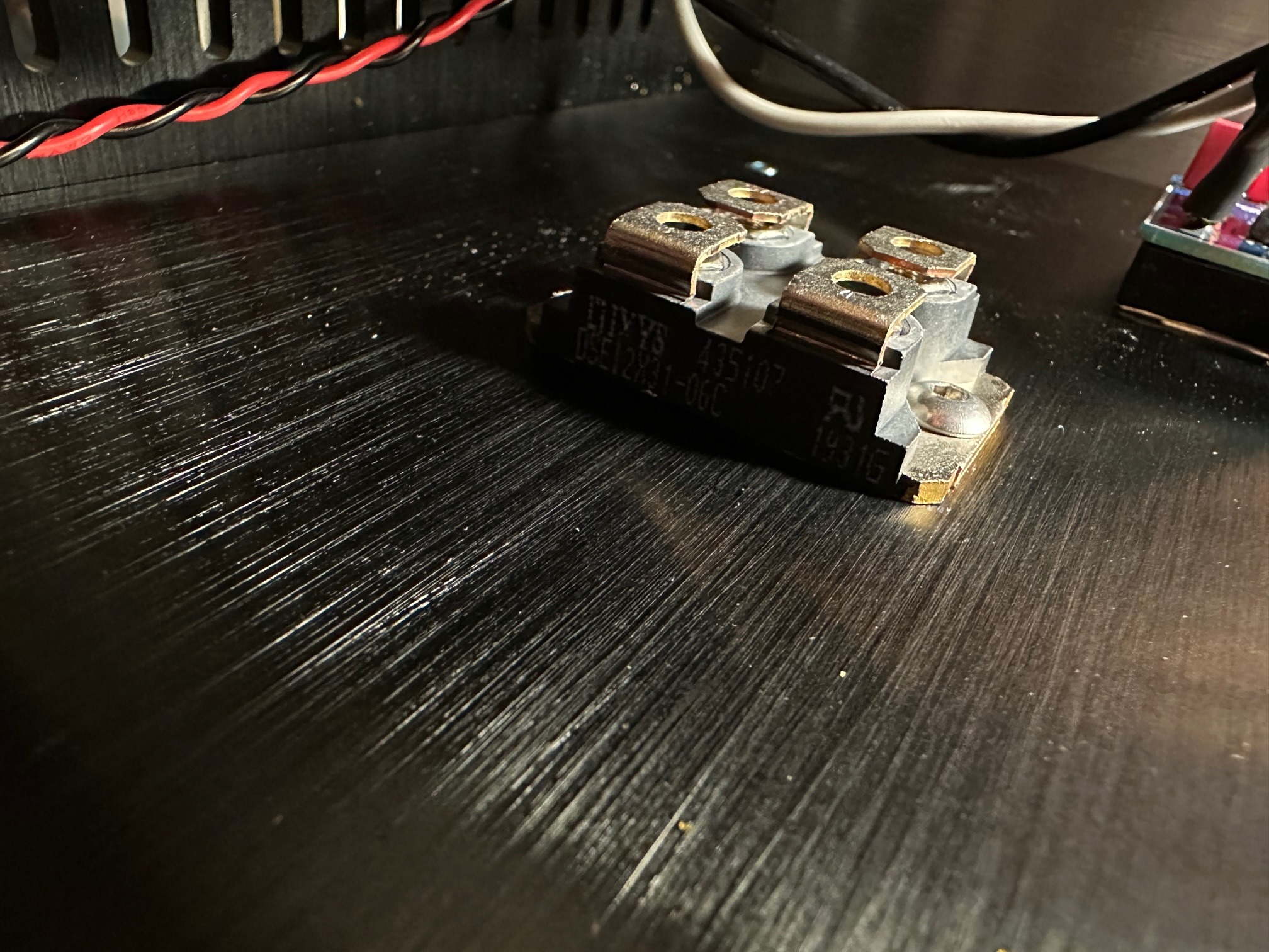

Thanks all. I will test the puck, when I pulled the boards off last night it got me questioning if I received the right part. They were ordered from rs components a year or so ago when no one else had them in stock. now that mouser has them again, ordered another pair, but will test what I have while waiting.
Just un bolted them, and while smudged, pretty sure I got myself a pair of DSEI2X31-06C diodes... grrr... sorry for wasting everyone's time. Checked my invoice and I did order the right FET from RS, last time I use them,

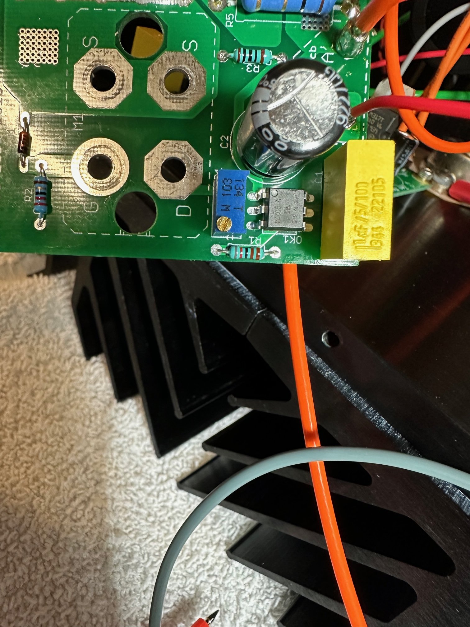

Had to adjust R1 on mu board to get Iq measurement to 460mV. But can't get drain voltage on SIT below 40V. If i understand correctly, I need to increase R11 on SIT board to 3-4K?

to get output node lower, means you need to open SIT more ( less internal resistance) which means gate voltage must be more positive (less negative)
ref to sch in post #4 https://www.diyaudio.com/community/threads/the-singing-bush.349248/post-6074239 , decrease R11
say 510R or anything close to that
or just short R11, who cares
