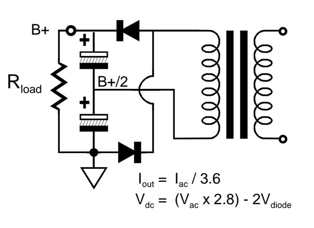

I want to build this singing bush with 2sk180 parts, but unfortunately i only have a big 20A toroid transformer with 24v single tap
question is, if i had to use a voltage doubler circuit to boost 24vac into 65vdc, what is the negative side that will affect if implemented into this amp.
in theory with voltage doubler
24vac x 2.8 - 2v = arround 65v
and current would become half from 20A into 10A
and it's look like still enough to powering this amp (without knowing the bad side)

too much ripple for my liking
voltage doublers are OK for lower currents, but when dealing with 2A++ ........... you already have bucket of other problems to take care of
why adding another enormous problem, on top
