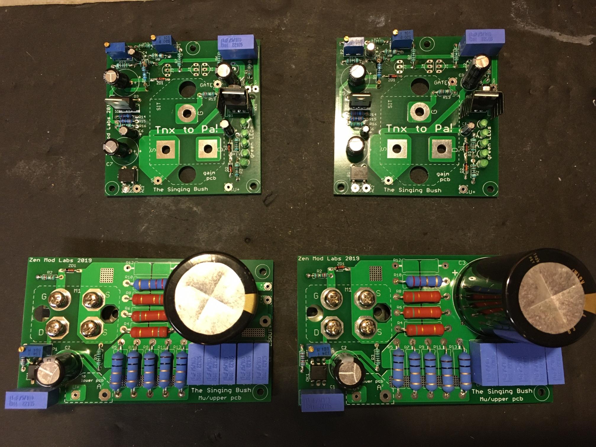

Due to the cold wet weather we are having, I started on my Singing Bush amp. I have the power supply diode boards with snubbers completed and I just finished the Mu and SIT PCB's. I adjusted all the pots according to Tips and Tricks.
I have a question regarding the C* on the Mu board, the schematic suggests a motor run capacitor for this location. I already have a motor run cap for each back of CRC filters on the power supply.
Is C* a smaller cap for C3?
What size?

just for fun - if you want motor run in parallel with output 10mF
size/value - whichever moves you in right mysterious ways
