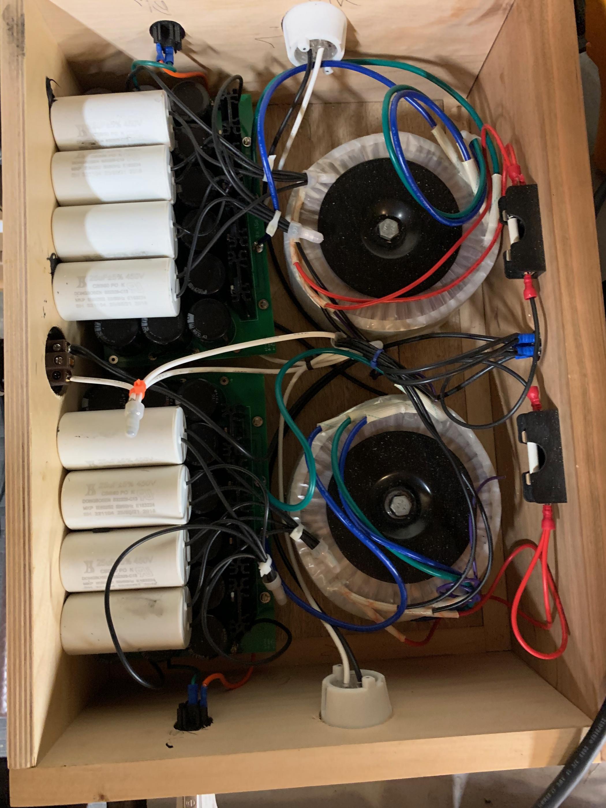

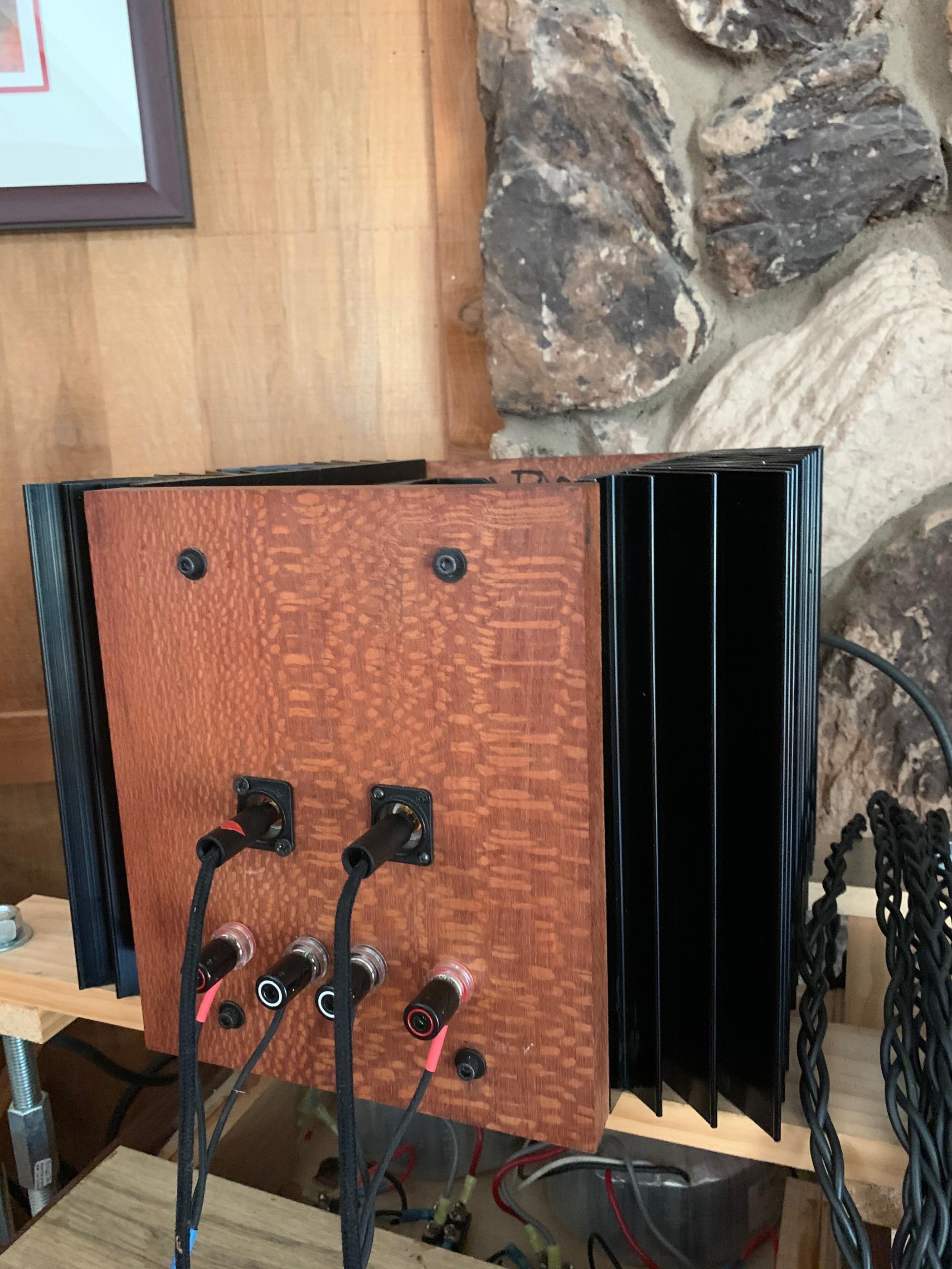

I made monoblocks using 4U Deluxe chassis.
Was able to use 2SK77B outputs. Power is there
Not able to say it’s superior to SissySITView attachment 869454

Up and Singing
My Singing Bush is up and singing - thanks to Nelson and mighty ZM
Absolutely quiet with the Tannoys
Voltage 60V
Voltage at SIT 36.4V
Current 2.2A
Initial listening - very smooth, involving - need to do more 🙂
Absolutely worth the build
