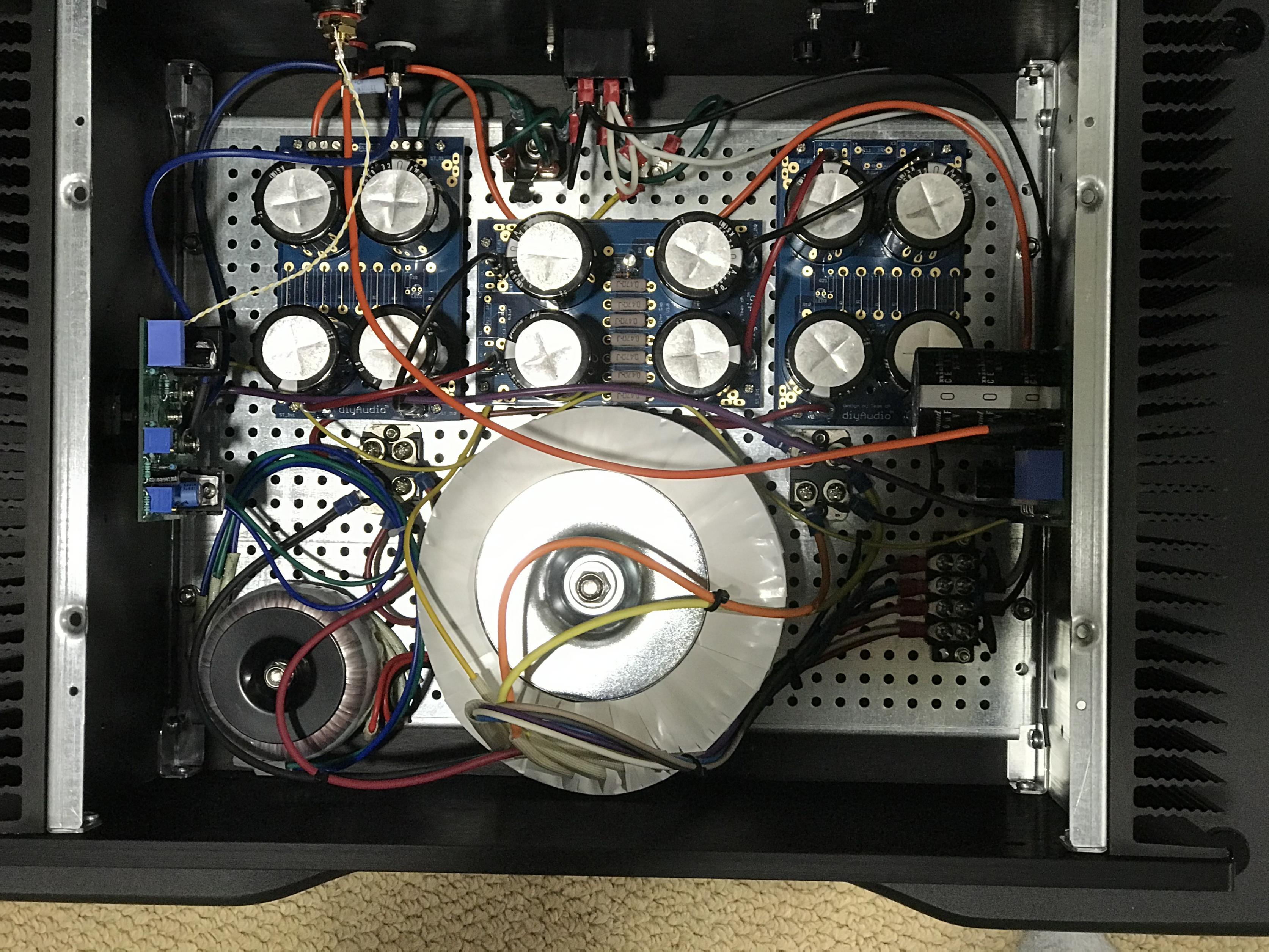

Worth considering is a CLC supply. I used CLC, as I mentioned in post #487 (The Singing Bush). I ended up with 44mF - Hammond 195ZJ - 44mF per channel. A single thermistor slows the charge to the capacitors.
The cost was probably no more than CRCRC with 165mF per channel as 80V electrolytic capacitors are not inexpensive, and the choke takes up no more room than the capacitors.
My CLC supply is very quiet - no noise from my 103dB speakers.
Papa Pass suggested CRC of 47mF - 0R5 - 47mF:
