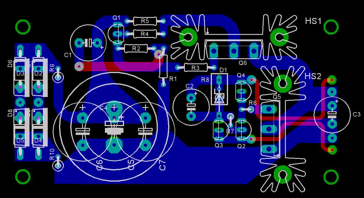

Hi!
We plan to organize a group buy in Hungary with this version.
I've designed a PCB as well with the following features:
Regarding parts, values, layout, anything else?
Thanks in advance, cheers!
If it's ready I'am happy to share the eagle files!

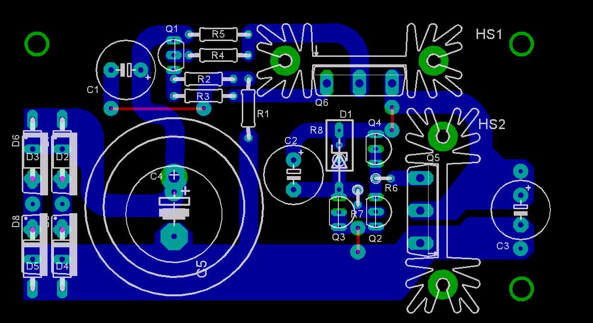

- on-board AC section (supporting normal and TO-220 cases)
- reference: either with diode (D1) or with trimmer (R8)
- SK-104 heatsinks
- compact size (doubling it fits the typical 10x10cm PCB size)
- basically single sided design (for DIY etching)
Cortez

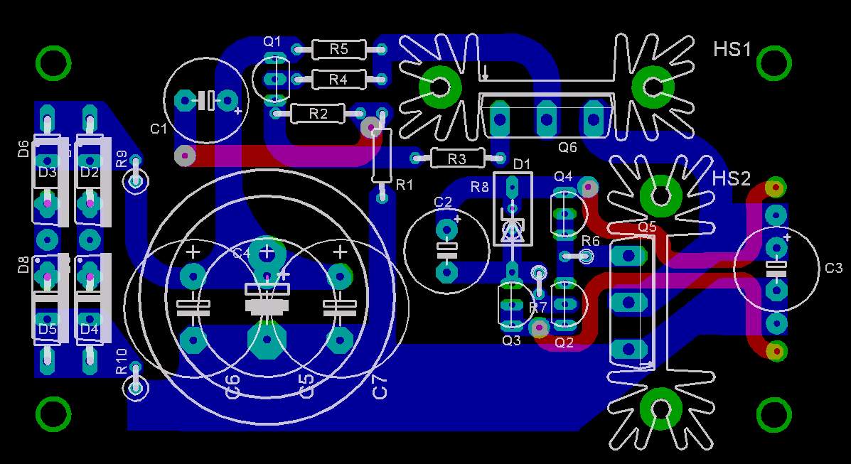

Move R3 to attach to the gate lead.
Turn R6 around to attach closer to the gate lead.
The two links shown in red from Q2/Q3 to the -ve and from Q4/D1 to the +ve should be attached directly to the output nodes over beside C3.
You have high currents passing along the sense leads in your existing proposal. Do not share traces/wires between different circuits.
Nice to have if you can create a bit of space to accommodate
1.) change R5 to two or three resistors in parallel. This allows you to easily change the CCS current and keep the dissipation in the multiple resistors lower.
2.) change the D1 from one Zener to two or three components connected in series. This allows you to fit a LED plus resistor/trimmer plus Zener to set your output voltage.

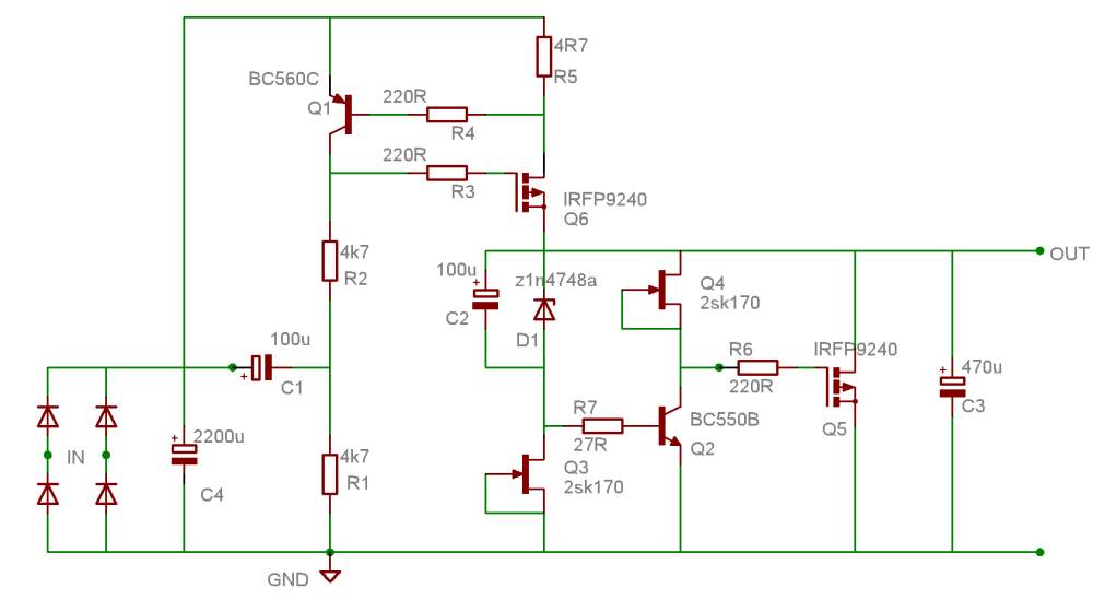

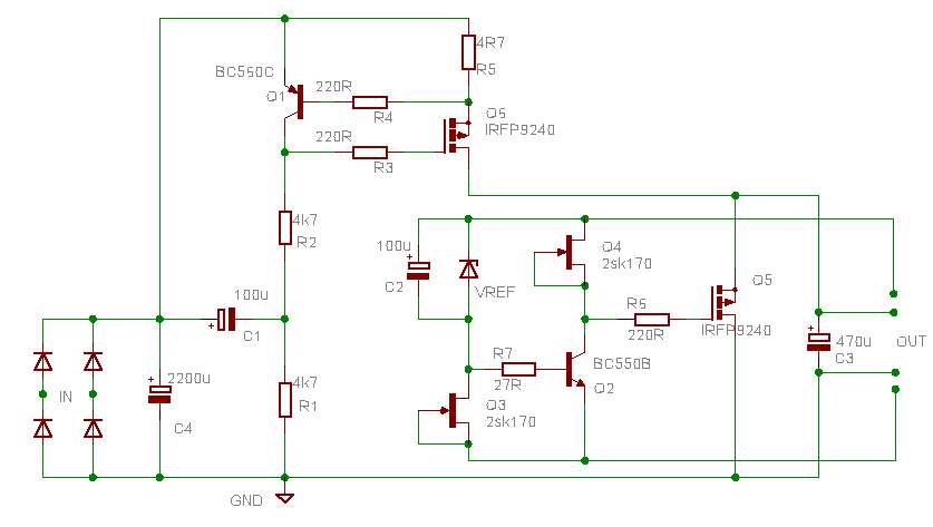

the Salas Shunt regulator is a combination of two circuits.
A Constant Current Source (CCS) that passes the required output current plus some spare current plus the current needed to operate the next stage.
A Shunt regulator stage that is a bit like an adjustable Zener.
If you consider each half alone, you can gain a better understanding of what is needed in each half.
When you come to building, I suggest you build the CCS half alone and leave the whole of the regulator unpopulated. This allows you to set the CCS current and test for correct operation using a shorted output and/or a dummy load. Once you have that working properly and see what minimum voltage drop is required across the CCS, you can populate the regulator half and continue testing.

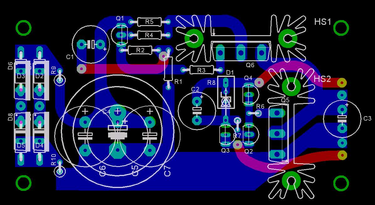

you have separated the two sense leads from the outputs. That is going a stage further than I suggested.
If you do that, then I suggest you make the loop area inside the sense leads very much smaller.
Yes, much better.
Do you want to keep the separate sense pads? or tie directly into the output pads?
It increases the Builders options, but can lead to errors if they have not read the instructions correctly.
Issue an instruction to insulate the top layer sense tracks to prevent shorting to the heatsink.
Two layers of sticky tape, in addition to the epoxy coating, would be good enough.
Thanks! Yes, I'd keep the sensing pads separately.
Sense tracks vs heatsinks: good point thanks!
Is it okay now? 🙂
The SK-104 heatsink has an open area right under the transistor section.
The filtering series R after the rectifier diodes (R10) on GND is okay or can cause any problem?
