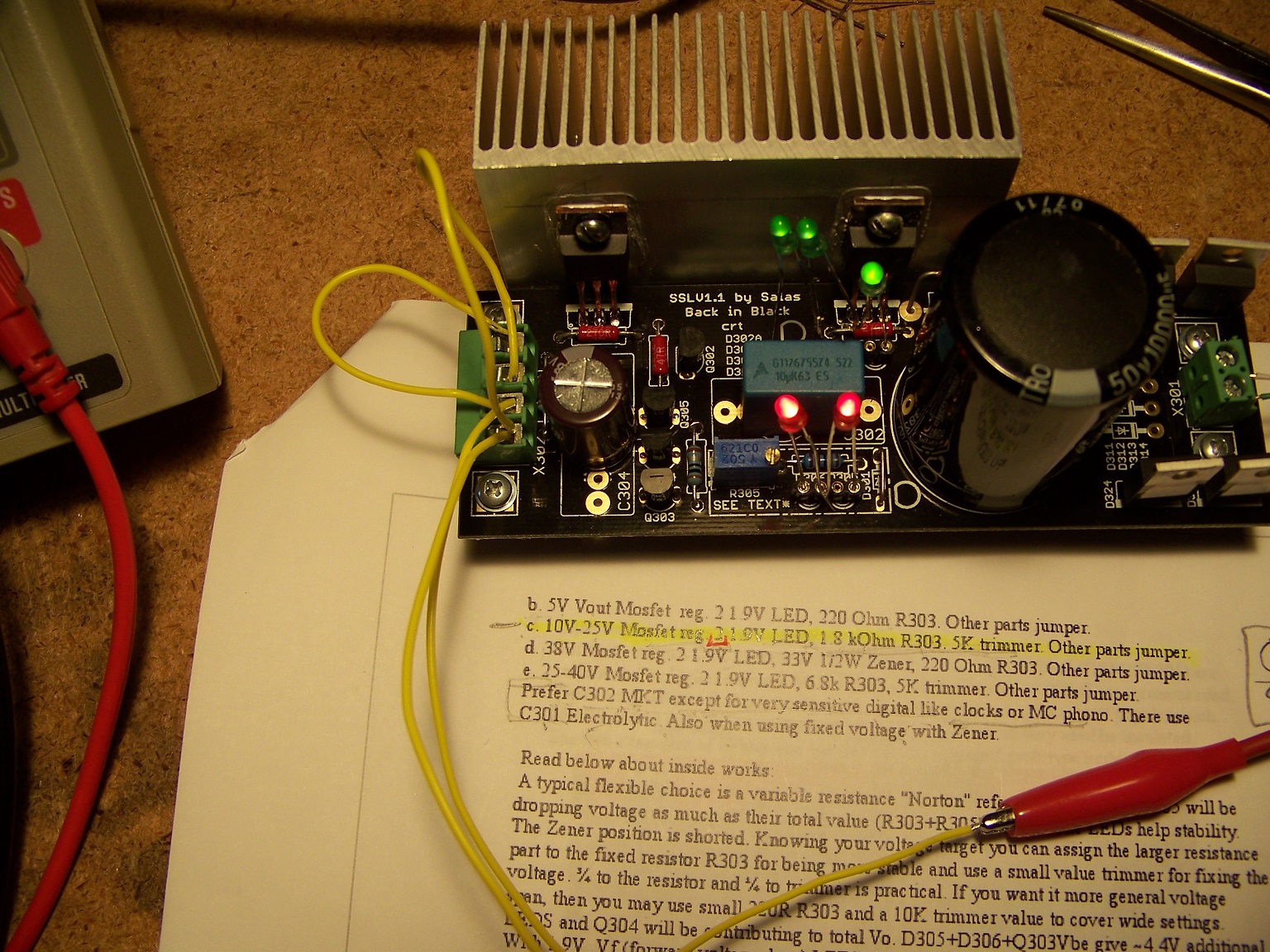

Salas 24V BiB problem

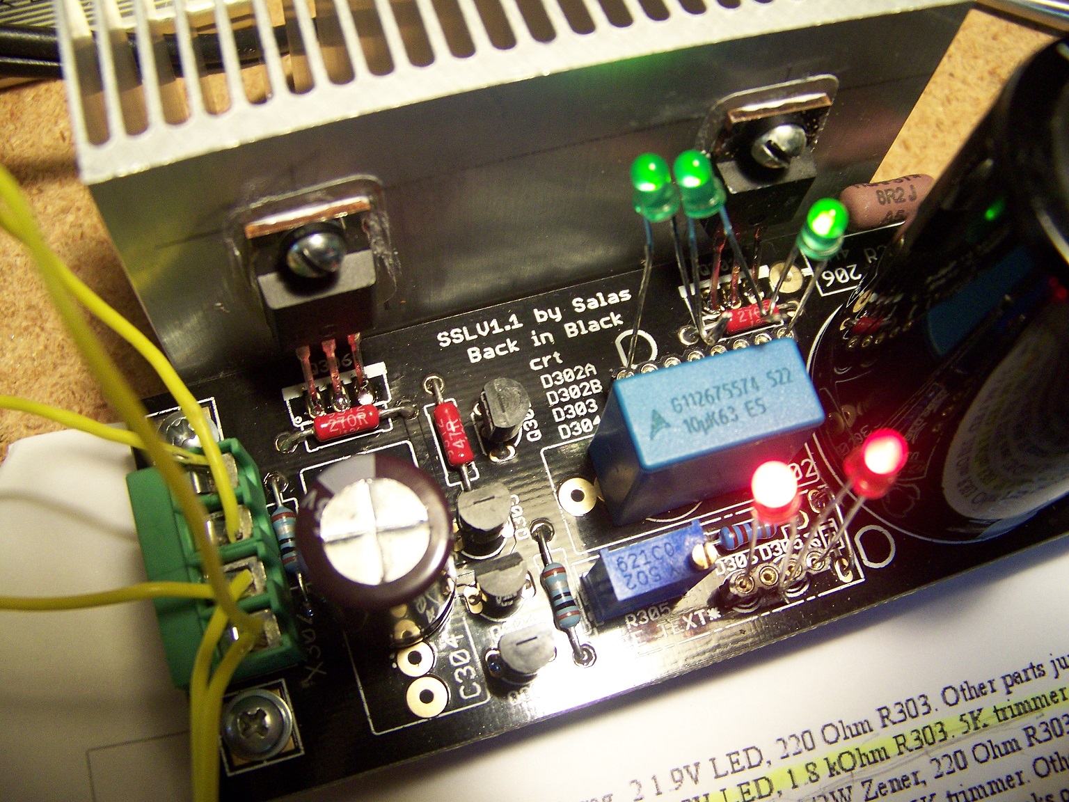

I built up the BiB positive reg SSLV v1.1 pcb from TeaBag.
For Q2 used lowest measured Vidss of (3.4) 2sk117 as supplied from TB.
For Q3 used medium measured Vidss of (4.27) 2sk117 .
For Q3 used highest measured Vidss of (5.18) 2sk117 .
--as per Appendix 5, suggested fet placement.
Appendix 1 c. 10V-25V Mosfet reg. indicates 2 1vpv LED + 1k8R for R3 + 5k trimmer, jumper other parts.
Here's what I get twiddling the 5k pot.
Lo 12v9, Hi 14v5, with Vac=27v15, Vdc35v4 (after diodes).
What I require is +25Vdc for a Pass BA-3 preamp board.
Thanks in advance for direction. 🙂
ICHI aka Joe

Try a higher R303 value first so we see how it reacts to it
Thank you for the response 🙂
I added in the following resistors at the jumpered zener position leaving the 1k8R in place...
2k44R gave max out voltage 14v5
5k0R --------------------- 14v6
100k0R ----------------------- 14v7
1m0R ----------------------- 14v7 red leds very dim with this one
So it does not add voltage. That makes me think maybe there is a problem with load current vs CCS current available. Do you use a dummy load, and what is its value?
Load with 100 ohms, measures 150.25mA at 14v533,
1v276 drop across 8r2 (R1 current Adjust resistor) = 155mA
Load with 50 ohms, ------------154.12mA
Heat sink is mildly warm, no components feel hot. 😕
Transformer output is 27v15acV
voltage past the diode bridge is 35dcV
The heavy dummy load eats up all your CCS early. In other words the reg enters constant current protection mode (just like a lab PSU) when the CCS preset is met. A dummy must be calculated as a representation of your goal load. Say 500 Ohm for a 25V rail 50mA bias load.
I suggest you try again with the reg in original R303 state and a 500 Ohm dummy.
Now tried a 226R load, which with 24v should give a 106mA load to reg.
The result was I got to set voltage out to 24v 🙂 but current measured 91.86mA ?
So, you nailed it! 😉 I was drawing too much current demand.
Don't quite understand why I'm only getting 151mA through R1 (8R4)
when instructions table shows 240mA for an R1 of 8R2 ? I would
guess it has to do with variances of the active devices ? But, that's
beyond my understanding.
What the Pass BA-3 pre-amp requires is a +- 24V supply with 53 mA
per channel, so 106mA total.
Cheers
Maybe due to this Burden Voltage - NI Digital Multimeters Help - National Instruments
Cheers![]()
Is it the calc sheet that pointed 240mA? Measure your green leds Vf in circuit and if its significantly lower than assumed in the calc it can be due to surely lower current provided to them in circuit by a source resistor degenerated JFET than nominal which is stated for high enough current.
Think of 2-3mA and look up their Vf curve in datasheet to see if its near what you can measure across each. Correct to your original goal with a smaller value CCS set resistor or by paralleling one extra to reach the proper value together. Some spare current is good to have.
