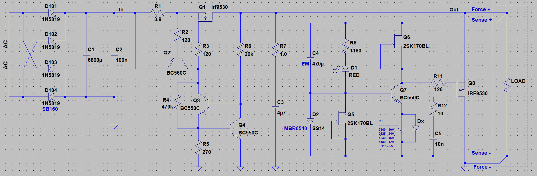

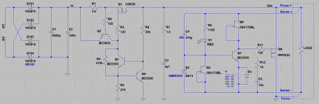

I do not remember if I posted this before, but a conversation with a friend last night reminded me it is worth sharing here.
Some time ago while I was experimenting with BiB I smoked plenty of 2SK170 when I shorted the output. Depending on the type (combination of ESR and capacitance) of capacitor filtering the reference voltage C4, the pn-junction of Q5 (according to my schematic below) conducts too much current for a small period of time. The solution was to use protection smd Schottky diode D2. I tested both SS14 and MBR0504 and they worked fine, saving Q5 when shorting the output.
Why so many? You were carrying out systematic shoring tests?
Yes Then I ran some similations in LTSpice to confirm my mishaps.
The funny thing was that I had no problems with my RIAA regulator with 220uF Silmic II (Vref lytic) and Vout=28V. But my DAC regulator with Vout=5V and Nichicon KA 1000uF caused me all these troubles
So, it is indeed a combination of Cvref value, ESR and Vout, i.e. energy transfered through the Q5 pn junction during transients produced by shorting the output
