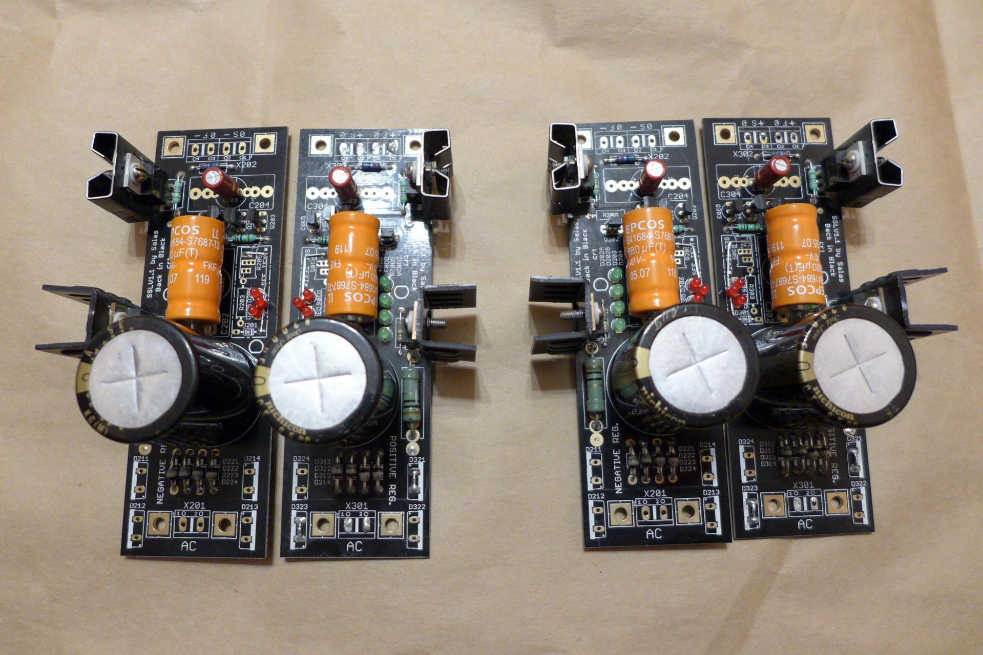

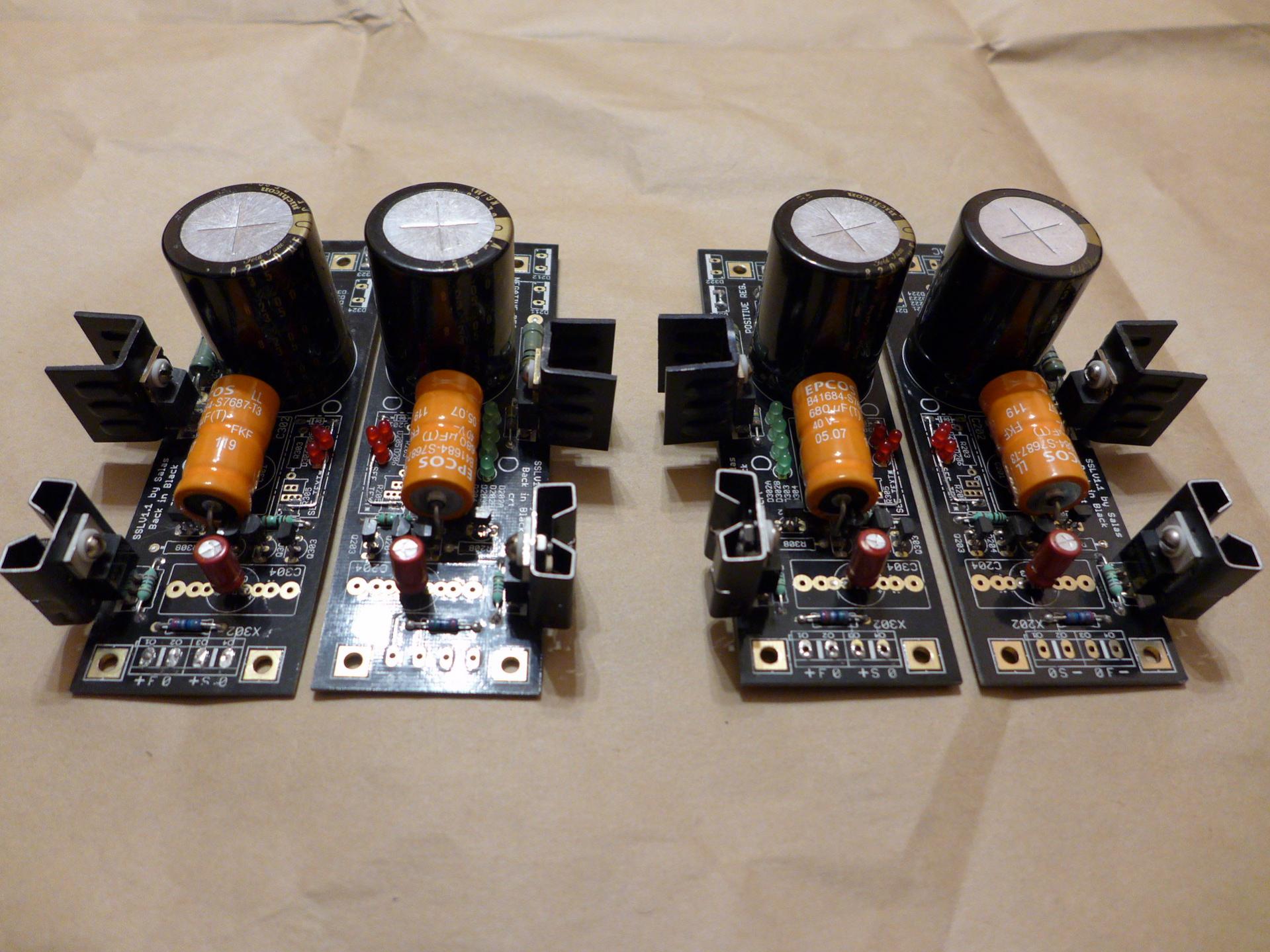

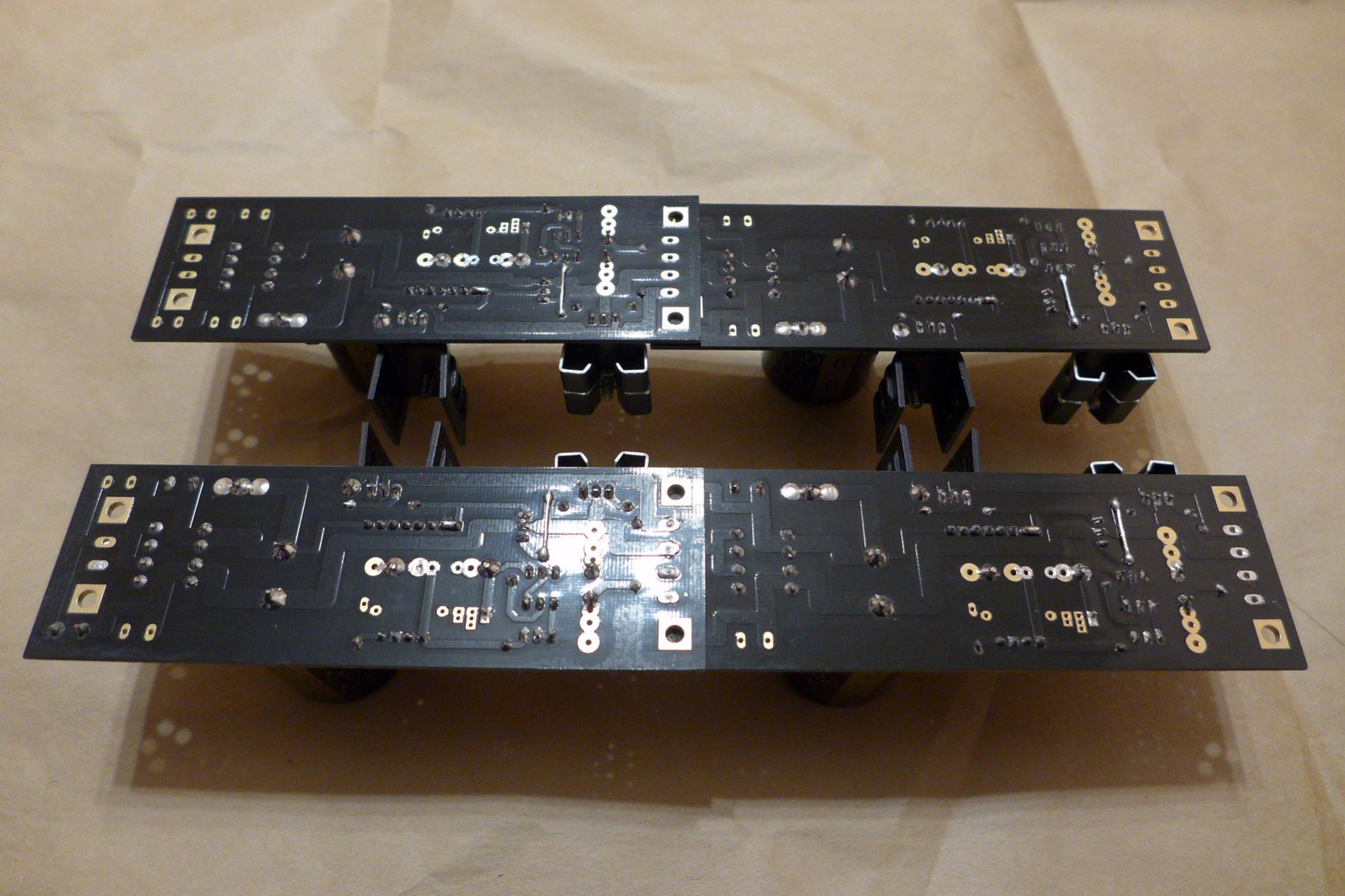

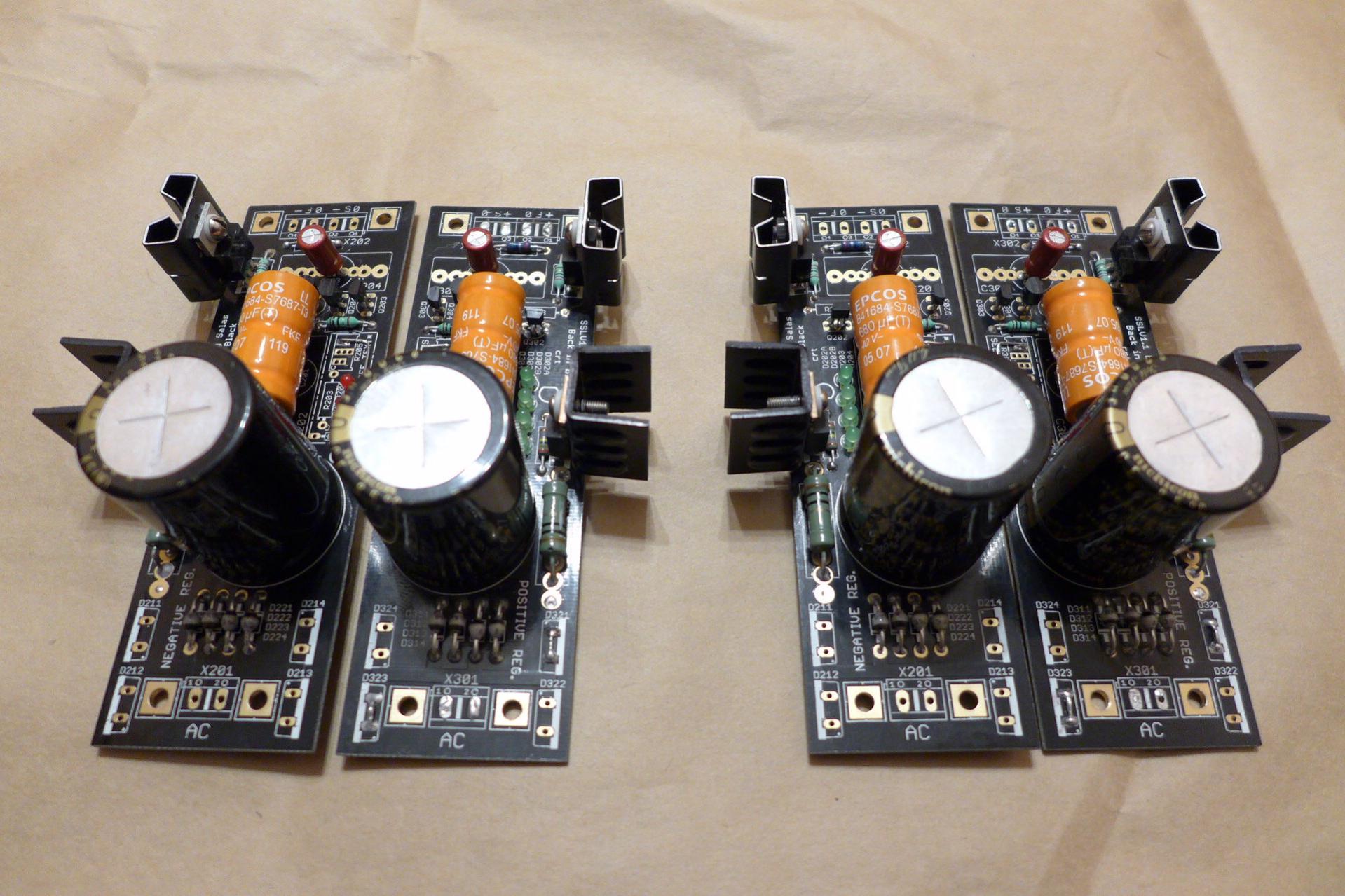

I'd like to share my current BLB 1.1 builds. They're dedicated for the analog power supply of my future high-end DAC project with PCM56.
The regs are tuned to ~100mA at and are built with the following:
-Boards from TeaBag (many thanks for the group buy).
-Epcos (Siemens) Sikorel 680uF as Vref
-Nichicon Gold tune 8200uF as first filter capacitor
-BYV26C rectifier diodes.
-Siemens MF 10R CCS resistor.
-Elna Cerafine 22uF final filtering capacitor
-Draloric, Philips and Resista MF resistors for the rest of the circuit board
-The CCS and the shunt power transistors are from TeaBag's kit materials.
-The sk117, sk184 and BJTs are bought from a local shop.
Photos:

Thank you Salas. One of the upgrades for the project will be the LC filtering of the power supply before the regulator. I'm a big admirer of choke input filtering because of their technical and most of all sonic advantages. I haven't wound the chokes yet, so at first the project will be powered with the default capacitor input filtering. My power transformers have a secondary tap on the secondary tap for a higher voltage, which will compensate for the choke input filtering supposed voltage drop.
Of course I do not intent to barbarically split the trace before the capacitor. The solution will be moving the rectifier outside the board, together with the choke.
