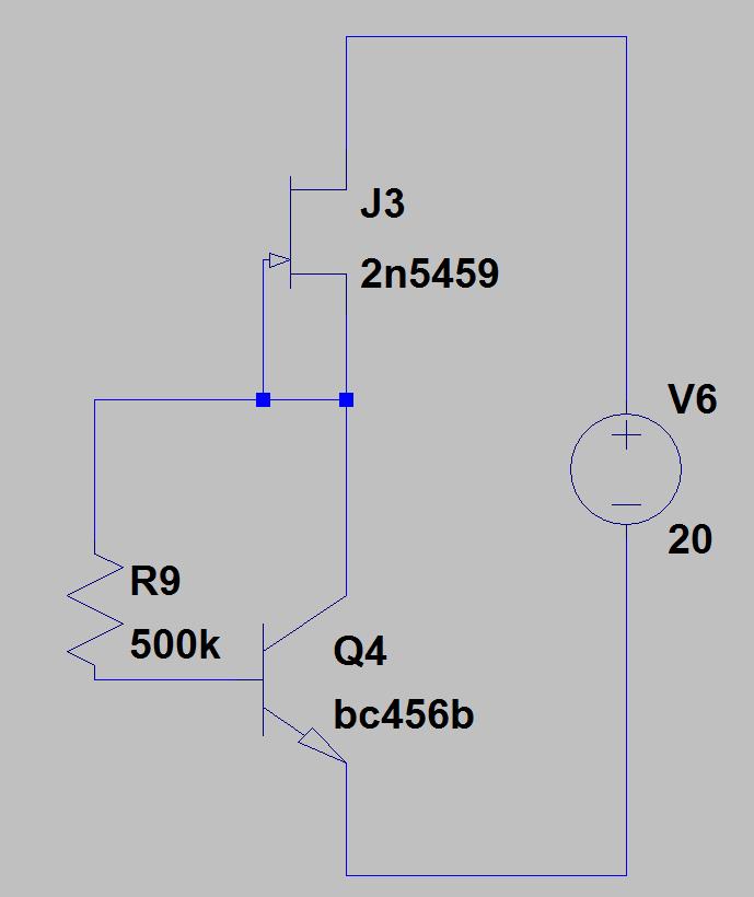

Am i running into possible problems if i do this mod for 3.3v output...?
motivation is that from experience (and a bit of speculation :)), the jfet supplying the reference bjt benefits from having "breathing space".
note: please don't mind the parts used. I only show the schematic for topology...

As Andrew said already you need to exceed the recommended minimum Vin-Vout first so the CCS will stabilize. After that point there will be controlled voltage drop differences across the setting resistor possible values due to the Vgs curve vs Id as seen in any particular MOSFET's manual and little ones due to VDS and rising thermals. In your example the first input voltage is insufficient, that is why you see a marked difference when applying that second still short but more appropriate input voltage.

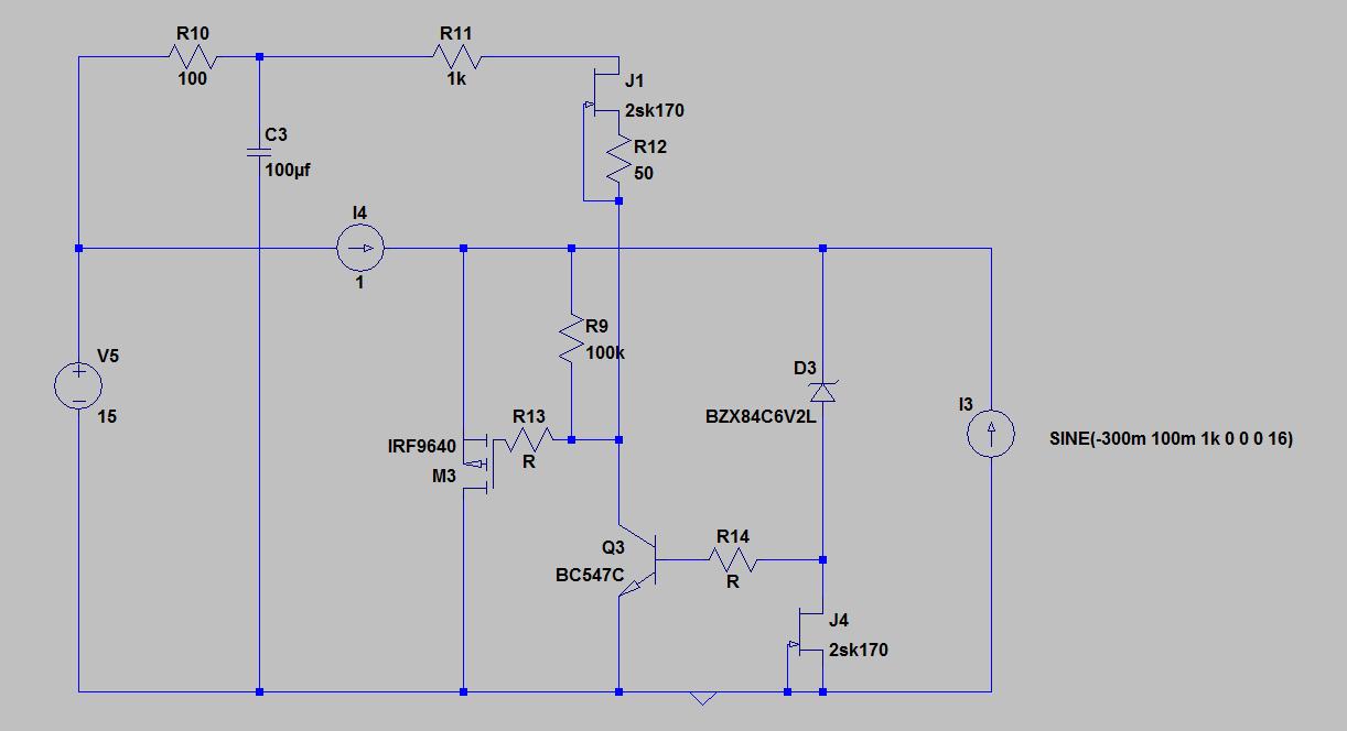

Incorporate as pre-reg filter. But make sure to check with an oscilloscope that it will not interact for oscillations or weird noises with the regulator's input. Contstant voltage circuit for the output of a reg rather not. Just pasted in a complete regulator especially without full analysis could even bring disaster. CVS (gyrator) is sometimes found as anode load in tube circuits.
