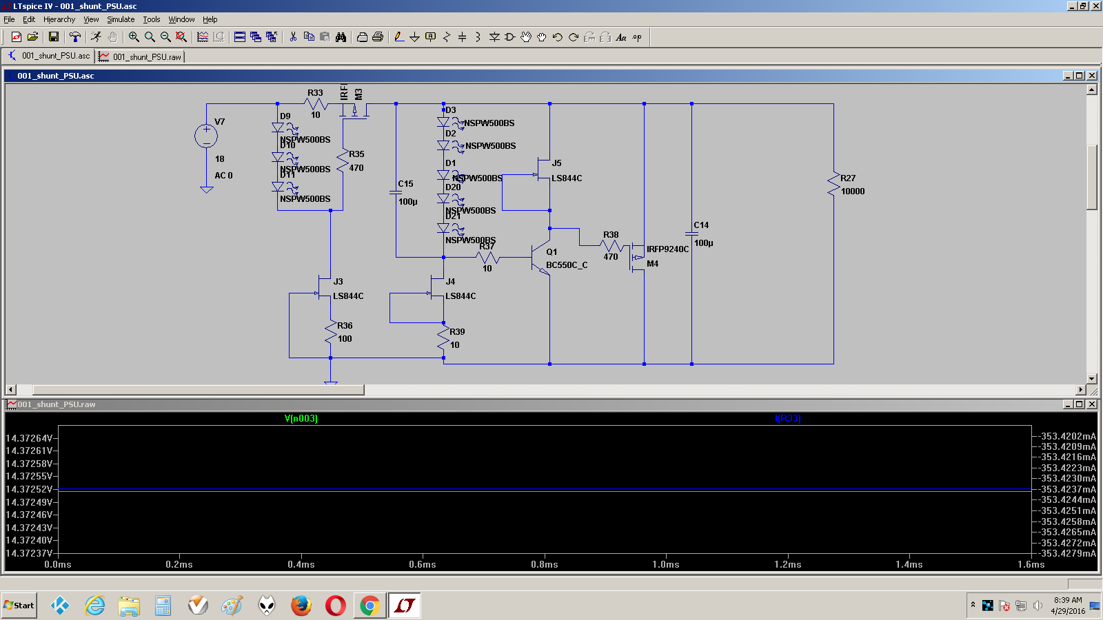

salas your reply on the other thread im copying here for discussion
Vrset=Vgs-Vf(3leds). Stays constant depending on the Vgs curve set point. If Vrset changes with input voltage then something is not working right in the CCS. The shunt part 5 Leds Vref is about 10V not 12V. If 12V maybe something is wrong there.

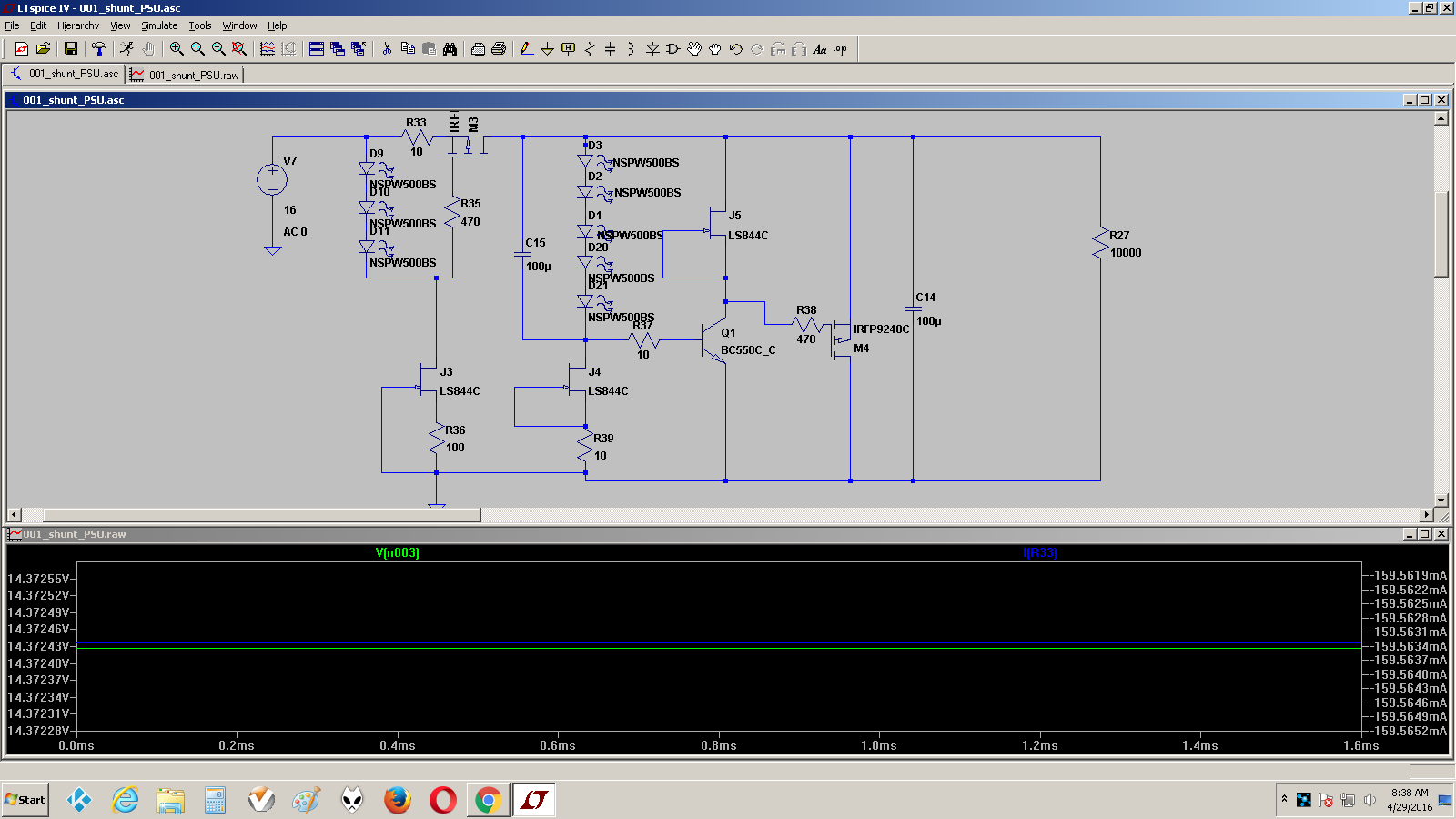

A quick sim in the LTspice you can see the current through the CSS resistor. Why is this happening?
the CCS must drop sufficient voltage to get the CCS into a good working range.
Remove all of the output side and test the CCS alone.
See how it performs for a range of input voltage from 1Vdc to 20Vdc.
As Andrew said already you need to exceed the recommended minimum Vin-Vout first so the CCS will stabilize. After that point there will be controlled voltage drop differences across the setting resistor possible values due to the Vgs curve vs Id as seen in any particular MOSFET's manual and little ones due to VDS and rising thermals. In your example the first input voltage is insufficient, that is why you see a marked difference when applying that second still short but more appropriate input voltage.

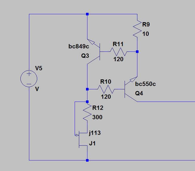

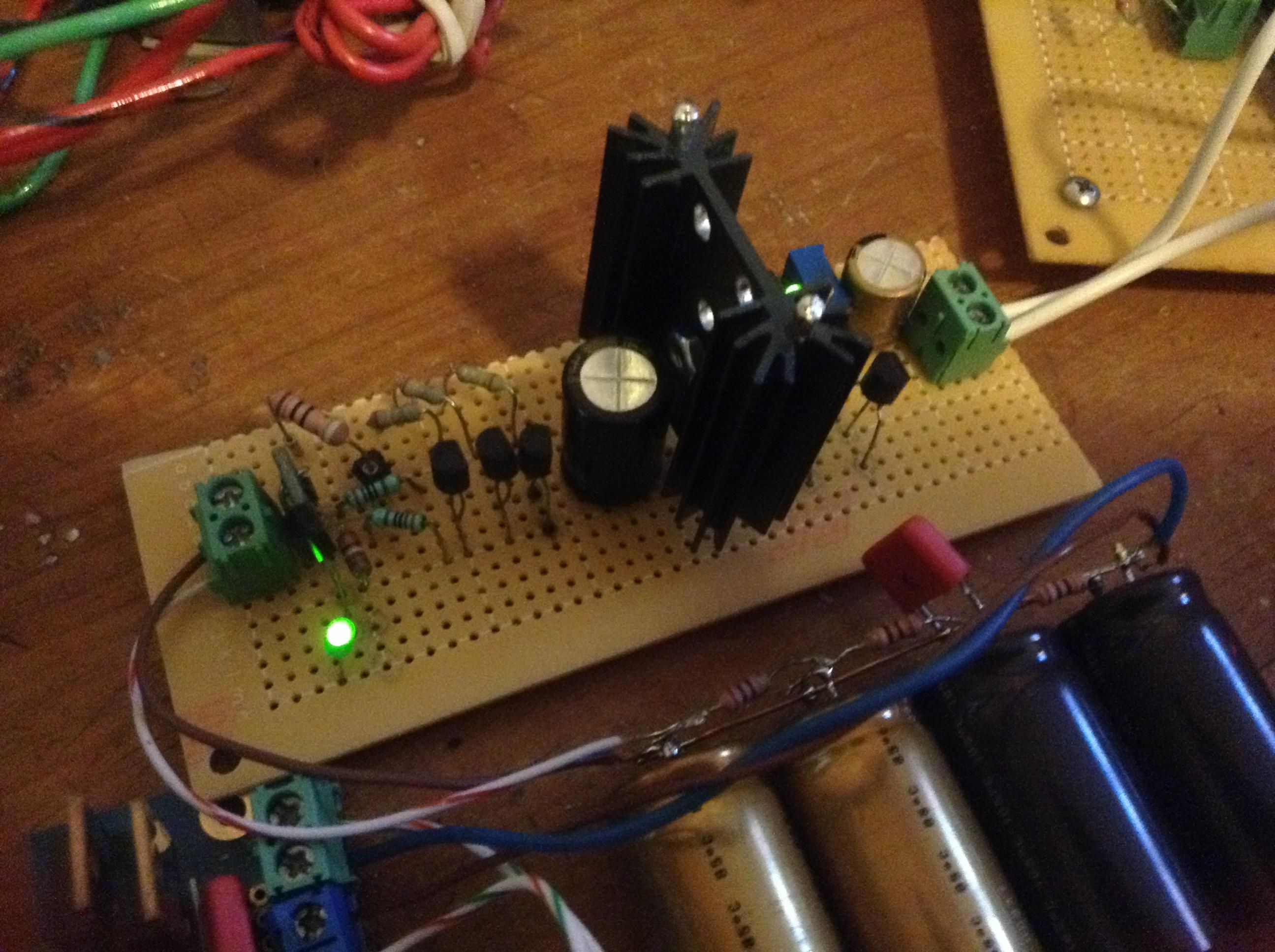

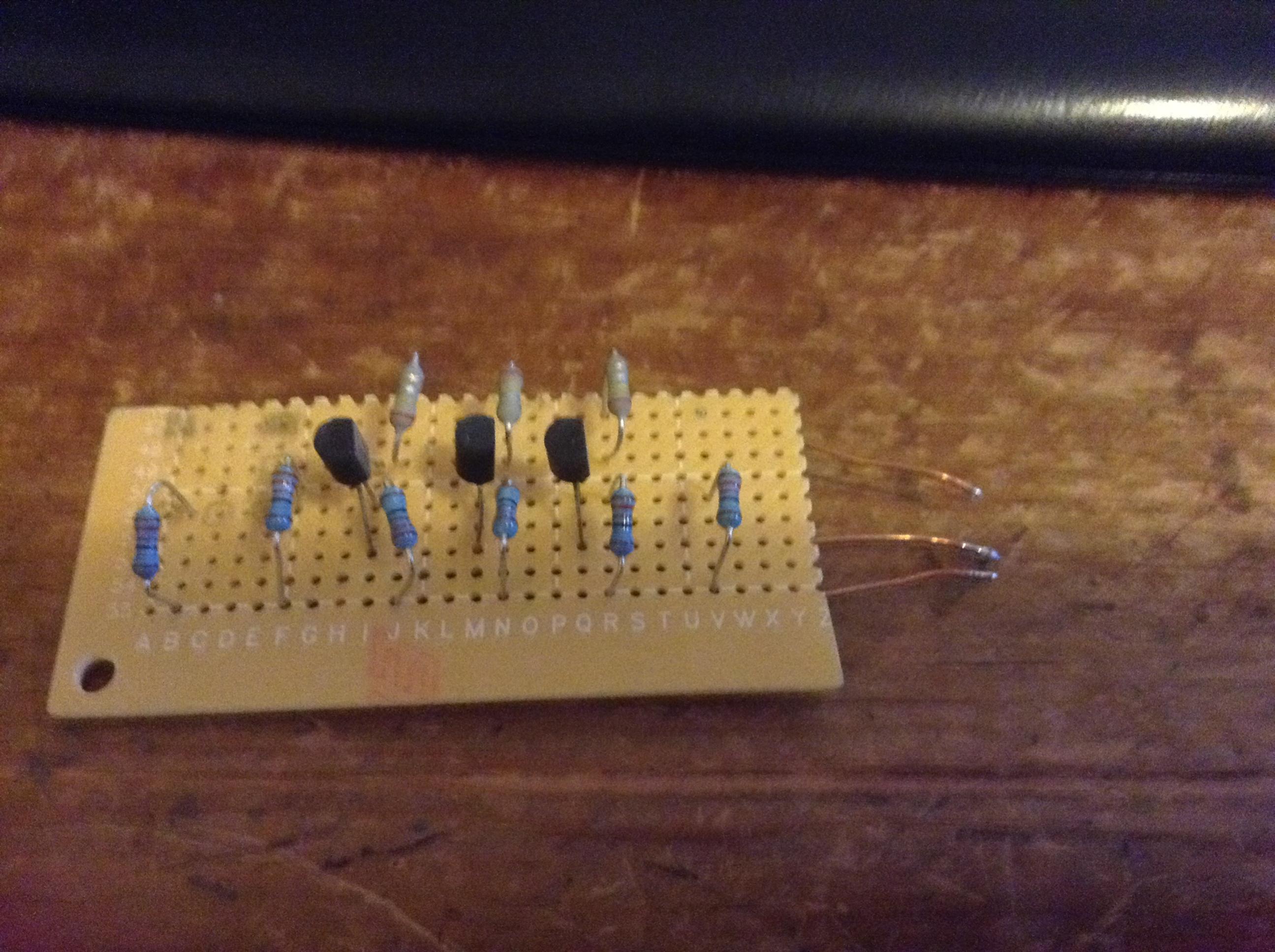

hi,
i would like to share my experience concerning a CCS setup i found particurlarly good in a Salas reg that is powering a DAC analog side, but it should also be suitable for any low current applications , whithin power and voltage specs, of course.
it is not has quite the "drive" of the irfp240 cascode soundwise, but if you don't need a lot of current, i found paralleling bc550c to give the "most for my money". The highs sounding more realistic and defined could be a an appropriate description of the benefit.
First, i tried paralleling six on a "card"(see picture), but it just wouldn't work because of oscillations.
The i placed 1 then 2 and now 3 in parallel on a tighter layout and it works fine up to now...
Bc849 a/b/c (or mmbt4401, which i plan to try) is pretty much recommended for Q3 because they perform better at lower Vce.
It is questionnable whether to-92 devices can take some wattage, so not to be forced to parallel too much devices, but if you want to push them, i had a good experience with glueing them with epoxy inside a standoff ( see picture). I would say that way they can withstand 1W attached to a bigger sink. If you sand-off the back of the t0-92 device plastic to make it look like a rectangle and epoxy it in a rectangle shaped hole that will minimize the distance between the die and the heatsink metal, than i would say maybe 1.5W can be applied safely (YMMV).
Also, 2n5457 gave me better better "drive", but sound a tad bit more noisier, so i keep them for when noise is not an absolute necessity in my setup. Right now i'm waiting for some 2sk246 to test also.
edit: shown is a negative ccs, which requires a transformer of it's own to work ( reverse reg). I have not tried a positive version, but it is possible that pnp bjt's will perform a tad bit worse.
edit 2: voltage source is reversed in the attached schematic!

Small BJTs can be nice indeed where applicable power wise but try faster MOSFET types too when able like IRF9610/610 or DN2540 cascodes.
