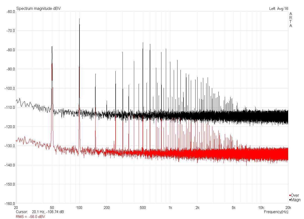

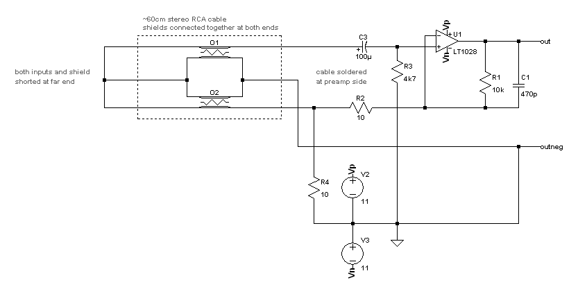

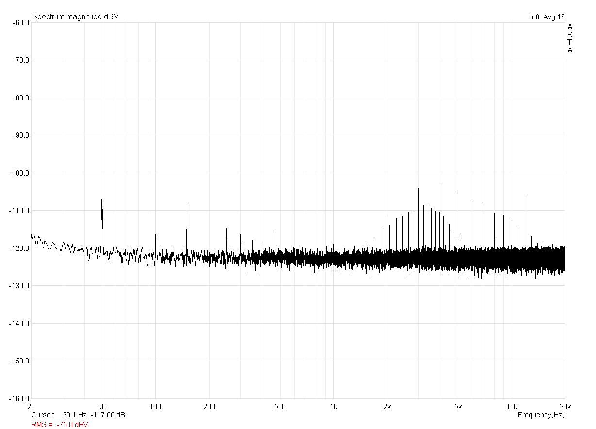

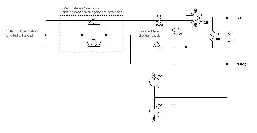

Not sure if anybody is still listening, but this is is what I just tried out of curiosity, lacking a decent balanced interconnect at the moment. Overall noise performance got worse by almost 20dB and I have no idea what might be the cause, except for the resistance of two feet of RCA interconnect cable. 😕

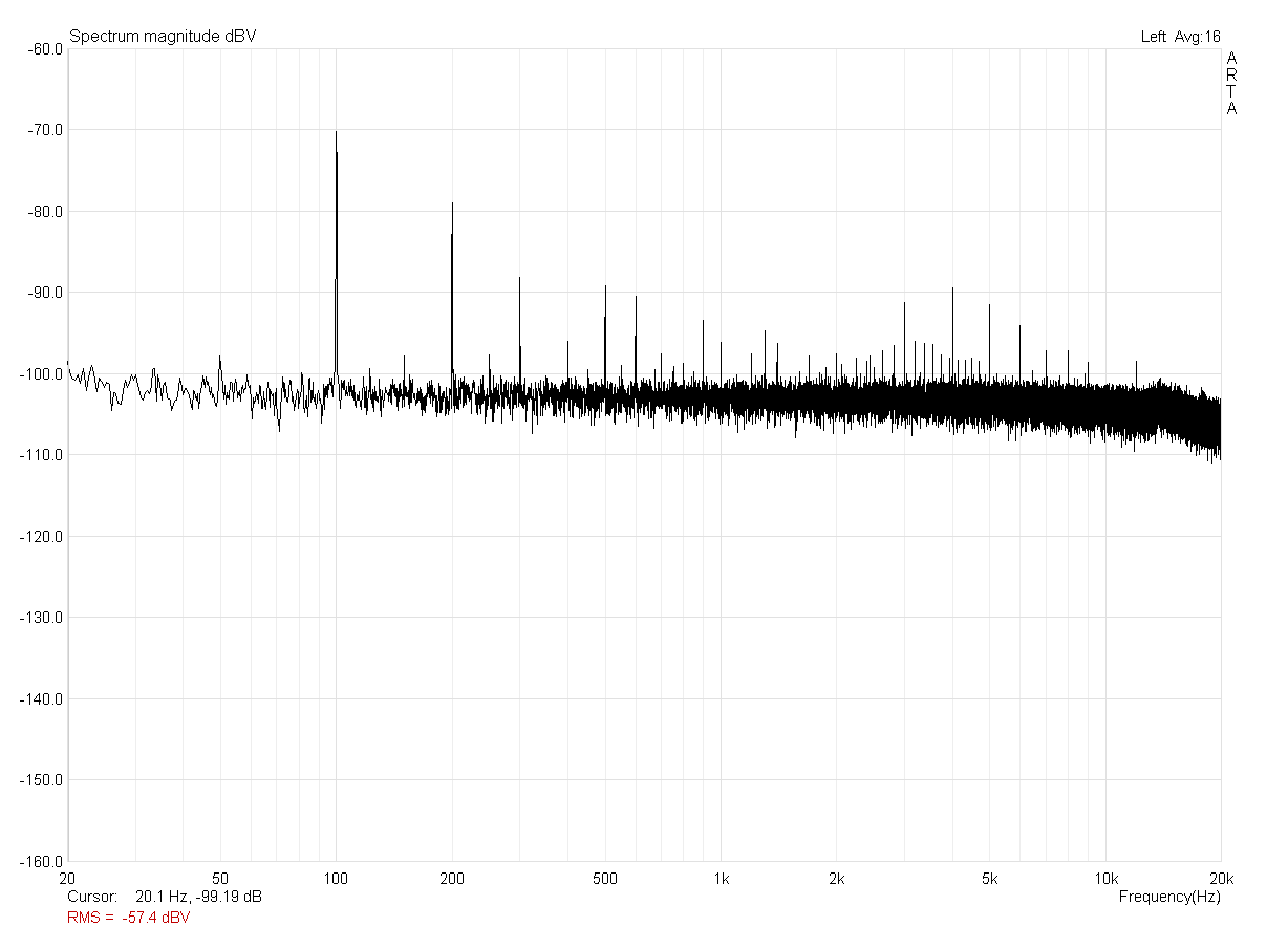

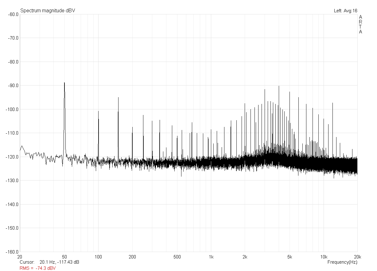

There was some ringing going on. I could not see any on the output with my 20MHz scope at 5mV/Div., but on the supply lines of the LT1028 was something to be seen. It was roughly on the order of 5mVpp at around 25MHz and I could not get rid of it by adding or removing bypass capacitors at the opamp. The only thing that made the ringing disappear completely was either to a) reduce the power supply to +- 5V or lower or b) remove the capacitors over the feedback resistors! I had removed the one for the 60dB setting first and was thus able to switch the ringing on and off with the 40/60dB switch.

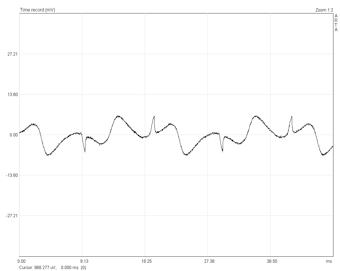

So now I have removed those caps the ringing is gone, but the collected noise of the input cable is still there. Most of that noise in the kHz range seems to come out of my computer, since it increases a little when I put the shorted input cable closer to the pc. On the other hand 50Hz is excessive when I put the cable above my lab psu (see waveform).
It seems to me the only thing I can do to reduce the noise pickup further is to increase the distance between [DUT and preamp] to the pc and the psu (or use battery power). What interests me the most at the moment is to know how an instrumentation amp would perform under this circumstances.
I have yet to try to replace R4 with a capacitor, albeit the difference between R4 in circuit or out of circuit is almost non-existent anymore, now that the ringing is gone.

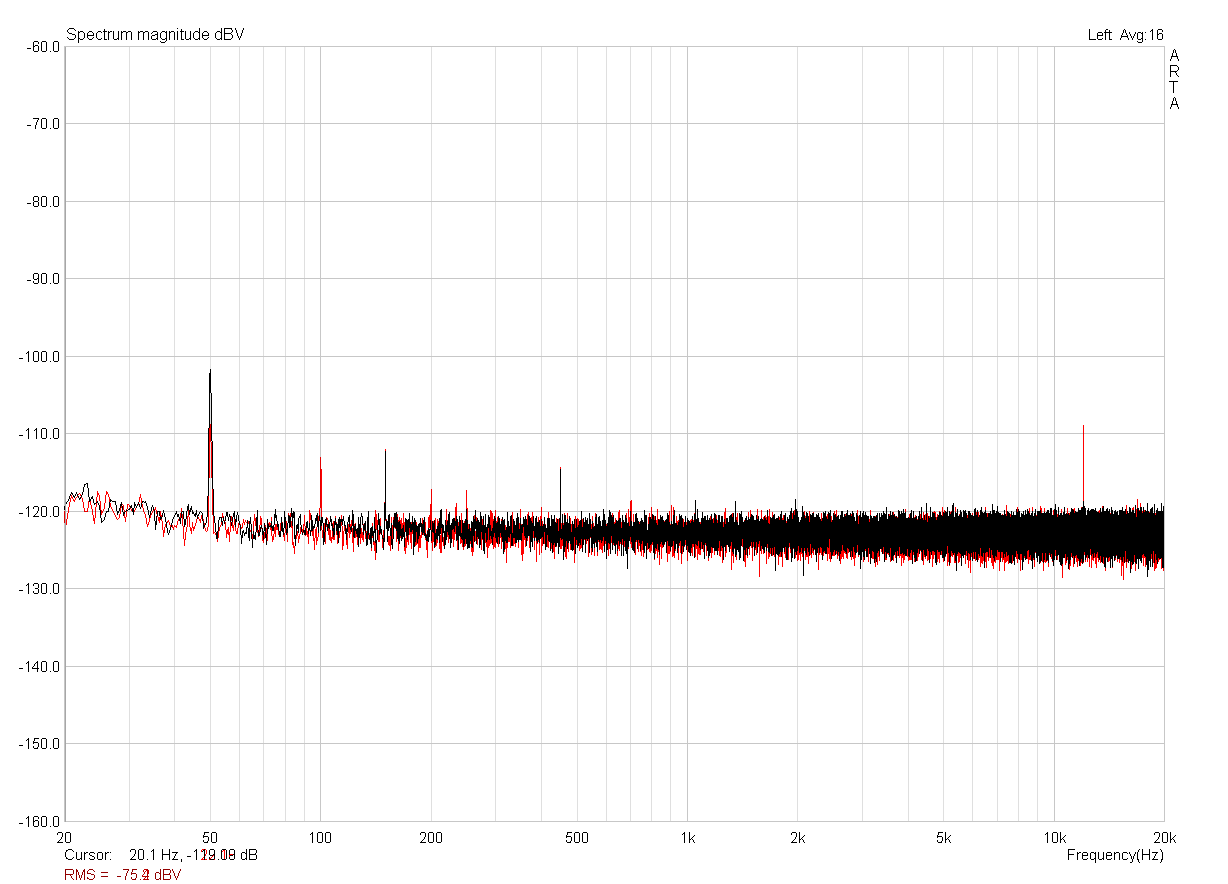

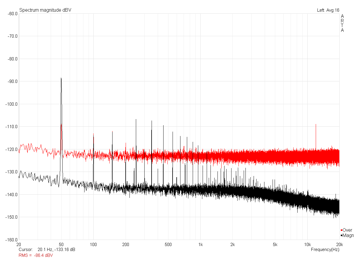

This is about as good as it gets when putting the preamp with shorted input cable (no DUT connected) as far away from pc and psu as cable length permits. Black trace with lab psu and red trace with battery power. I could almost live with that, but I suspect the noise to increase considerably again as soon as the (mains powered) DUT is connected and powered up.

This is what I get when I connect the DUT and fire it up. 50Hz is increased by 20dB (kinda like I suggested), but the noise floor is decreased by 15dB and more! Can the output impedance of the dut be that much lower than the shorted measurement cable alone?
Edit: There must have something went wrong. The second image shows the running DUT with 40dB and 60dB preamp gain (on the same scale). This looks much more realistic.
