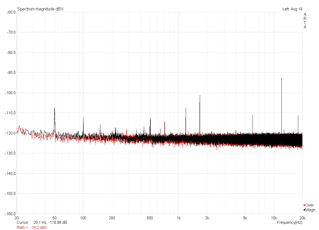

The new LT1028 arrived today. Popped it in and.... nothing changed 🙁.
Seems like the first one pretty much survived all the abuse 😕
Here's what I did: after unsoldering the old opamp I fitted a socket for easy replacement. To protect the inputs I added two anti-parallel diodes each from pins 2 and 3 to ground. Replaced the two back-to-back electrolytics input cap with a 100uF/100V bipolar one. Shorted the input, put in the new opamp, shut the case, applied power, checked for 0V at the output with DMM, connected output to soundcard and did the measurement.
Red: Old opamp in socket
Black: New opamp in socket
So until now the new opamp didn't see any current or voltage at its inputs except for their own offsets and performance is the same as before. Any thoughts?

protection diodes from supply rails to both inputs prevents the pair of inputs going much outside the supply rails.
Even better to create a pair of slightly lower (protection) supply rails so that the diodes give protection just inside the opamps supply rails. eg, mains supplies @ ±15Vdc
Protection rails at ±14Vdc
Diodes limit excursions to 14.6V, just less than the main rails.

Diodes to ground should limit excursion to ±0.6Vdc, which is plenty for noise testing. They also help shunting the big current spikes to ground that arise when you connect the DUT with 15Vdc to the input. But then again, it seems to me that the internal protection diodes managed that just as well, albeit the datasheet states that the input current shouldn't exceed 25mA.
Diodes between the +IN & -IN and diodes to prevent common mode going far beyond the rails are what is required.
And you need input resistors to limit the damage due to unexpected voltages.
Unfortunately these increase the noise.

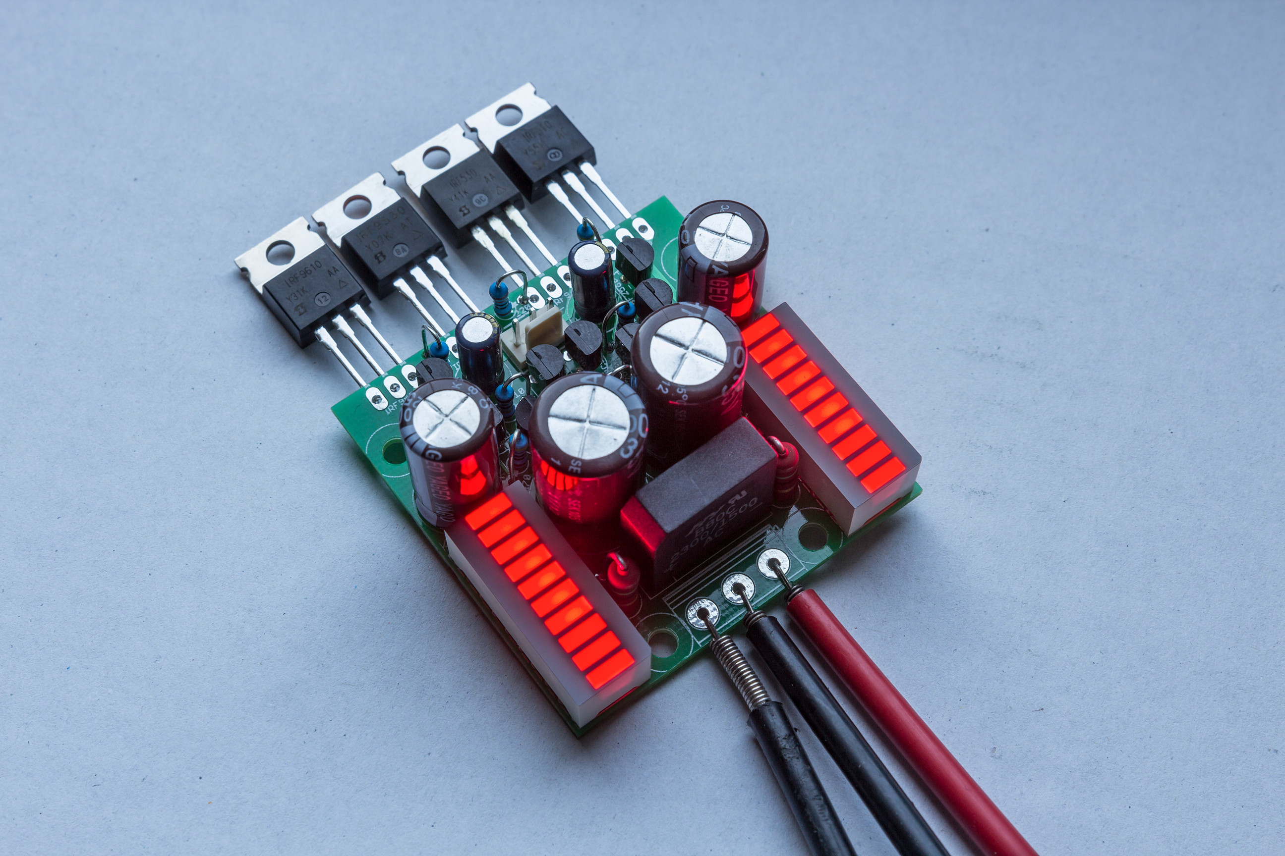

Boards arrived from China, here's the first working Low Current Dual Salas. Matching of the LED bargraphs is not that great (only ordered two), output voltages are around 12.1V and 12.5V. Little lower than I thought actually. Didn't check anything else than output voltage and total current consumption w/out load yet, but things look fine so far. Those graphs look absolutely gorgeous when applying power, because first only three LEDs each will light up and after a short delay the remaining 7 come on with a little fade-in 😎.
A looker indeed. Its their big noise filter capacitor coming up to ref voltage fade in effect. But it would take the addition of series small value rheostat trimmer(s) to ensure symmetry since we can't have exact total Vf by exchanging LED elements like people do in DCB1 etc. I got a couple of samples to use too when the opportunity comes and I saw they are near but never too near especially between two bars than for elements within a bar. There are situations where V+/V- total symmetry is not required though. Depends on the circuit the PSU is used for.Boards arrived from China, here's the first working Low Current Dual Salas. Matching of the LED bargraphs is not that great (only ordered two), output voltages are around 12.1V and 12.5V. Little lower than I thought actually. Didn't check anything else than output voltage and total current consumption w/out load yet, but things look fine so far. Those graphs look absolutely gorgeous when applying power, because first only three LEDs each will light up and after a short delay the remaining 7 come on with a little fade-in 😎.
P.S. Maybe you could bodge a resistor by hacking a via under the weaker array between two of its elements to bring it up to symmetry.
Bar is fine for not picking elements, solder all straight away, look good. But when not wanting trimmers too and still needing great symmetry then the bar can't deliver consistency.
