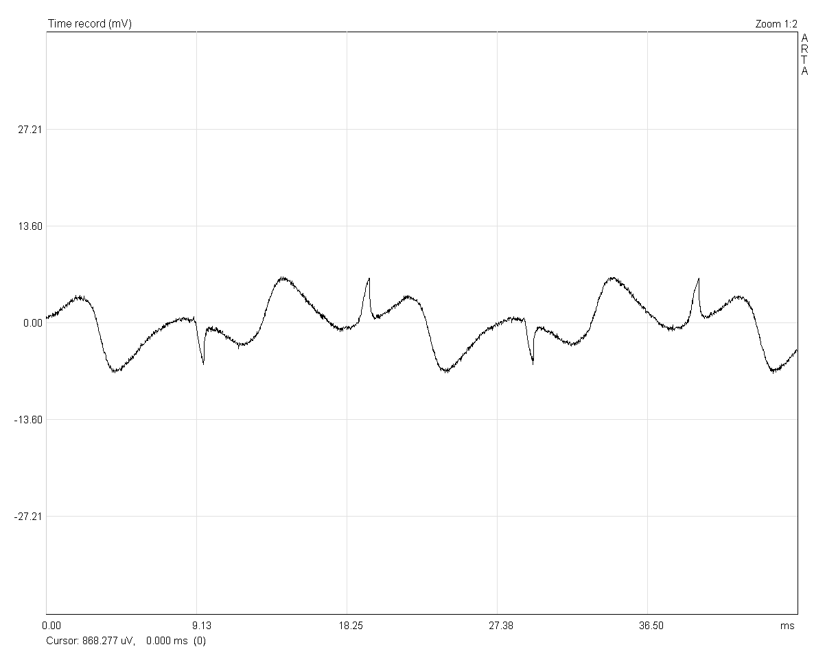

This is the waveform I get when I put the shorted measurement cable really close to the lab psu that powers the preamp.

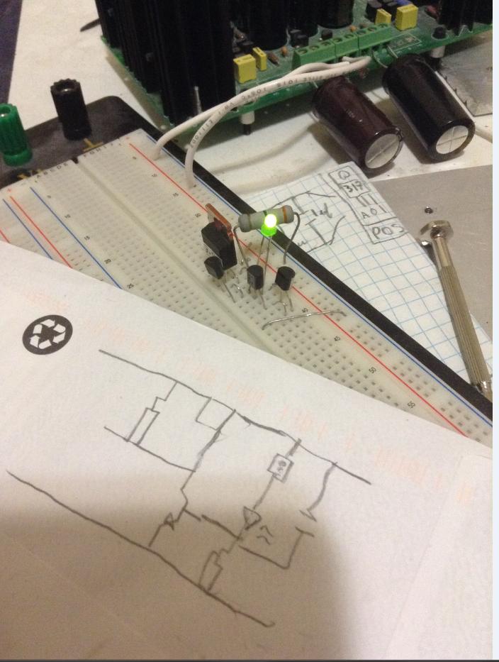

so far so good...nothing weird on the multimeter
no bypass capacitor nor pot (yes, that is a pot above the LED!) in there (contrary to what schematic shows, and no gate resistor)
next... solder to pcb(with pot, bypass cap,gate resistors)!
anything special i should be careful of before connecting to dac, if nothing weird is detected on multimeter?
Your schematic is not understandable, and your description makes it even more fuzzy. What do you mean gate resistor?
No short circuit protection. This can be a problem.
A scope is needed to check HF stability, however the basic topology is quite stable.
The DMM does not have the bandwidth or the sensitivity to catch MHZ mV level oscillation if there. When not having the proper test gear an AM portable radio brought near it can sometimes become noisy as an indication. Can still be OK on its own but the real dynamic load may set it off. Sure clue of such an anomaly if not evasive and erratic would be steady hum and buzz or weird sonic that wasn't there before when tested as PSU to an audio circuit. If all will sound well maybe its all really well on the other hand. Especially if the HF transients won't harden up. Don't use too high gatestopper value and fuse it's DC input on first test.
see a few pages earlier...i posted a schematic. the one on the pic is just to help me see if everything is connected the right way.
for short circuit, i thought of a resistor(10 ohm range) in line . i always use one when my psu has no current limit protection and i'm experimenting, like in this case. And i always fuse the AC line
i have access to a scope...not for now anyway.
I'll jusge to the ear and compare to other stable regs...
