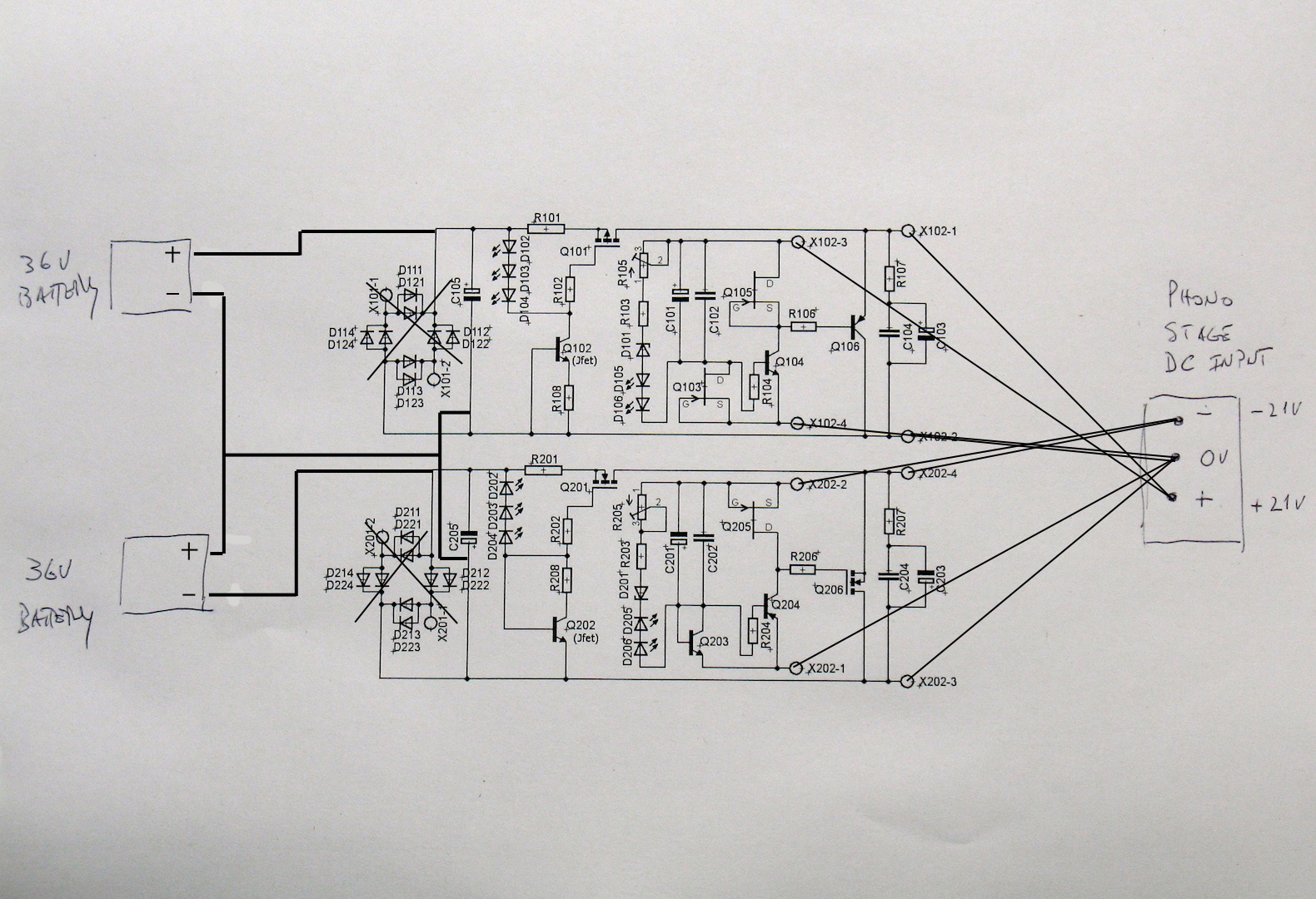

i accidentally put the op-amp in backwards in a 15+- shunt and the leds only came on for one side. when i corrected the opamp's orientation the circuit operated again but i wonder if something has been damaged. because though i don't know since when, the amp has developed a hum+ channel bleed.
Do other checks then. Use a DMM in AC mV and see if there is ripple in the rails.
If there is, check if something went out. The transistors and Mosfets in the regs must show about 0.6V VBE and about 4V VGS when they are OK.
