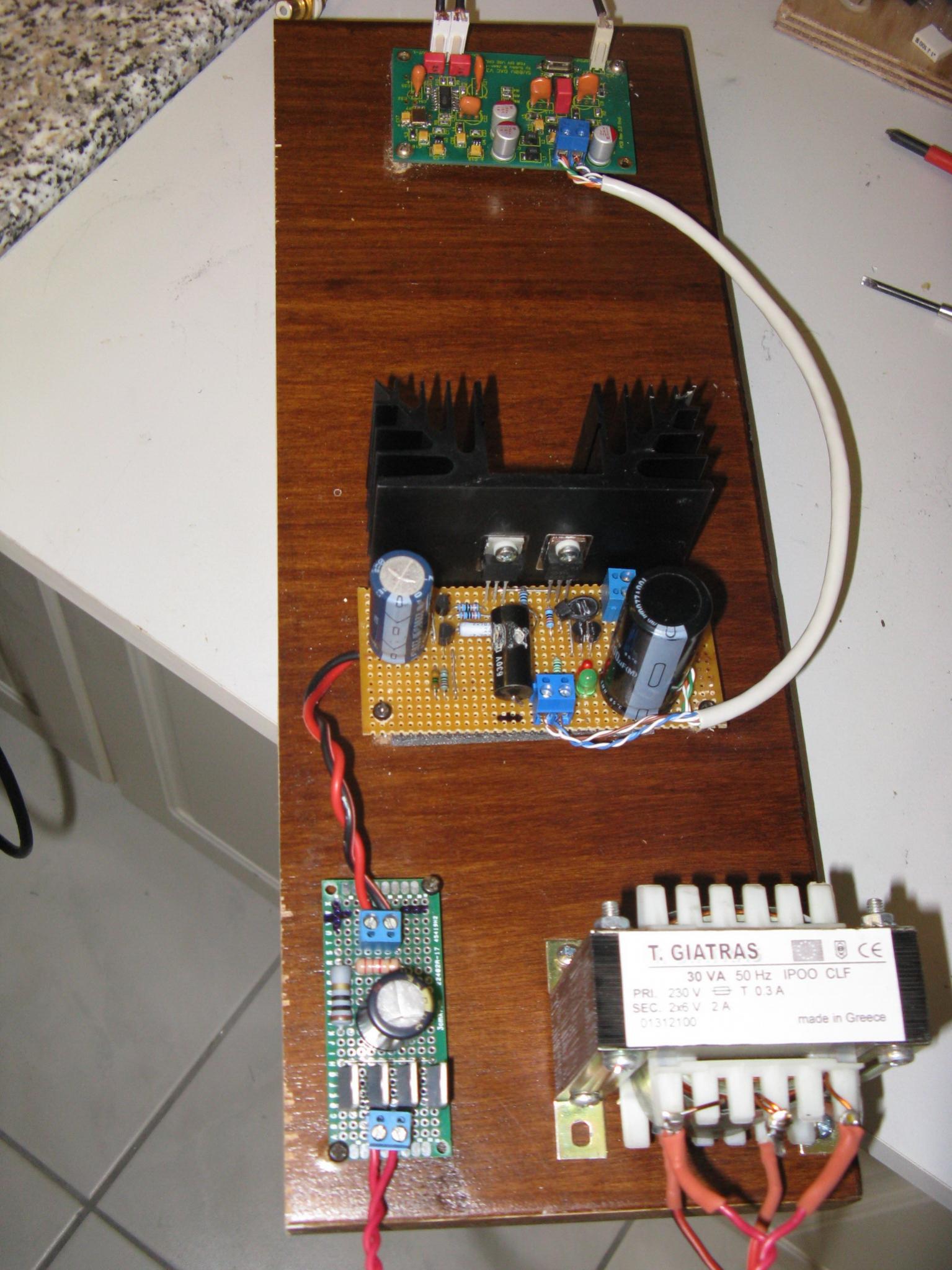

Used it to supply 5V to the excellent Subbu 9023 Dac from the GB here.
Used leds fro Vref, in order to have no drifts on the supply voltage, do not want to burn anything on the dac, as they are quite sensitive and really do not want to do any more SMD soldering for the time being!
Compared to an lm7805 regulator, the difference was huge. Bass was oveblown, sound was harsh and flat. With the reflektor, voices became natural, and sound had more detail, more depth and height. I didn' t expect such a difference.
Now waiting for a nice box to put everything inside.

No, I did not order the PS GB, because I already had 2 reflektors assembled and tested, and with all the favorites comments about them especially on digital, wanted to use them. I did this test only to compare and see if I get much difference, considering there are another 3 reg on board, and I did get more than I expected.
I also built the reflector to power the Subbu V2.6 Dac (older version) for quite some time. Recently I built a second reflector just for experiment of changes in parts. For 5V output, one green + one red LED is the simplistic clean VERF 🙂One more vote for the reflektor Salas🙂

Better than the LM7805 is an under statement, to my ears, even the LM723 based PSU deigned for the Dac is not as good 🙂
BTW, after an extensive listening time with my p2p Bib and Reflector, I conclude that the Reflector is my choice.
