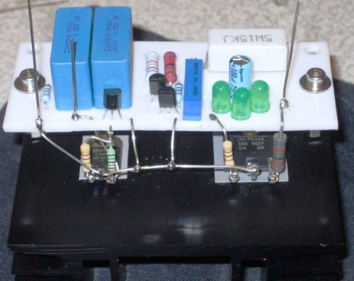

I use teflon for years now. Very easy to work with. I use those standard brown predrilled boards that you use to make the layout. I mark the holes with a pencil, attach the teflon sheet underneath and drill. The photo shows a guide for 4 shunts board 😉
Nice way to do it. P2P & Teflon, purest way I guess. I have seen it on your high voltage supply too. Thanks.

Andrew, it was this schematic that I was using at the time.
attachment.php
But instead of the irf840 I used irfpc60 and some other n-channel high voltage high power mosfets. It was the shunt mosfet (irfpc60) that usually got burned. Now I recall that it would often oscillate as well. It was probably just badly built by me.

The one under the Zener must work under BC550's Vbe. Thus its Vgs (off) must be under 0.7V. 2SK246 gives 0.7V as minimal. A solution would be to lift the Vbe to about 2.5V by using a 220R under BC550, emitter to ground. Assuming an Iccs load on its collector of about 8.5mA IDSS.

The shunt Mosfet dissipates less power the less the voltage across it, given the standard CCS current minus what goes to load consumption during start up as C2 charges. In a strong set current scenario, I would be more concerned about the CCS Mosfet which will have to endure more Voltage than final Vin-Vout and full current. The shunt Mosfet pops by oscillation IMO. I would remove C2, see if it does better, and then use a 0.22uF one or 0.33uF to see if it still holds. There is enough Johnson on a 82k we would not want to amplify, left totally unfiltered. Non the less all the working shunts made by now, do have C2 and don't pop. One thing we know is that no working example has been made beyond 100-120mA. Also he must play better safe than sorry and use safety Zeners across Mosfets. I don't use any bcs of no problems, and I avoid their self noise. But Iko suffered problems and must take precautions. Another thing that crosses my mind is what if the Zobel values are not good with the alternative than IRF840 Mosfets Iko uses, and what about any reaction from his amplifier used as load. As for things particular to Iko's test build, as possible culprits or not, naturally we can't know more.

Built one based on Iko's post #456 and hooked up to a Monica 3 DAC for burning in now. It works fine and the noise floor is at least as low as v1 that I built earlier.
That's cool! Any details on the parts used, sound tone change, etc.? BTW, I felt the other day like pushing the limit a bit, and used two mpsa18 instead of mpsa20, and darlingtoned the bd140 with a 2sa564 in front of it. Didn't use any compensation caps, and it was stable on some brutal loads. I measured half the ripple on sine wave load. Just something to keep in mind.
