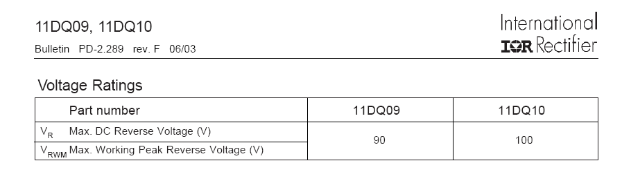

first look , two byv27/200 in short ,but are in place ..2A/200v diode!! (caps are small 1000mf and 1000mf on out shunt)
I go to bench for serius test 🙁
I have 11dq10
I have 11dq10
trafo ok ,is a bvy27 that lakage under load ,on static is ok , with no load the raw psu burn 700ma fuse on one rail.....
11dq10 (I 1,1A)are ok?? dual bridge x channel
Yes, but obviously your bridges need sinking. Under the hood and constant current probably gave them a good hassle.
Also watch your reverse voltage to be adequately in spec. Schottky are generally low for that.
I am talking Vsecondary*2.82 + 50% line transient safety margin, you must have as PIV spec for your diodes. I.e. a 150-200V PIV in your 40V secondary for full bridge. If your new diode is around 100 you will need 2 in series for each one of the bridge =8 pieces per bridge. Or simply another higher PIV part. What was the PIV of your previous model, failed diodes?
