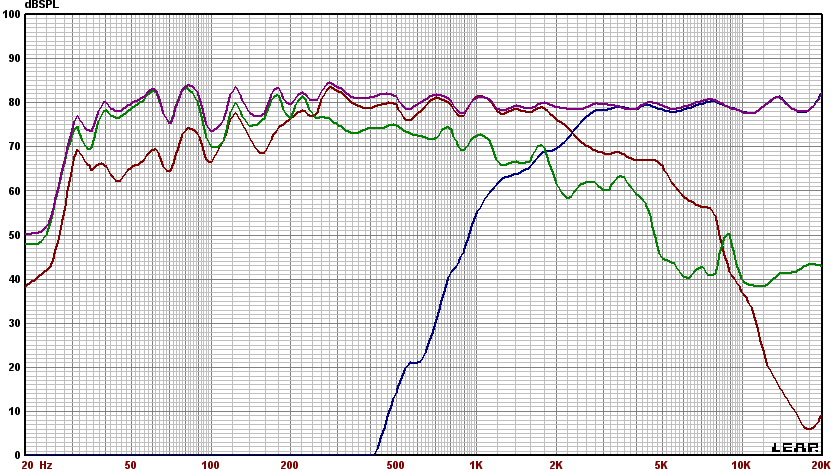

ikoflexer said:
Elsinore? :bigeyes: Yeah, but then I have to build a serious power amp. You see how one can end up like those guys in the video? Slippery slope isn't it? :D
Just a couple of Hypex ready made modules and you are done.;)

I saw the passive, did not like it. I prefer to have a processor because they will misbehave when going so low in less than huge rooms.
That little Jordan + Alcone 8 inch was a project for a friend, the drivers he bought and remain boxed and he is after gf, never made the cabinet. But I will get him sooner or later!:smash:
