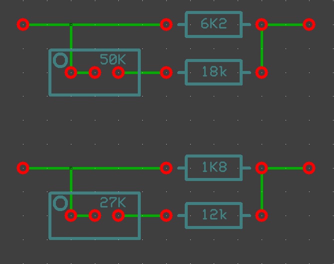

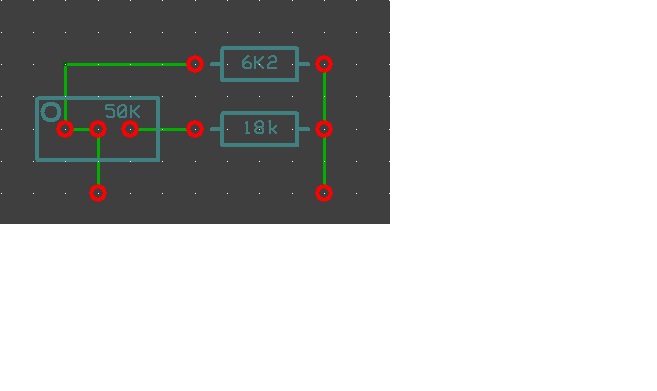

unconventional layout running the whole signal through the trimmer pot. Yes that works.
I would tap in the input and output at the 6k2 resistor. That way yhe major part of the current takes the shortest route through and passes that current through the higher quality fixed resistor. Only a tiny portion of the current passes through the trimmer.

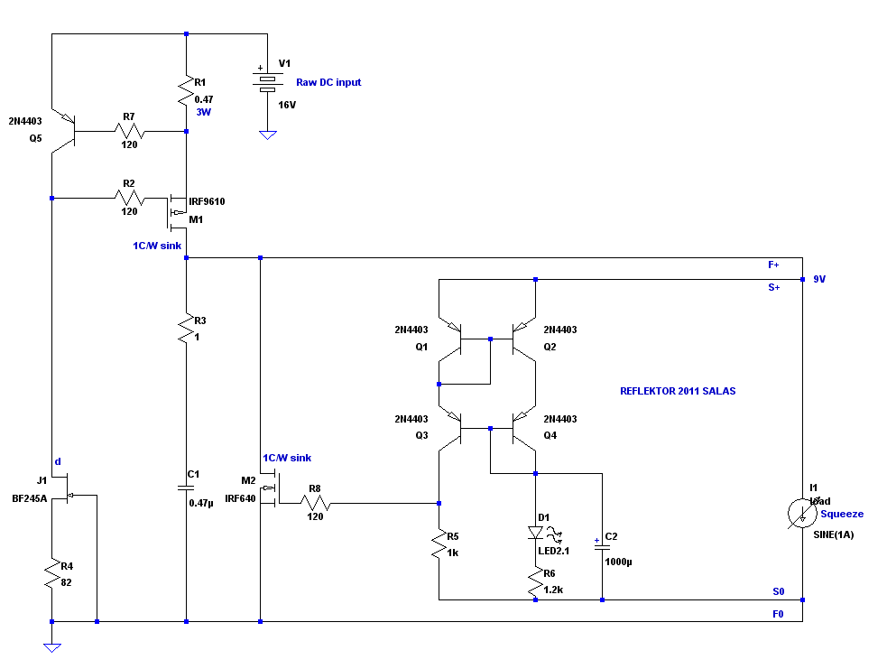

I want to improve and build a new power supply to my Squeezebox Duet. The need is 9 volts. The need for current is unknown, but I expect that we do not talk about A, but mA.

To avoid having to "hunt me up" a post that describes a solution to my needs, I ask for help to a BOM list of what components I should use to get the 9 V DC. The transformer I want to use is a 24VA with 2x12 V AC (connected in parallel).

Measure the current draw of the Duet using your multimeter with its stock power supply, you really want to know the real world current requirements to tune the Salas reg for ideal performance. A 12 VAC tranny should be fine for 9 VDC output.

Thanks for your reply. I could of course have followed the advice and measured power consumption from the existing power supply.
But Welborne Labs supplies a power supply designed for Sqeezbox Duet. Here is what they write about the need for power to the Duet:
What is the amperage rating of the supply? Our power supply can provide up to 3.5 amperes of current. I believe the Squeezebox 3 and Duet require 1 amp, earlier versions may have been spec'd 1.5 amps so our upgrade has plenty of headroom
As previously mentioned, I have a transformer of 24 VA and 2x12 V AC that I want to use. Theoreticaly I should be able to extract
2 A from the transformer, but I choose to go for 1.5 A. This will be a lot less than what the Welborne power supply (3,5 A) can give, but 1,5 A is good within what Welborne describes as what Sqeezbox needs.

The currents quoted (1A and 1.5A) are almost certainly peak current. These will be complicated and time consuming to measure/confirm.What is the amperage rating of the supply? Our power supply can provide up to 3.5 amperes of current. I believe the Squeezebox 3 and Duet require 1 amp, earlier versions may have been spec'd 1.5 amps............I have a transformer of 24 VA and 2x12 V AC that I want to use. ...........I should be able to extract
2 A from the transformer, but I choose to go for 1.5 A...........
Most amplifiers draw a continuous quiescent current (Iq) when the load is drawing zero current. When the load draws output current, this appears as extra current from either supply rail alternately (some -ve and some +ve) to give the AC output music signal.
If the duet meets this typical current demand then you cannot use a CCS Shunt Regulator unless you are prepared to set the CCS to some current greater than the maximum peak transient demand of the duet. this would be >=1.6Adc
A 24VA, 12+12Vac transformer can supply a continuous maximum AC current of 1Aac to a pair of 12r0 resistors.
When converted to DC using a capacitor input filter, the maximum continuous current is limited to ~500mAdc.
To allow the transformer to run cool, the average current should not exceed ~50% of the max DC current, i.e. <=~250mAdc.
This is well above the normal amplifier demands of a low bias ClassAB amplifier which may draw anywhere from 10mA to 100mA of quiescent current.

A CCS Shunt Regulator must pass more than the peak demand of the Duet.

I think here on the version referred to in # 226
Squeezebox is, as you describe Andrew, in no need for a continuous flow of 1.5 A. The transformer I refer to (24VA 2x12 V AC, connected in parallel, will not be able to deliver 1.5 A continuous)
I think that my needs will be well covered if someone can give me a BOM list to the version described in # 226 with the following would cover:
1. Transformer 12 V AC
2. Voltage out 9V DC
3. Current 1.5 A peak.

The Squeezebox Receiver (from the Duet) should not draw more than 560 mA (it's written below the box and on the wall wart 😉 ) I don;t want to open the box to confirm that, but I've measured the power draw at the mains side and it never exceeded 4 Watts in Wifi Mode. It's fairly constant in use, but with the LAN plugged in, it went up to 5 Watts at startup for a short time, so the 9V / 560mA max is confirmed.
I suppose setting the Reg to 600mA for the Duet should be enough (maybe even slightly less if you're concerned about heat since the 560mA is only temporary).
OK, I will see about #226 for ~700mA BOM to be on the safe side. In a couple of days if not sooner.

With the comments from Lazybutt, it appears that the most important parameters are in place to give Sqeezebox a new and better power than the one provided. Although I have not got the idea to study what was written on the back of the accompanying wall wort
Thank you Salas you for taking the time to create a BOM list.
