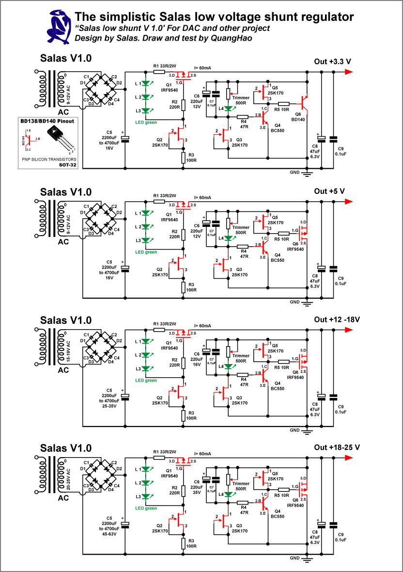

I don't know from schematics and layouts that I did not personally issue. There could be corrections later on, whatever. Copy from my posts in this thread, and invest on a scope as soon as possible.
this is the schematic without the 0.1uf bypassing the 47uf.
anyway i will put the correct mosfets change the layout to make the cables shorter and use remotes and i hope i will be ok.
p.s.you are right i really need a scope.

Using a second 220r in paralel with the first 220r (R8) I got 110r for the shunt mosfet gate stopper.
Not only it is stable with the 0.047uF C1 but also the sound became much more "snappy".
A very good combination.
Now the Reflektor is a real "singer" and produces a better defined image than my revamped V1.

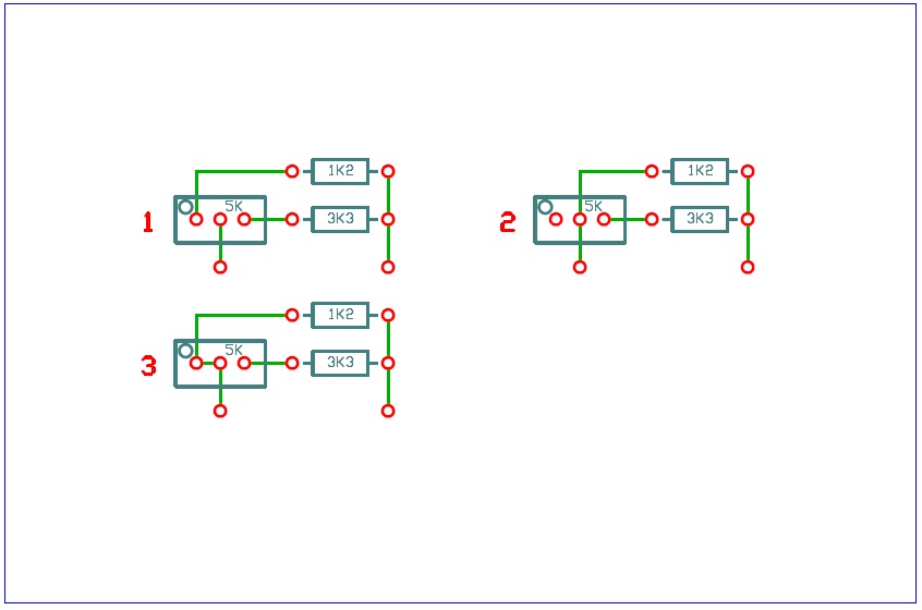

Are you referring to R6? To make it adjustable. choose a slightly larger value. Say 1k2.
Now find what value of parallel resistor reduces the combination down to the original 1k0.
Here it is 6k. If the trimmer is set to 6k then the existing 1k0 load is maintained.
Use a 5k VR + 3k3 as the series pair to parallel that 1k2.
At highest setting you have 1k2//8k3 for ~1k048 and at lowest setting you have 1k2//3k3 for 880r. If these asymmetric adjustment ranges are not suitable simply change the 3k3.
For a wider range of adjustment make the 1k2 larger. For a smaller range of adjustment use 1k1 instead of 1k0, along with a 10k VR.

The existing resistor is shown as 5k2.
To make this trim-able substitute a slightly larger fixed resistor.
One E24 higher is 5k6 and two E24 higher is 6k2.
Using the higher value of 6k2 will give a bigger range of adjustment.
We need to be able to trim 6k2 down to 5k2 to get back to the original voltage setting.
The normal 2 resistors in parallel formula applies. Just re-arrange it to:-
required parallel resistor, R" = [final value, R * starting value, R'] / [R' - R] =R" = [5k2*6k2]/[6k2-5k2]=32k We would probably like the trimmer to be near midpoint when the 5k2 is set so we choose a VR ~twice that value, i.e. 64k. Use a 50k VR.
What is the lowest value you want to trim the resistance to? I'll guess at 90% of 5k2 or ~4k68
This becomes the final value R and R' still equals 6k2.
The trimmer resistor value in parallel with R' needs to be 6k2*4k68/6k2-4k68=19k1. Select the nearest value just below this, i.e. 18k. This becomes the fixed resistor in series with the VR.
We have 6k2//18K when VR is set to zero ohms and 6k2//[18k+50k] when VR is set to max ohms.
The range given by the trimmer is 4k61 to 5k68, or ~ 5k2 +9%-11%, pretty close to that +-10% target.
If you require a bigger range of adjustment choose more than 2 E24 values above the 5k2. If you require less range of adjustment choose just 1 E24 value higher.
You can fiddle about with the values all you like to get the final value and the range of values you need.
Note. Replace the 18k with 20k and rework the upper and lower trimmed resistances. Are they closer or further from the +-10% target I set for myself?
