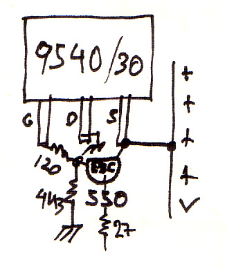

Make a schematic by following your build's connections, see if there is a mistake in the execution or in some value. Show it here too. Does it have a dummy load when measuring? Are the 2 Mosfets fully isolated? Gate stoppers really near to gates? R8 1K? 1.2R is easy to tame, lets debug. Nice and clean work by the way.
Salas,
I put a 100R 3W as the dummy load. Mosfets are fully isolated. Gate stopper is not far from the gate. (1~2cm maybe?) R8=1K. I even switched the 9540 to 9610. After all, it still oscillates! I will try to trace the connections and draw it on a paper. The circuit is based on this schema. I modified the layout, so that the space and length for 4.7uf pp is sufficient.
Use the proper film cap C3, we don't know the ESR of a 4u7 BG lytic there. Use 9530,40 Q5 not 9610. But 9610 Q1! Lower R6 to 2K2 when 5V app. Check around the Jfet cascode and the BJT driver Q6 for the output Mosfet that there are no pin reversals and connections are right.
I have built the circuits I posted in #3200. The 5V with 27K are only reported by others here. He can go 10K and see. I mostly suspect the 4.3K and the CCS practical implementation, the 4u7 lytic's ESR also (C3). IF Q1 is indeed 9540 as depicted in above schema, is highly suspect.

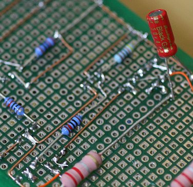

Hi Salas,
As for C3, I got 3.3uf Silmic 2, 4.7u OSCON and 4.7u BG N. The largest film I got is Rifa 450 1uf. Q1 is surely 9610 as you mentioned in other post. Last time, I tried 9540 for Q1 and it did not help. Follow your instruction, I tried 2.15K for R6(2*4.3k), vout becomes 3.85v oscillated and it can't be ajusted through VR!
Weird, orelli's works with 1k8 R6. Must be something layout practical that bugs. Q6 should be intimate to Q5. Is it? Try to have their +V pins junction physical point the same. Is that horizontal resistor the R5, and goes all the way long pins from Q6 to Q5, and R6 isn't at the emitter junction as it should but comes later, the one light blue with yellow band? Check and fix such details. Use the Rifa also.

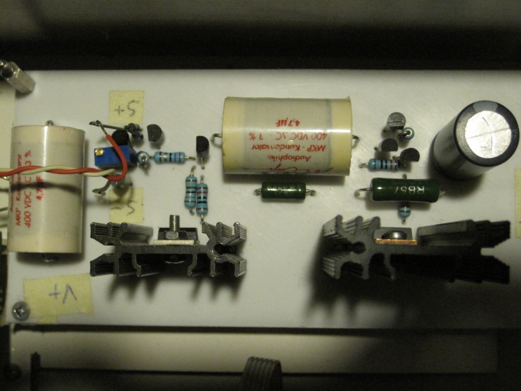

hi Salas, I agreed with you , the layout of Canvas maybe is the cause of oscillations. Too long are the resistor's leads; they can works like antennas and suck the very hi frequencies. I realized the 5V version 1.2r working on the layout that you posted on this thread. Sorry, I don't remember the nr post, but it was a dual type(v+ and V-), and it was black with the rails orange, and realized by a friend of you.It was a 1.2 version,not a revisited one.I hope you understood.

It would not play without strong stability problems if it was oscillating, especially if feeding analogue there is wide spread harmonic noise all over an FFT I.e. strong hum & buzz masking noise on the speakers, inescapable & equivalent to no go. Nice that you like it subjectively also. Congrats. Maybe you can post front and back pictures that may help others for constructing if you got a camera or a capable cellphone. Regards.
Hi Canvas
Make it tighter... I had the same issues and solved everything by making the smallest possible connections.
Can you draw your layout in a paper so we can follow the gnd connections too ?
Thanks for the advise. The reason for long trace is that I need to reserve the space for 2 4.7uf pps. Those caps are big and long, and I have limited space inside the chassis. I am still trying to label each pin on the graph. I will post it later.
Vout at left, Vin at right. Sense are the red-white twisted pair. The lytic is at the input (4700/16).

Looks like a Teflon board? Thanks for the pic. I believe the patterns are relative to what I posted right above. Given the chance, let me remind if there are long cables between the trafo-rectifiers-filter cap to the reg in (when with separate housings especially) a 100uF low ESR lytic from reg's DCin to GND locally to its input terminal or near enough is beneficial.
Correct, it's a 2mm thick teflon board. The pattern are relative at the #1898 post ; ok, this is a normal 1.2 v, but I deleted 33p and 1k and,changed the zobel and the film connected to +RS and K170, et voila', I get the "r" version.I think this attachment is very useful cause there are the holes that simplify very much the work. Before I populate a holed board,then I marked with a red pencil the holes with components and finally I put the holed board upon
