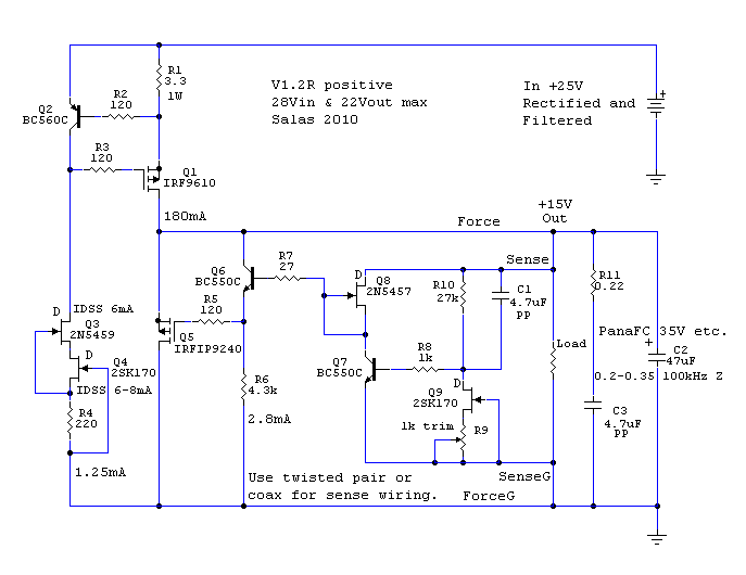

Hi. The border margins you saw are Vgs related limits. Its good you allowed for some 2V more for mains margin and ripple. Some with more varying mains would be safer at 12V input. JFET or BJT cascode CCT? R10 value? What you had in ithis reg's place before and did you feel any difference? Pictures are welcome.
Sorry , what's CCT?
I,m using your schematic showed in post 3200 (+15Vout) with some changes;
R1=1R
Q5=IRF9530
Q8=K170BL
R6=1k8
R10=26k5(2x13k2 serie)
Rload=12R
all the rest is the same.
ciao, Orazio
Hi. CCT means CirCuiT. So you used the one that has Jfet cascode to its left side, with 10V in and 5V out. IRF9530 is not a bad choice, has good reverse capacitance for its transcoductance. Did you put it to the audio test at all by now?

I read somwehere that you've mentioned the BJT CCS is equal to the performance of the jfet cascode CCS. Since the 2N5459 is hard to find, is the BJT CCS shown at post#3799 workable for 5V or 3.3V out?
Can you find J110 or BF245B? Any low noise NJfet > 2V VGS(OFF) > 6ma IDSS. The BJT cascode is equal in PSRR, you should use less than 1K for its resistors when working near 5V so there is Vdrop space for correct current in the LED (near 5mA to reach Vf nom). The way the CCS is arranged it drops one Vbe on R1 and the cascode sees ((Vin-Vbe)-VgsQ1)-VR4. See your Vin will allow at least 3V across the BJT cascode to GND not to totally squeeze it.
Hi Salas,
Is it better to use for 5Volt output R6 2K2 and R10 15K ?
Best regards.
Yes. Or R10 27K and 5K trimmer. Better filtering from the 4u7 that way.

What current do you assume to be passing the jFET Q9?Yes. Or R10 27K and 5K trimmer. Better filtering from the 4u7 that way.
27k for a 5V output sounds mad ! That would require q9 current ~160uA
I would expect a 1k trimmer (Vr for R10) to be about right for 5V output.
R6 is designed to have 2.8mA passing. That determines the required resistor value.
guys when i reduce r1 to increase current voltage across it drops.
in one regulator i had to go r1=2.35ohm in order to reach 0.460/2.35= 195ma.
is it normal?
is it normal?
The Vgs of the CCS FET changes with current through it.
The datasheet shows this characteristic clearly.
If you change the current by changing the resistor then you have automatically changed the Vgs. The voltage across the resistor is LED Vref - Vgs - trace Vdrops.
It is far better to add a second resistor in parallel and remeasure the new voltage to calculate the new total current. If you have not hit your target simply swap the added resistor for another value from your resistor stock.

i did that and it worked fine.
i just woried if it was normal.
