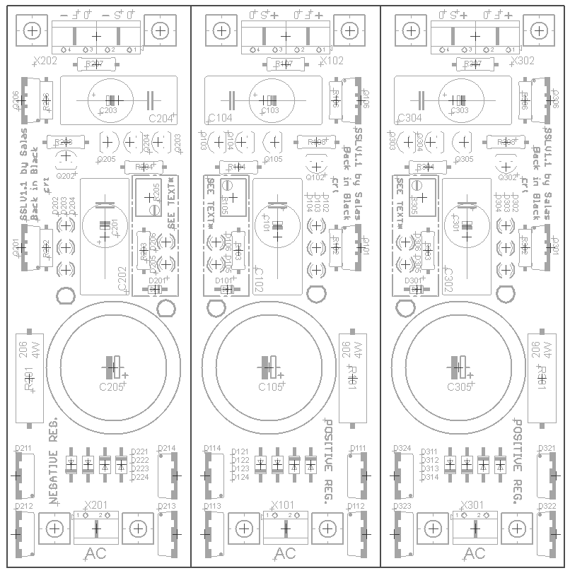

Maybe the keener of the thread participants remember a CRT's trial on a film caps using reg board I gave him a schematic for, called 1.1. Its a faster finer TO-220 remote sense only SSSR. It was integrated to a an I/V DAC of his with excellent results, had shown a picture once here. We recently cooperated in much consultation so to produce a test board in double layer plated through thick profile & heavy copper. We finished just yesterday including all Vref and hot rod features I integrated, 2 samples had been ordered from fab house in fool tooling expense and best quality between Tea Bag and me. Since the colour will be black I nicknamed the layout BackInBlack.😀 To commemorate our first Hypno & Mez in black and to continue in the Rock themed names vein. I will test and refine, will scope and listen, and if I feel its good I will write a full instructions and BOM PDF for it. Then it can be released for GB if Tea Bag wants to undertake it so to have an available PCB in best quality, with enough communication and reference documentation for all. Will let you know, will take some weeks only to get samples.

Can you anticipate the schematic?
If a PCB is going to be manufactured some day, two scoring lines will be welcomed by who might need one or two SSSR only (or want to use the three regs in different boxes)
P.S. Why the lefthand part is reversed? Negative side?

V scoring is already specified along the sections. There are two positive and one negative polarity sections. The final schematic and BOM will be defined after finishing.
It was time for that Salas!
It was a Crt's initiative push. He enjoyed his and was confident. Something with more resolution than V1.0 but along the lines of its practicality, not needing the learned fixes of 1.2R for each one voltage and current applications. And a more configurable Vref. An evolved classic SSSR in other words.

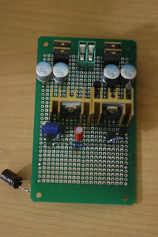

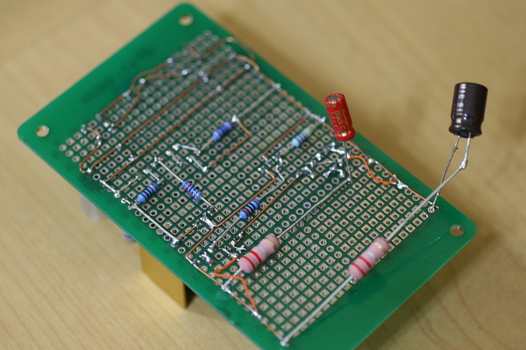

I finally build my first 1.2R 5V, but it just oscillates badly. To avoid low ESR, my C1 & C3 are BG NX 4.7uf/50V. C2 is Panasonic FM 47uf(Try Silmic too). I even put a 0.22R in series with C2, but no help at all. Vin=12V, R1=4.7R, Q1=IRF9610, Q5=IRF9540, Q3=2N5458 Idss 6.5ma, Q8=2SK170BL.
It oscillates at 15Mhz.

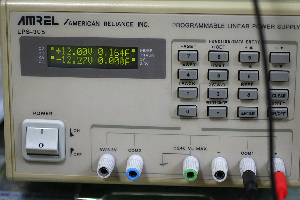

Vin is from my linear power supply. The current is 164ma with 12V in.
Vout is adjustable. Without a scope, it looks ok to me.
Front.
Rear. Orange wires are the sense cable.
Any suggestion?

Make a schematic by following your build's connections, see if there is a mistake in the execution or in some value. Show it here too. Does it have a dummy load when measuring? Are the 2 Mosfets fully isolated? Gate stoppers really near to gates? R8 1K? 1.2R is easy to tame, lets debug. Nice and clean work by the way.
I tried v1.2 with 9540 and was not working. Don' t remeber exactly what happened, but changed back to 9140 and everything was fine again. Mine was 52v in 43v out. I don' t remember somebody done v1.2 with 9540. Maybe the higher input capacitance?
