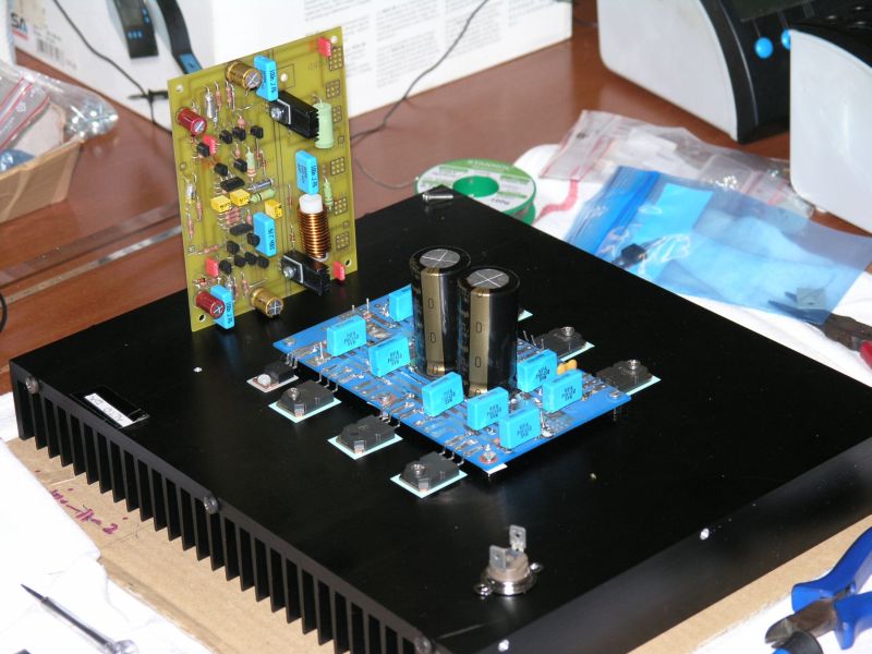

Uff ! search 100r , found 1k and 100r , put on the left and 1k on the rigth
mod the shunt , no works! led off , what resistor I have put in ?!!!
I hope later tonight the amp is done

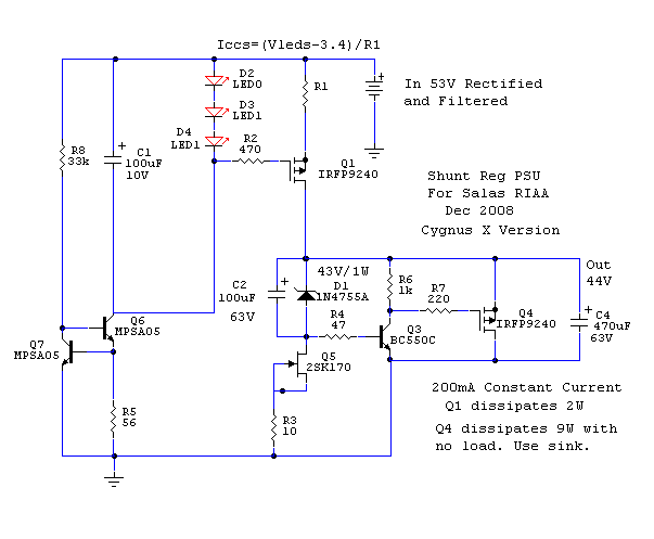

What are you trying to do with the 100R and 1k resistors? Which circuit are you talking about?
Nicoch, if you used 100R R6 then your respective BC550 is dead. Change it. If you used R5 1k, then the current through the LEDs is very low. Change it to 100R.
This is what he made, plus its negative in double mono. He ups the R5 so to avoid much heat on one MPSA05 due to having high enough DC in.
nicoch46 said:
Very neat! Keep us posted please.
Thanks salas!
Yes, I also see Q6 operating near the upper right limit of its SOA.
salas, why not do the R6 mod with the ring of mpsa05s (active load)?
