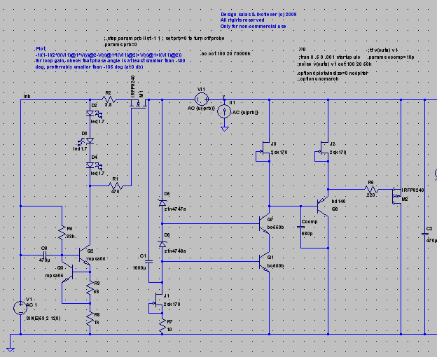

I see. Here's an idea. Adjust Ccomp for taste (i.e. until stable).

high bandwidth and stability
In the last little while there were several shunt regulator designs being worked on and I've seen people mention stability, but not many details about it. So lately I've been analyzing the stability of v1 and v2c, these two versions being the only two I am really interested at the moment. All analysis was done on the simulator. For v1 (R6 mod, LED bias) it seems that the circuit as is happens to be at the edge of stability. The calculated phase margin at unity gain was about 1 degree; to be somewhat sure that the circuit is stable (taking real world environment and component variations) designers try to get a phase margin of about 45 degrees. My personal experience was that there were times when I built v1 and it worked right away, stable, and then there were times when it oscillated, so the simulated stability analysis is in some correlation to reality. Considering various differences between components in the real world, this would happen. An significant increase in phase margin can be had by a small capacitor on C-B pins of the NPN driver transistor. In simulation an 18pF capacitor would bring the phase margin to 35 degree. This does not mean that you should use this value. I would take this result to mean that, all else being equal, if you build v1 and it oscillates, the first thing to try would be a small cap on the C-B pins of the BC550B. I would step up the value if still oscillating, up to about 300pF. If it still oscillates then it almost surely a different problem.
All the simulated outstanding output impedance results I have shown so far for v2c (the two stage amplifier with a cascode in the first stage) are without a significant frequency compensation. The results would look a bit less stellar with compensation. This is a very funny game played here, the more loop gain you have across the frequency spectrum, the more inherently unstable the circuit will become (the phase lags at high frequency and you get into negative phase margin). When you try to compensate (various ways) the loop gain decreases at high frequency and behold, the output impedance goes down big time. I realized that in order to maintain high loop gain AND stability one should be serious about wide bandwidth design. As far as I am concerned, for v2c, to make it keep its lower than v1 output impedance I could use bfrt92 and bfrp92 RF drivers with high frequency compensation (details left out). Is it worth it? For those who want to squeeze the very last bit of performance out of a circuit, perhaps. For most, you can be pretty sure that most people will not be able to do better then salas version 1. Am I 100% positive of all this? Nope. Please correct me if I'm wrong.
Any high speed amp designers around here to give some advice?
Its not necessarily wrong. The current source as a load brings the gm*load gain pretty high. I was worried for instability issues my self when we did that mod in the Riaa thread. In practice it worked for all people with gains in the highs, so no worries. The real components seem they can give a somewhat more margin than predicted, so if it works, its better to keep the gain up high. In a case (not reported yet) that there is persistent instability, the npn can be BC550B instead of C for instance, so to compromise the loop gain. Or use a comp cap between C,B of the driver, as you saw. Stacked ceramic I would suppose.
