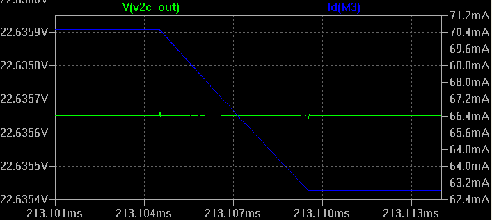

A few comments about v2c. In reality I used a 47pF Ccomp, and variable resistors: 1k Rcomp1, and 100R Rcomp2. Different current loads and/or Rset might require a different Ccomp, Rcomp1, and Rcomp2 values. It might be difficult for someone without an oscilloscope to set these. Even v1 oscillated on me having forgotten the output capacitor. I'll think about some sort of oscillation indicator for people that don't have a scope. Any idea?
R6, R7, and R16 are dummy resistor that were left behind from trying things in simulation. They don't exist in my prototype. Also, in the prototype I didn't use BC550B for Q1 and Q3, but a couple of 2SC828R salvaged from an old circuit, but I don't think that the BC550B would pose any problems. I used yellow LEDs, with a voltage drop of about 1.8V each.
A few things about the tests I ran; the results apply to v1 and v2c. A very simple setup using a 20k variable resistor, an IRFZ40, and a 4uF polypropylene capacitor was setup as the load. The variable resistor provided the bias for the mosfet as shown above in one of the pics. I tried various load currents, mostly between 40 and 125mA. On top of this current I overlayed a sine variable current by coupling my signal generator via the capacitor to the mosfet's gate. Tried RMS load currents between 20mA and 90mA. For instance, a 70mA RMS current caused a 200uV ripple at the output of the regulator. The regulator was fed by about 26VDC, with possibly 1V p-p ripple; was not very careful about filtering it. Unfortunately my ancient HP200C signal generator does not do more than 20kHz 😀 so I've tested the regulator up to that frequency. My scope's most sensitive setting is 100uV/cm. When the load was below 20mA AC, the output ripple was so small that I could not say what value it was, perhaps 30-40uV and smaller.

And since lineup mentioned psrr.
The transition response of v2c to a square wave load.
I would fix its compensation for say 150mA, which is ample for most non power circuits, and gives logical heat. Then if someone wants more, has got to be a bit hands on I guess. You tweaked it to V2 for the more demanding in bandwidth, and bandwidth leads to more practical considerations as always. The difference in output impedance is already under a threshold that the cabling and/or traces and connectors will dominate. Also some stray inductance can compromise the bandwidth, those going for V2 must plug it with pins on the load board for best results. The judgment call is if a circuit has the low PSRR beyond audio band, extension, and load swing to sound better with the V2 or not. And that is up to the user to decide in a particular system concept. Then there is the more components and stages thing. Buffering means another local loop for instance, maybe they sound different even on non demanding loads as well. But in some time by using them on your circuits with good resolution headphones you will be able to tell us. Good work. Congratulations once more.
