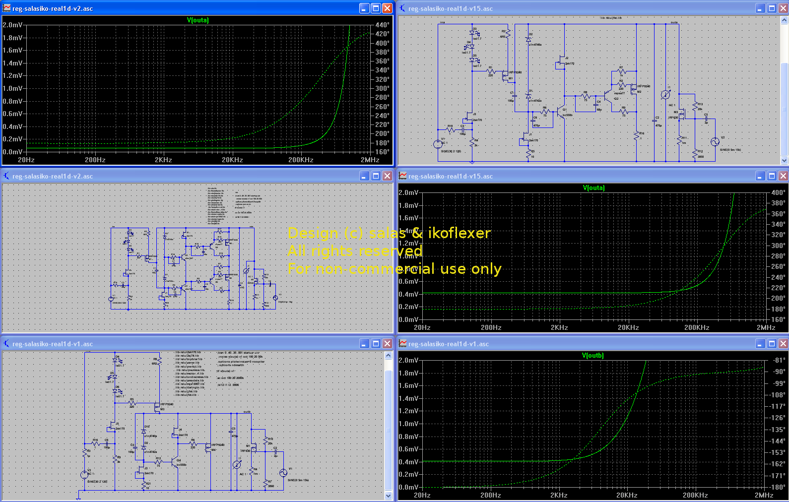

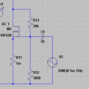

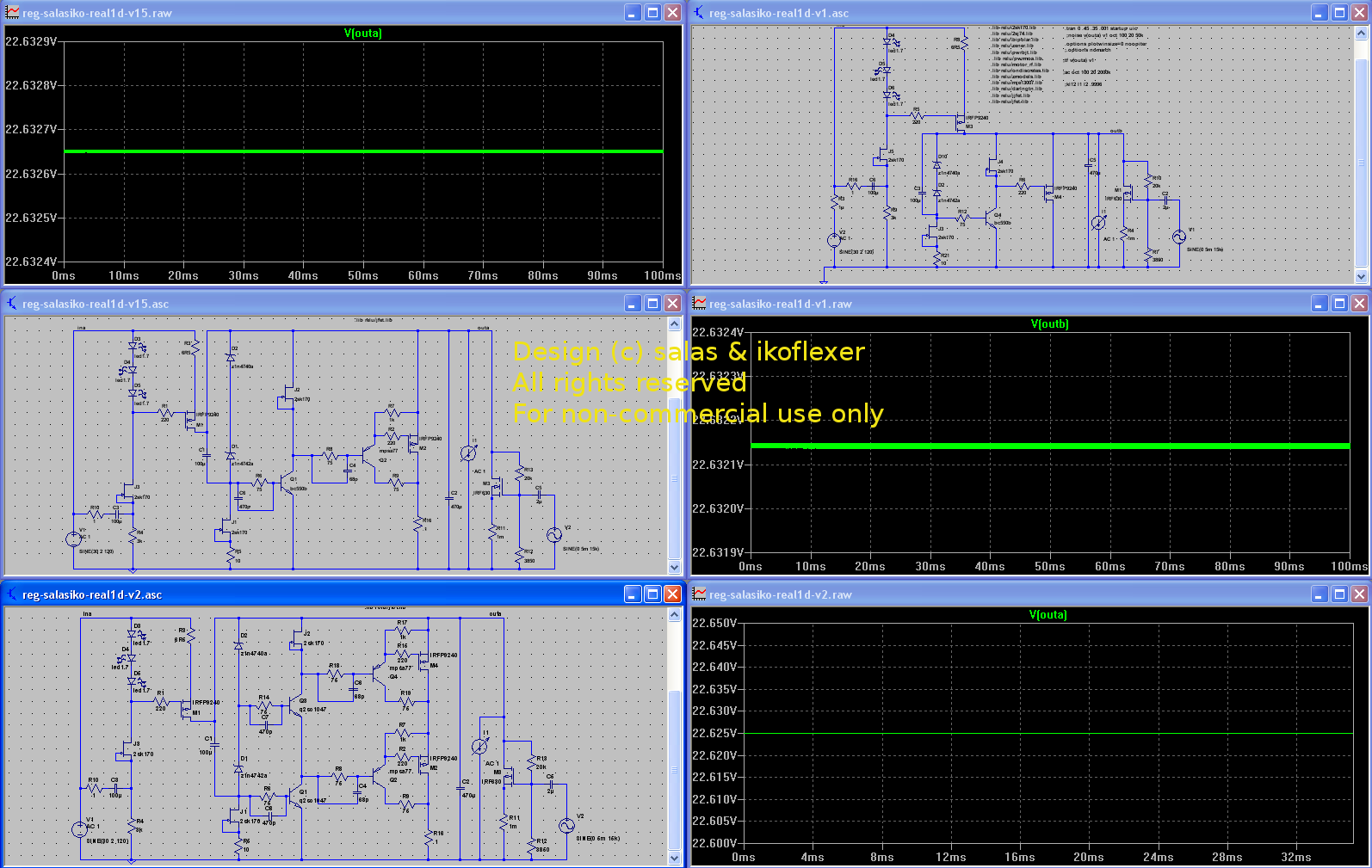

OK, so I'm thinking this will be the active load that I'll use to test load regulation (how stable the output voltage remains when a load draws a varying current). An irf630 mosfet biased via a voltage divider and fed through a coupling cap from a sine generator.
Simulating this sort of thing shows some interesting results for v1, v1.5, and v2.
In the simulation I set the bias so that the mosfet draws about 85mA DC. The sine generator adds a wiggly AC component of about 5mA at a frequency of 15kHz, towards the top range of audio frequency.
Click on the image to see it large.

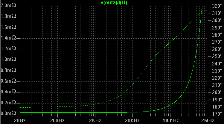

Edit: for fun, the output impedance of all three versions, tete-a-tete. Read the result in milliohms, not millivolts; I just didn't divide by the current, the numbers and curves are exactly the same. This shows that v1 is just excellent. v1.5 offers the same excellent performance on a wider bandwidth. v2 offers even lower output impedance on a wide bandwith.
I welcome comments/suggestions.

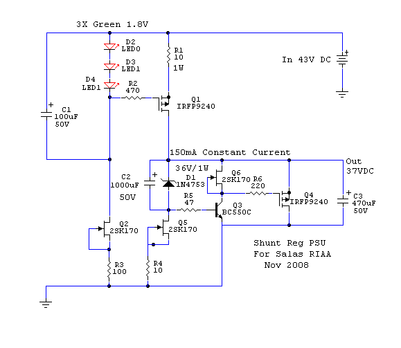

As you know I kept on recommending the LEDs version to p2p DIYers in many cases before, bcs even if little less capable for ripple rejection (not really that different in practice), I noticed that it was more non careful proof. Especially when probing. Yes I think its good to be there.
leds
Okay, Salas, Ikoflexor,   Leds, eh.   As per your Circuit for the RIAA in Nov last year? This is just adding the option of using 3 leds in place of Q2, R2?  That's straightforward - just add extra donuts for the 3 leds replacement for the R2, and then jumper the Q2 donuts  - perhaps something a little more refined?  Do you want to keep the  C1  reduce any noise that 3 leds in series generate?    And it's resistor, Rc?I'm "nutting out"  a rough layout for a +/- version with simple  Cmultipliers on the inputs for extra ripple reduction and lower Z - the Cmx is a very useful thing! [The G,D,S pins layouts suit IRP610 (9610), 2sj380, 2sk2391, etc.]

There is not a change really in simplistic V1. Its straightforward and can be made either with a Vbe or LED Vref for its main CCS. The PCB is already developed by James, and any layout additions will be posted here. Due to its low parts count it has already been made in P2P by many members since late 2008, its a tried and liked solution. The other version is the tweaked totem and extra buffer components deluxe one by Ikoflexer that gives ultimate bandwidth for what it is, and record low output impedance for what it can do. As for V1 I give you a typical LED example. The final circuit, pcb, and BOM for the V2 deluxe is under Iko's time table to be finalized and given.

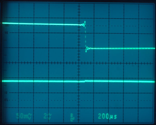

Yes they are. They aren't supposed to be in the IDSS loop to fix current values, as someone would normally expect. Current is IDSS and I want it full in those positions. They serve an obscure purpose. They lift the local sources from ground slightly, and that contributes to a better step response. See them as a kind of stoppers.
P.S. jwb once contributed a measurement for 25mA load step (top trace). Bottom trace is the reaction of the reg (V1 style).

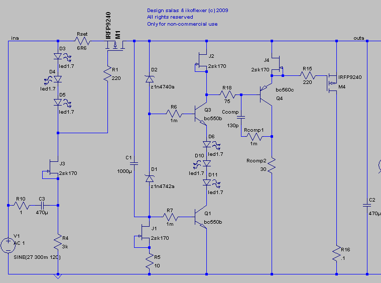

I put some effort in simplifying and improving v2. Hopefully this is my last(ish) version, ladies and gents, v2c.
I have built the prototype and it works. Check out the output impedance. Ripple rejection that comes along the input is as good as before. Stability is set via the high frequency compensation components Ccomp, Rcomp1, and Rcomp2.
In other news, I built a mosfet based active load and tested v1, v2, v1.5, v2c. For a phono preamp, which has very little if any varying load, v1 will be all that you need. It is a clean circuit and can't be beaten, IMHO. salas, I have to congratulate you for what is probably the best regulator from many points of view. There are many details and I have run extensive tests in the last few days, I said these things from that experience.
Some people might want wide bandwidth low output impedance, and I put a lot of effort into coming up with something that would do that. v2c is the latest result that addresses that, and it is not only simulation, I have actually built it in tested it.
And please, would anybody comment, can it be improved? Anything looking wrong?
diyAudio Chief Moderator
Joined 2002
Does not look to have something wrong to me. I see that you got it simpler than before and that is only good. Its only that the compensation values must be finalized for a given pcb. To retain the extra performance with reliability, its layout, BOM, and compensation must be carved in stone. Of course V1 is the low parts count workhorse that can tolerate much for layout and components, and should be OK for most applications, but this V2 deluxe can prove its worth in driver situations or headphone preamps where there will be a lot of swing, since its buffered among other things. Or be the perfectionist's choice. Just that. Congratulations.:)
