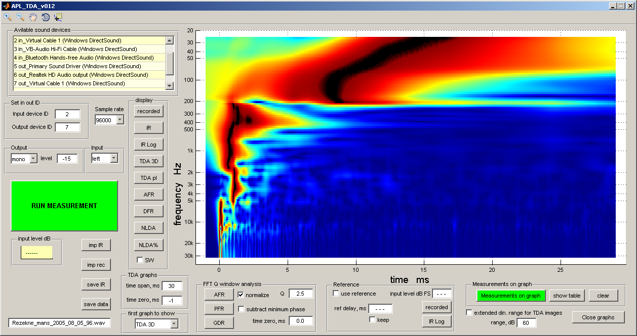

Another two channels of Motu will be dispayed as some two channel "device" in the TDA`s device list. All devices listed are 2 channel devices and the "choise" left or right will direct to respective channel.
Please take a look:
attachment.php

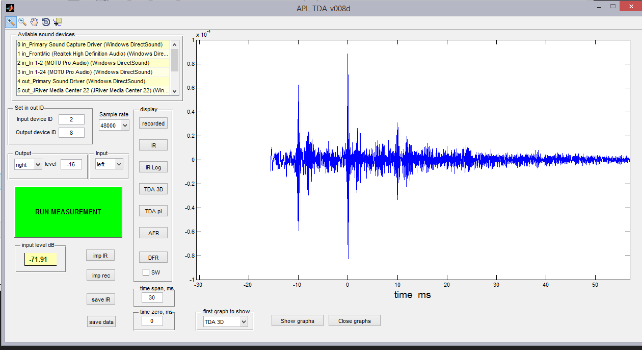

OK thanks. I tried to measure but the results looked odd and there is a glitching noise that repeats along with the sweep, it's not an audio device glitch as far as I can tell as it only plays along with the sweep, the glitch raises in tone along with the sweep and I can measure using the same WDM device using another piece of software. APL is also crashing (as in the window just disappears with no trace) at random.
Here's a pic of an IR I captured, it has multiple peaks which perhaps track that glitching noise? not sure. Machine is my win 8.1 htpc and measures ok using REW/acourate/holm. I installed the correct matlab runtime.

Numbers -71.91dB seems indicate nearly no signal at all to work with and probably therefor IR looks so poor, suggest try different L/R setings as I/O in APL_TDA than the ones seen in picture.

I did think that was rather low but I repeated the measurement in REW using the same routing/device config and similar levels and it measured ok and with no glitches in the audio playback. The actual playback level was also reasonably loud so I can't see an obvious way to increase the signal level without deafening everyone. I didn't systematically check this (will need to verify another time) but I don't think the level reported there scaled with the level of the measurement signal either, i.e. I think something else is wrong.
Okay then when you come to it again another time also suggest try rightclick and config APL_TDA to run as WinXP, say this because remember bwaslo discovered Win8 did steal some dynamic range (bits) from audio stream when interface was USB and he cured that with the WinXP command thing.
I measured in REW using the same WDM drivers, same channels and same routing in the motu mixer. The same glitching was present whether I measured in APL routing through jriver asio line in or going direct to the speaker.
I suspect it is a matlab issue, I did try digging around for log files in tmp (or similar) but found nothing. I don't know what to look for though which makes it tricky to debug 🙂
An idea would be to 'wire' the sound card/DAC output to the input as in a loop back and use these dry runs to find out what goes wrong. Saves a lot of noise and the answer is not speaker, amp and room related. At least not that I can think of.

A loop back showed the ghost image he was getting:
579503d1478893677-my-synergy-corner-horn-bass-bins-soundcard-line-level-loopback-3d-ghost-high-mic-gain.jpg
A lot easier to spot that without a speaker + room displaying their results simultaneously.
You wouldn't happen to have one channel trough loop back still wired up? For timing reference within REW? That was one of the things we came across here. 🙂 I don't expect you have, but a complete loop and testing APL that way might help see what is happening.
I don't think there is any internal echo, it does seem like a sample rate issue in apl. If I do nothing else but change wdm device to 96kHz and change apl to 96kHz then the glitch goes away. I haven't measured yet though, will try that next time I get a chance.
