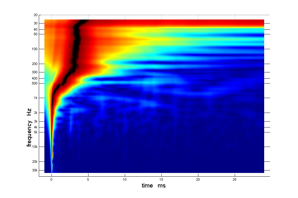

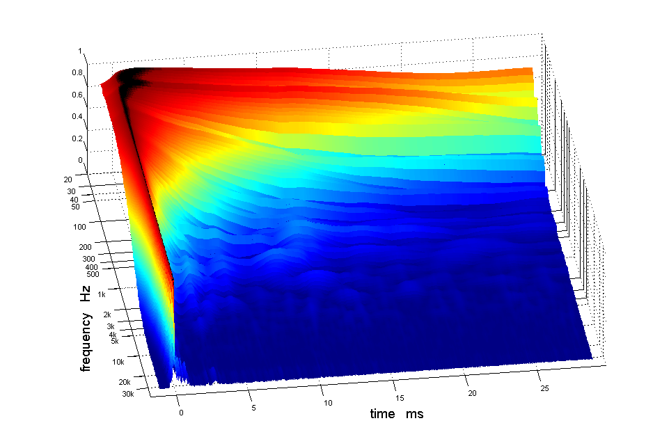

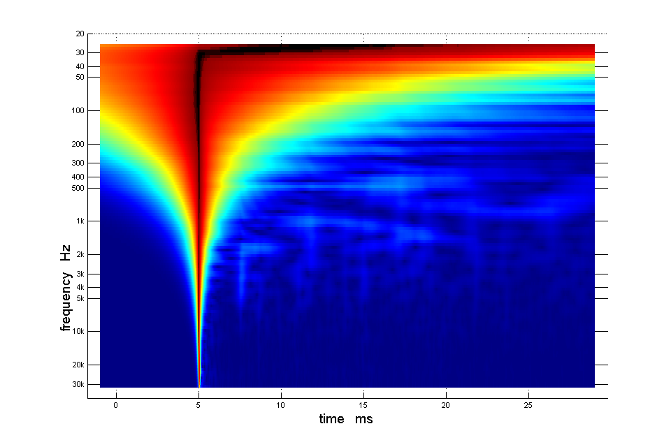

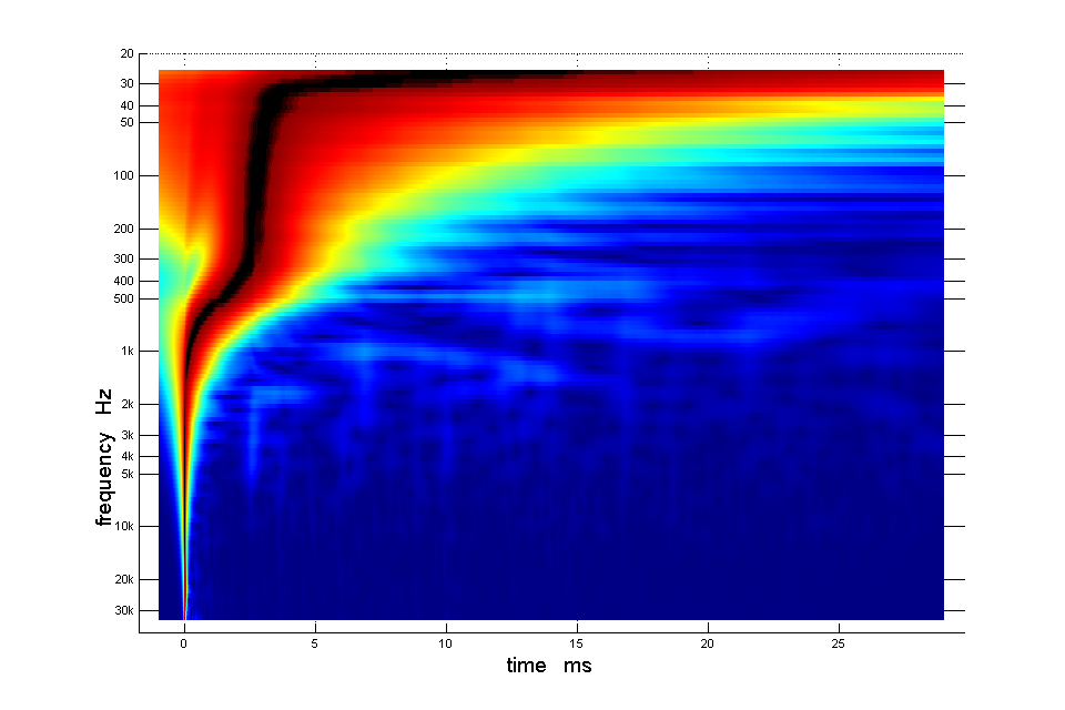

In REW, using waterfall display, and in its Control panel; there is a "Use CSD mode" tick box. What does it do?
For me, checking and unchecking this option makes a big difference in what is displayed - mostly in time.
There... 🙂
As it should, as it tries to show you the speaker only when you check CSD. Hard to do in a real room but it basically ignores (or tries to anyway) the later reflections in your room. It cuts off the response at the set Window in ms. You can check your impulse to see where you get a first reflection, shown as a (little) spike.
The reason I showed it here is the clear ridge of sound and it's steep drop off after that.
The start/stop of the driver(s). Without an anechoic room you don't really get a clear picture but this gets you somewhat close(r).

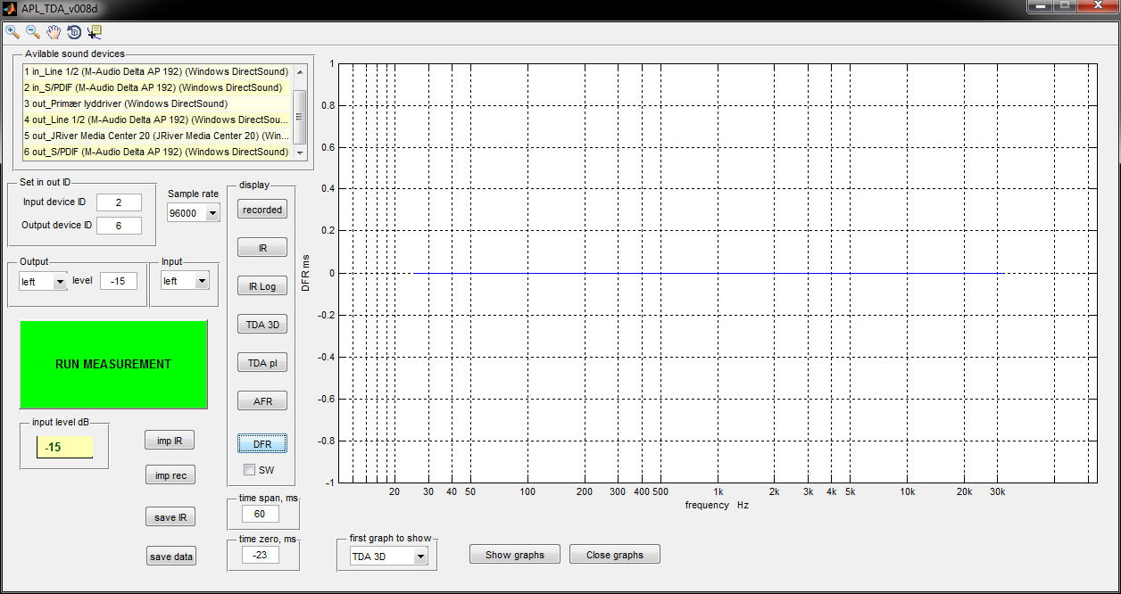

I was hoping the second try would be you running the APL_TDA demo 😉. Just to try it... did you catch the later edit of one of the above posts by me?
Thanks for the explanation of CSD! I will try to get APL running. I did install both SW as 32 bit versions. Matlab seemed to install fine. So did APL..

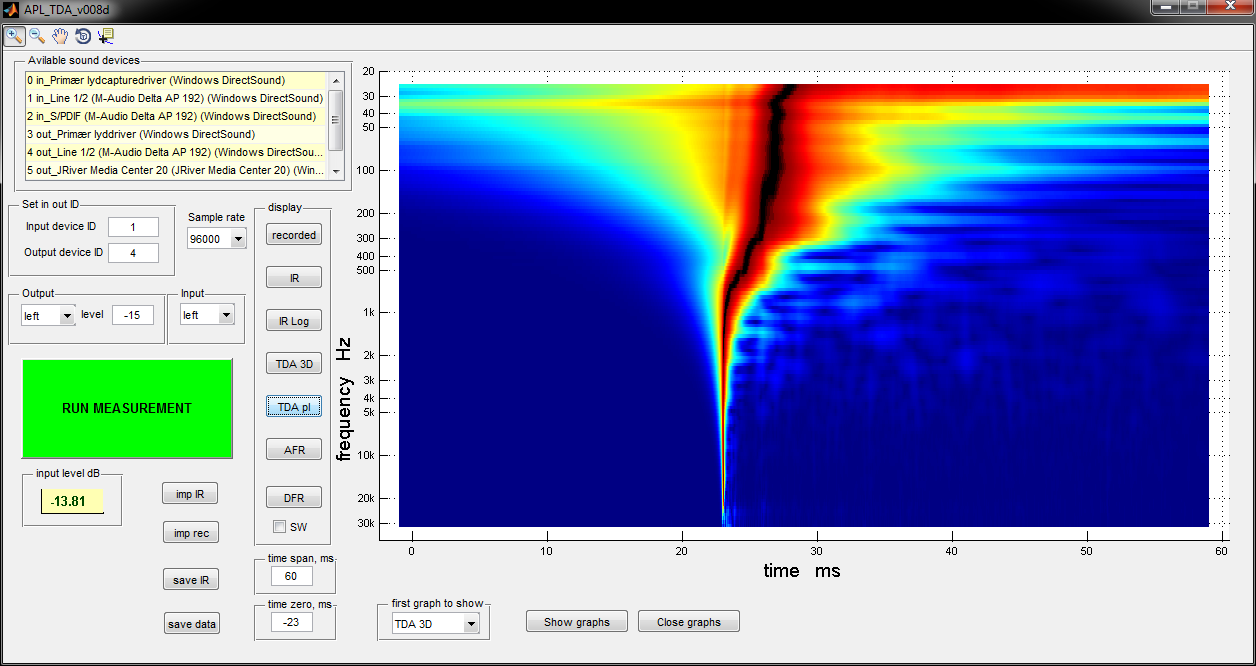

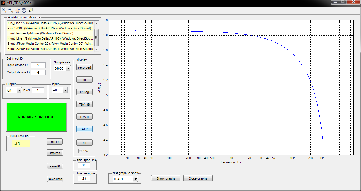

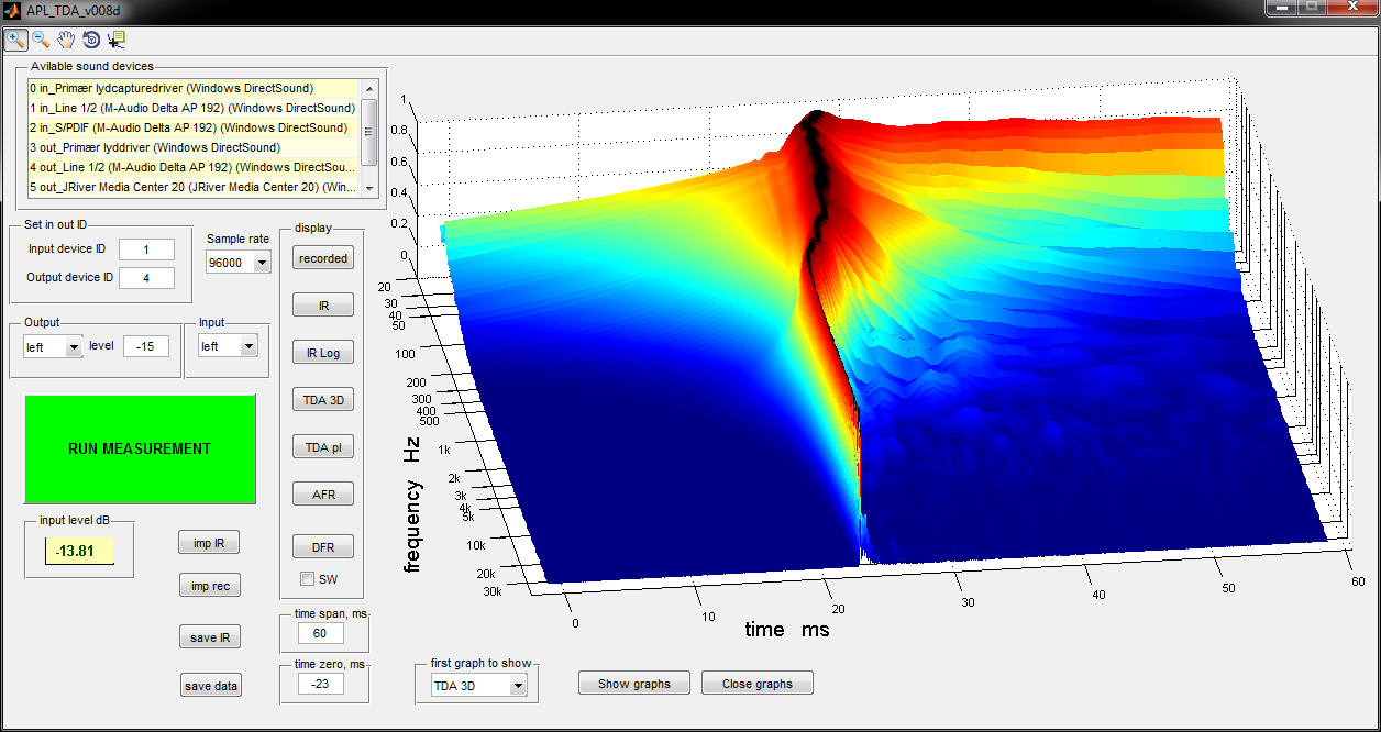

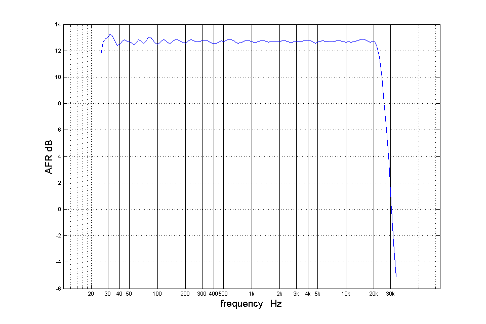

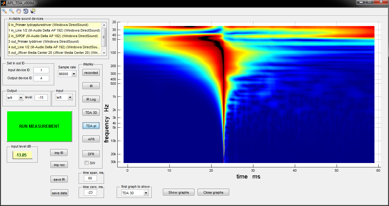

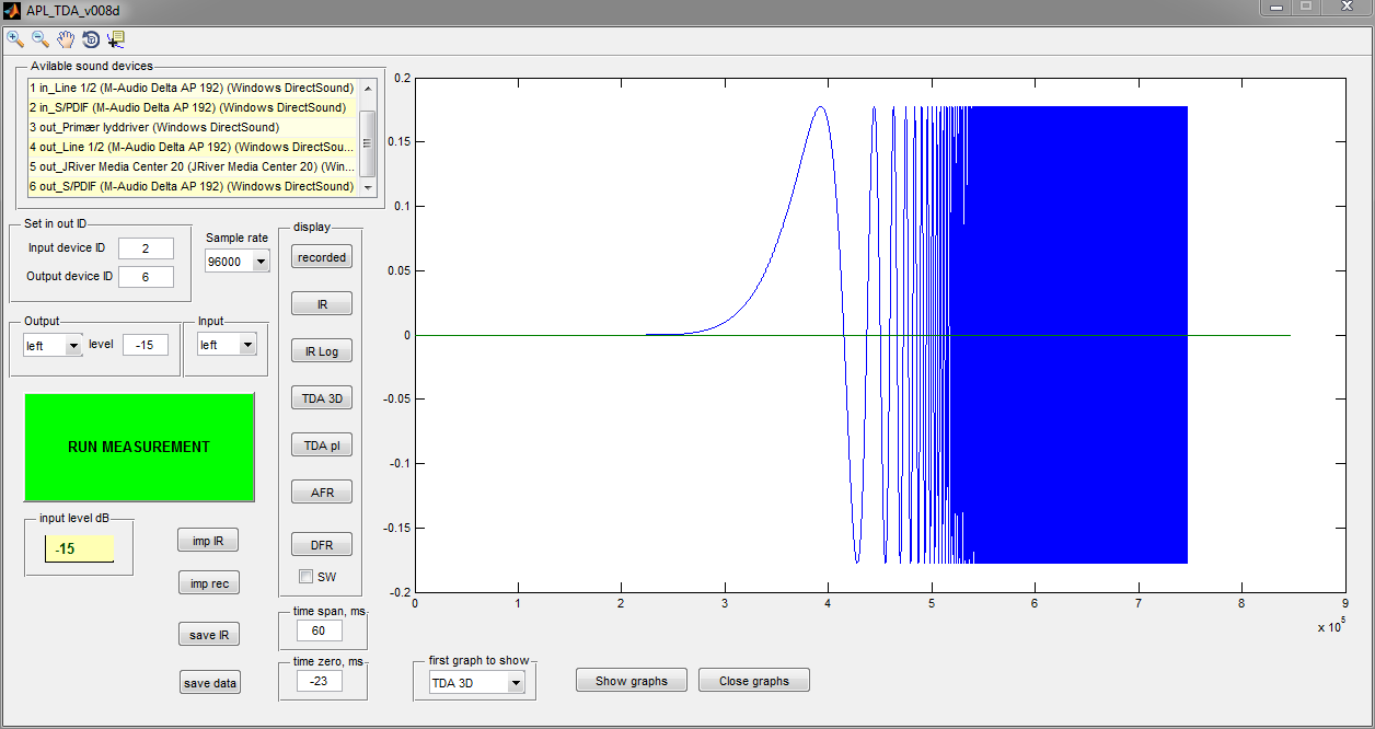

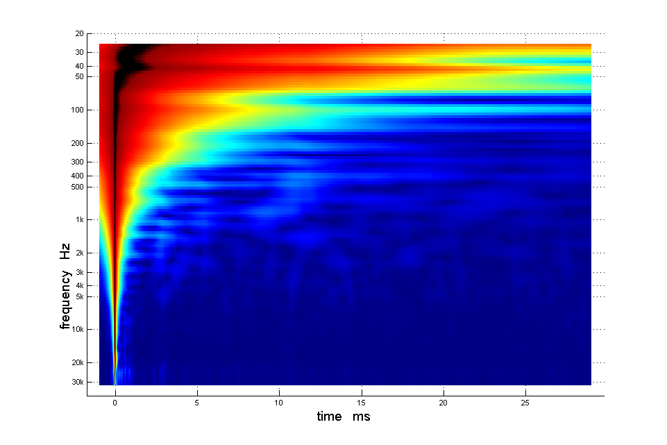

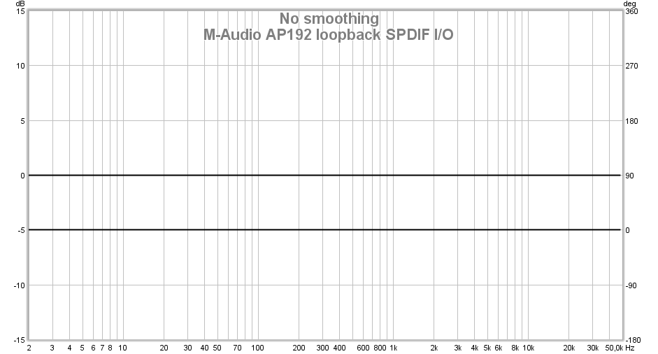

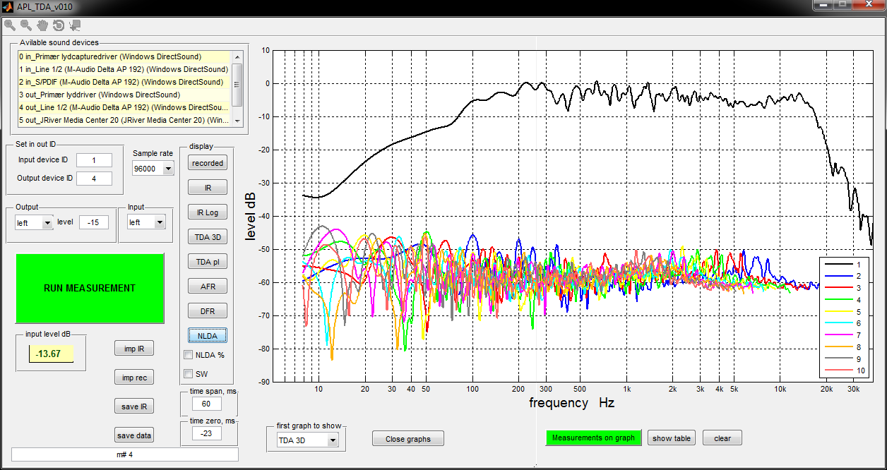

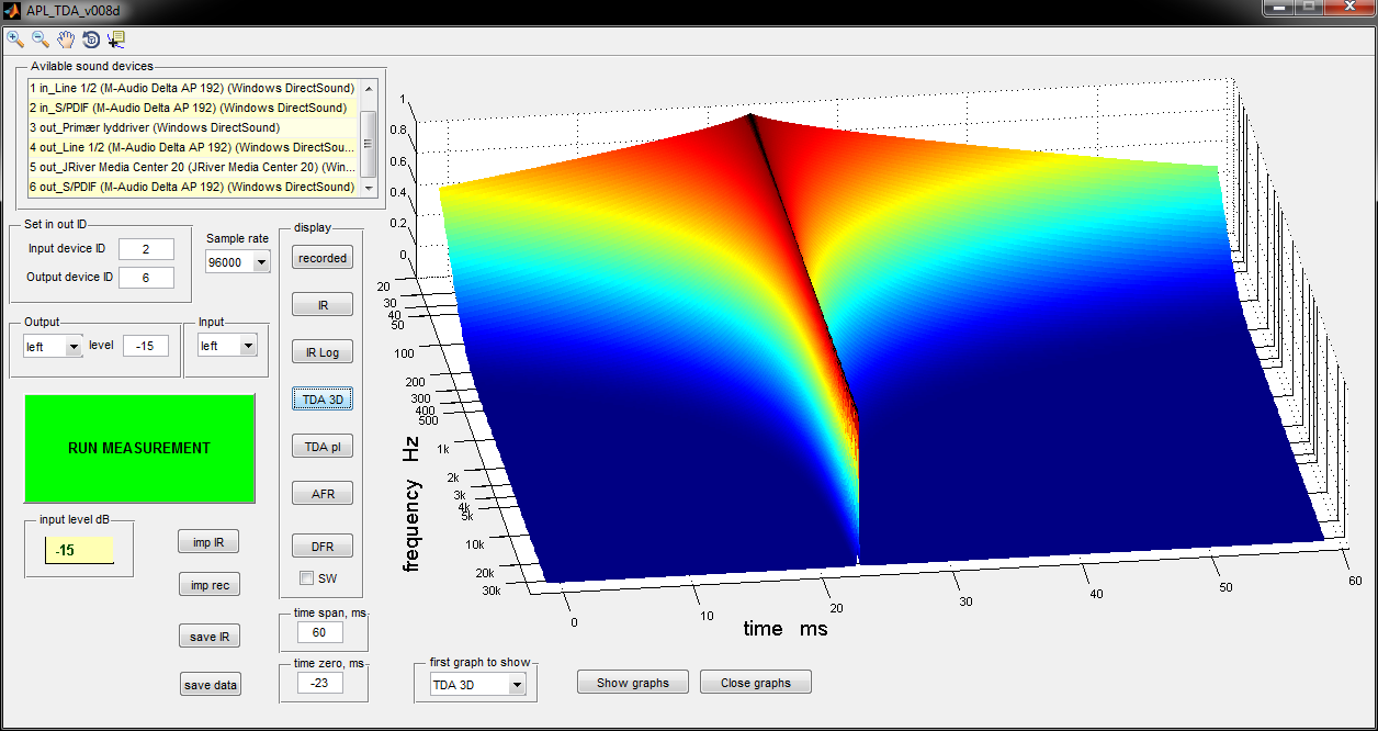

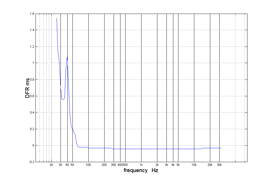

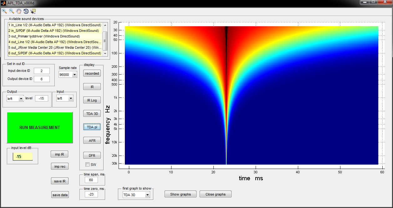

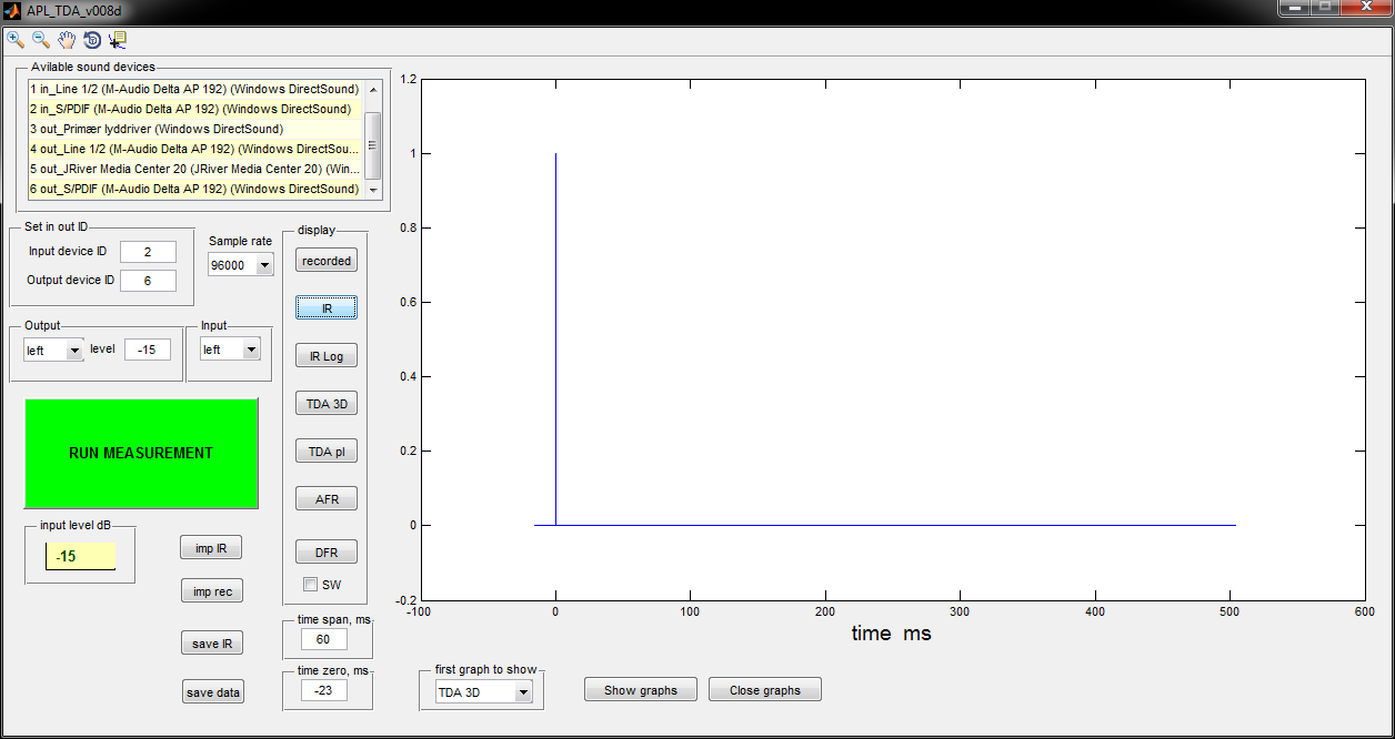

Demo test soundcard loopback
Had a first run APL_TDA demo software and began with a soundcard loopback check that did run really fine and plots are very clean and pretty.
There seems kind of filtering going on in AFR plot in that soundcard is a M-Audio AP192 with 2 channel analog I/O and SPDIF I/O, and i did run SPDIF I/O which is reason IR and sweep is so clean, and when running these digital channels as loopback in REW frq response is dead flat as seen in last picture but AFR plot is not dead flat.

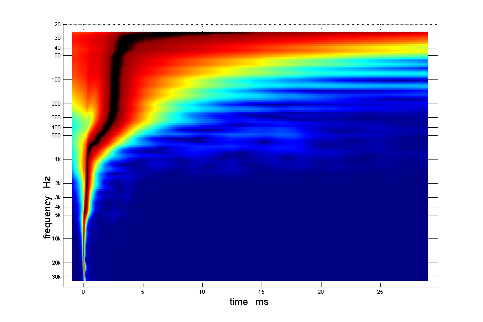

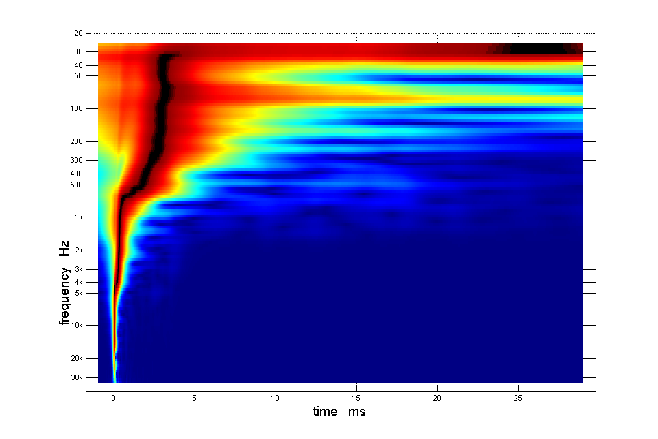

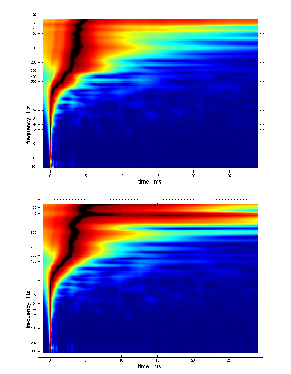

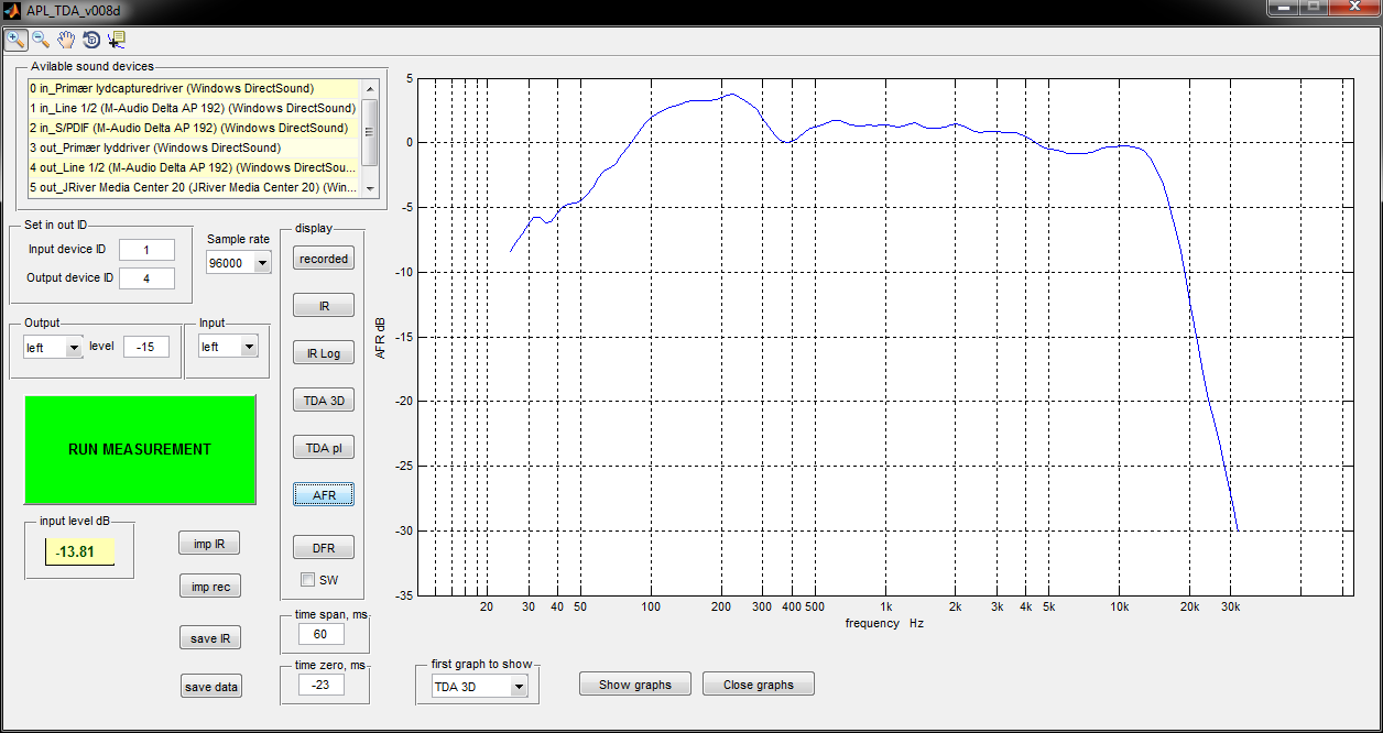

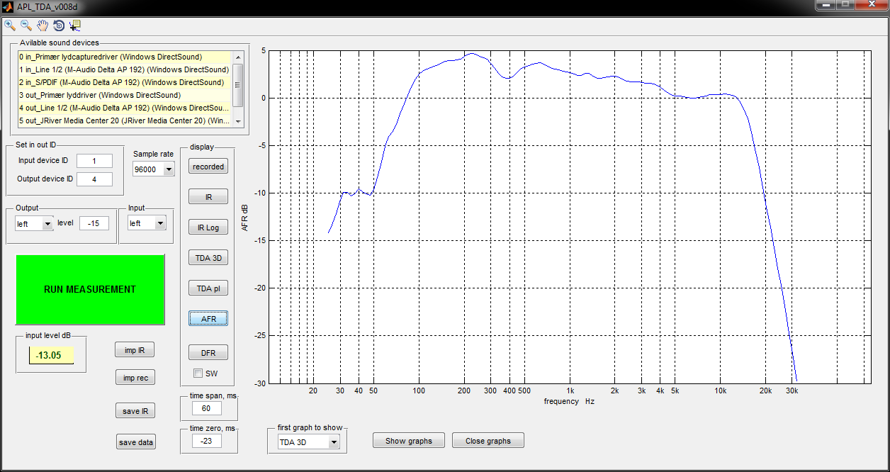

Demo test real speaker
Next test was with real two-way speaker, first four are with Rephase created FIR filter set with too speedy bass settings and the next four is same but without FIR filter. XO is LR8 at 355Hz and microphone is at 30cm, so at 2-3 meter distance with room mode there is much more natural bass.
Think its nice measurement software and in same moment as when creating this post i got a license file in my inbox so next up is to get full featured version to run. Raimonds did generous offer a discount to readers this thread http://www.diyaudio.com/forums/full...eaker-correction-networks-27.html#post4583863 great thanks for that.

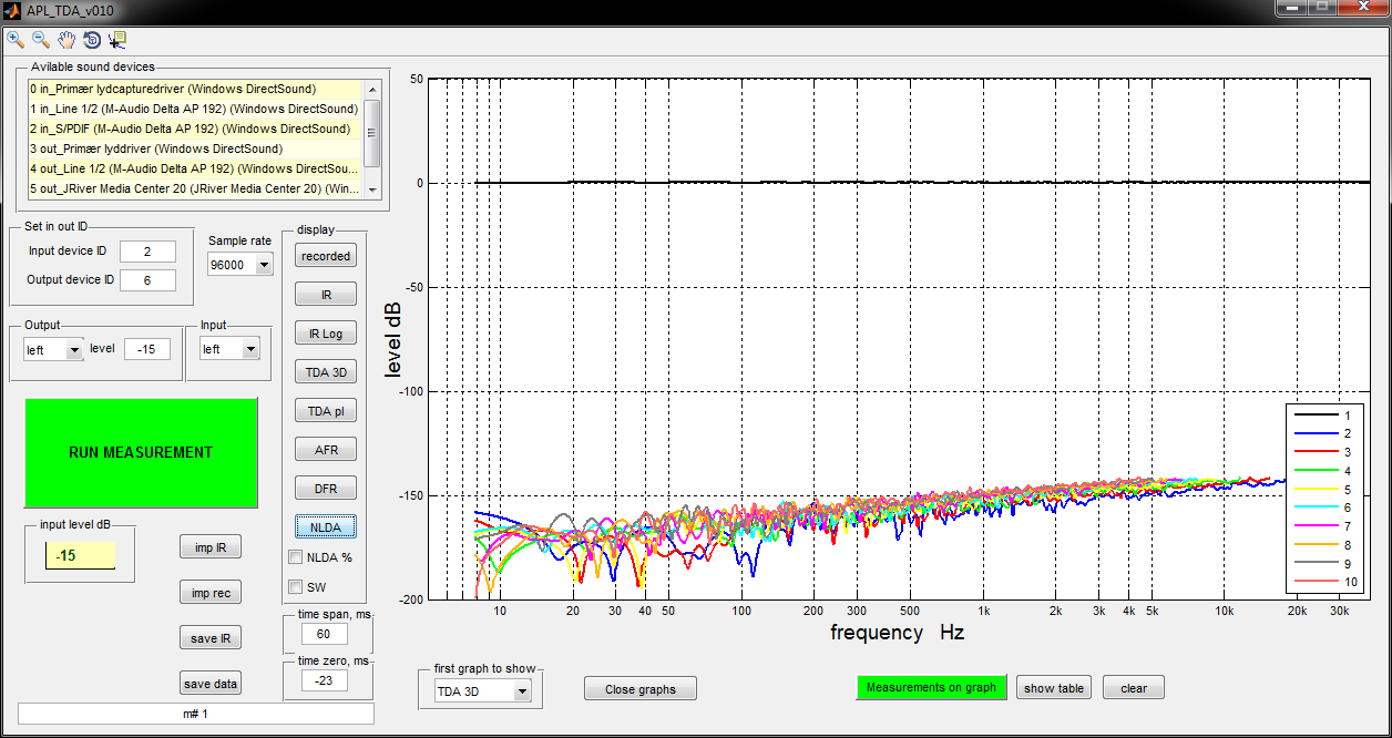

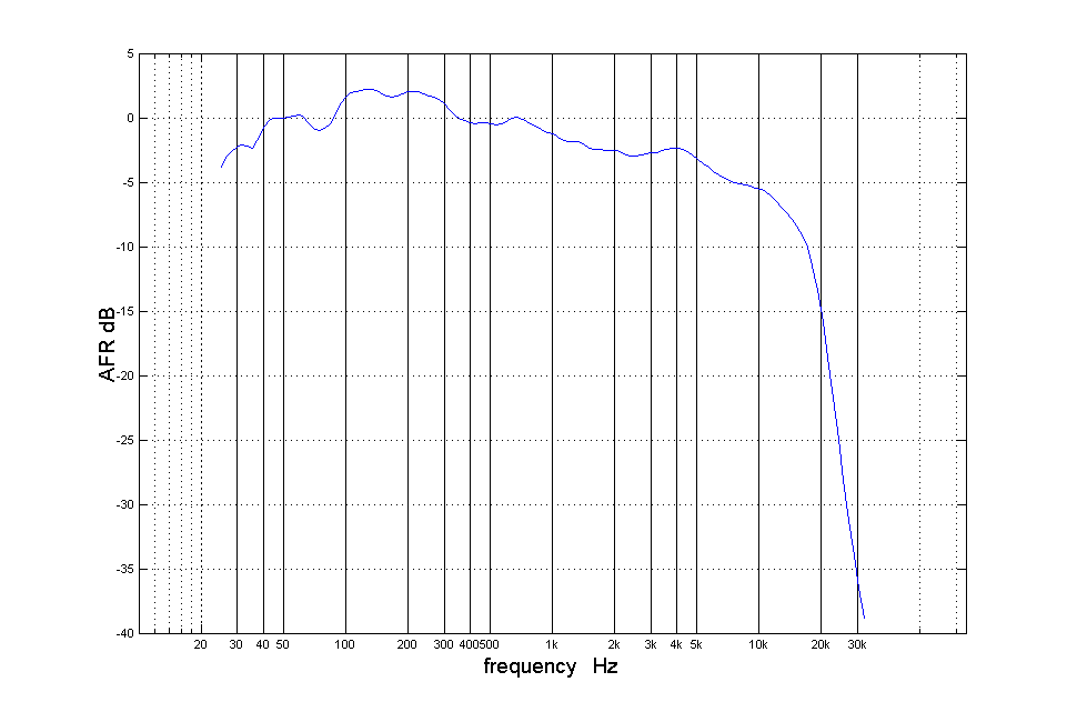

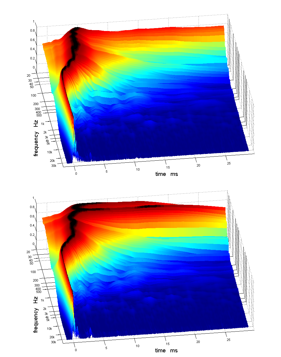

Add to previous posts
: ) got license installed and now got a new NLDA plot into package, demo was software v0.08 and license one is v0.10.
First plot is associated to post 165 soundcard SPDIF loopback, and second plot associated to FIR version in post 166.
Nice curves. Showing everything : )
But let’s allow creating FIR eq for another tool – TDA EQ.
We can make virtual processing.
Please download the testsignal of TDA EQ http://aplaudio.com/downloads/TS_48_96k_25p.rar
Play it and record by use of measurement mic. Send recorded file to me.
It contains 25 sweeps. You should move the measurement mic all the recording time to cover some square (25 x 25 points) in front of your speaker (distance 0.5 ...1 m) to cover some
+ - 5...10 degr. around the axes.

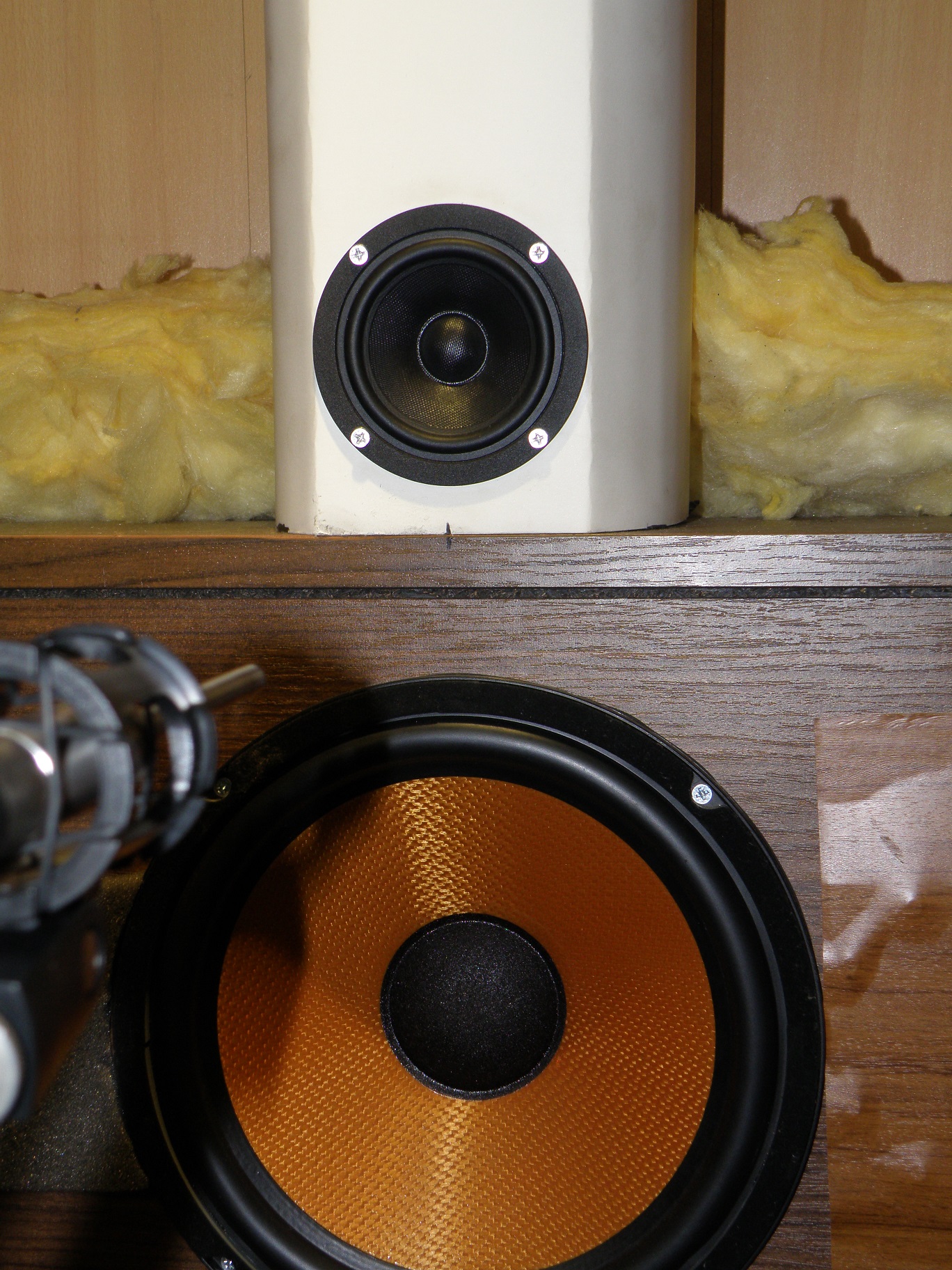

Regarding speaker and setup will have to admit its a temporary build on diy road that has been used to learn about JRiver as steering multiway via sound card plus how the used drivers perform and get feets wet with FIR correction created in Rephase. For info all IRR filters including XO and acoustic center offset is manual done in JRivers build in 2x PEQ containers, then in JRiver convolution container is FIR correction from Rephase that correct for system stopbands plus XO phase turn distortion.

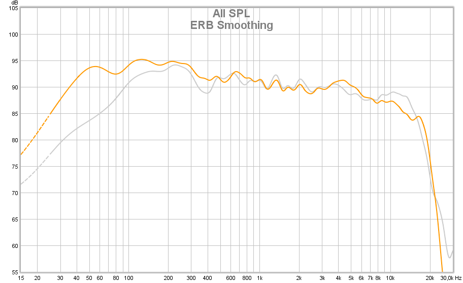

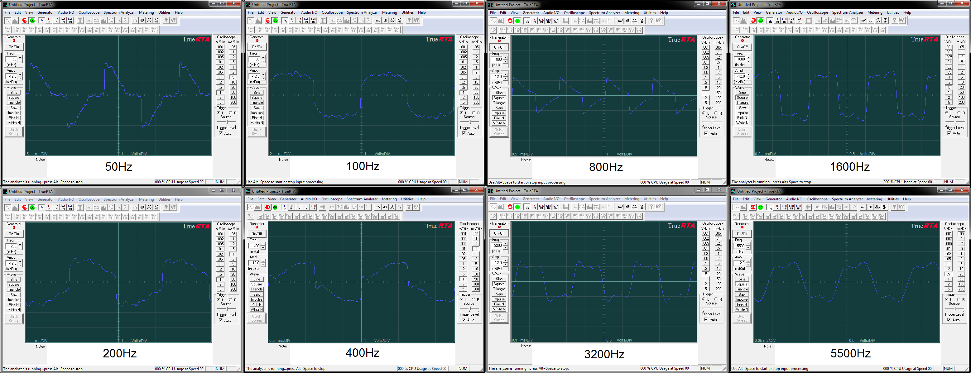

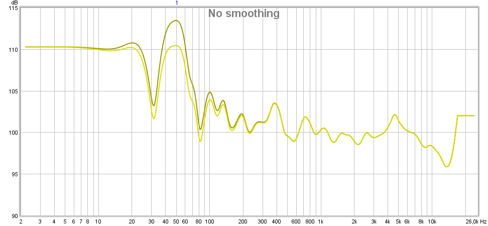

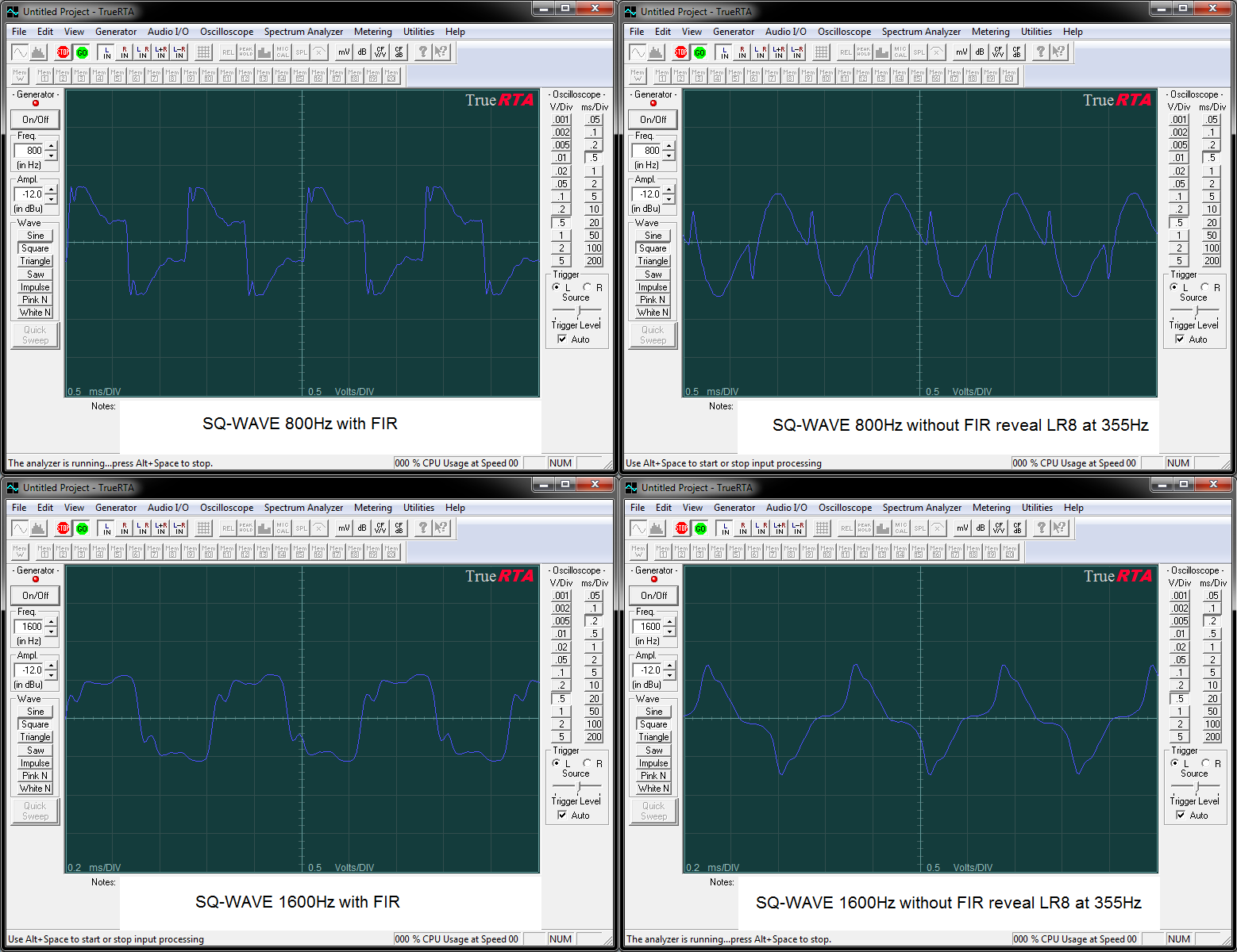

Be back in while with measurements from APL_TDA and REW, but subjective listening it don't work and probably because the realism i got used to because old FIR filter neutralize 355Hz LR8 IRR XO, and that can be seen in below square wave live measurement. JRiver have only one container for convolution so can't have old FIR running at same time as new EQ, Raimonds can you add FIR correction for LR8 at 355Hz into same EQ correction or can your EQ be add as VST instead so as my FIR can be loaded again.
Here measurement at 30 cm, 4x APL_TDA plots at top its without FIR and below that the new EQ loaded into convolution engine, REW plot have ERB smoothing.

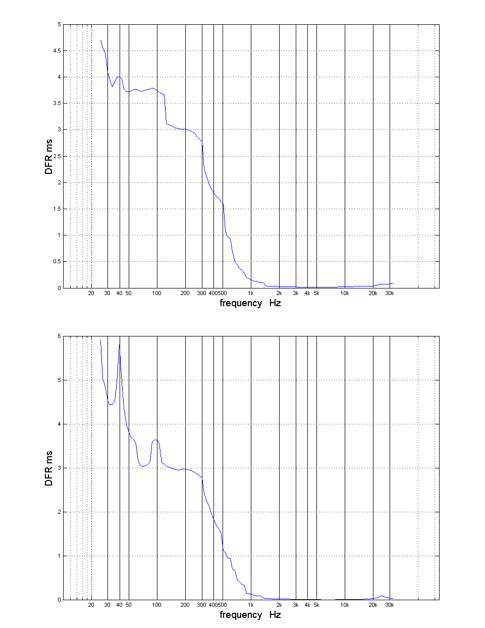

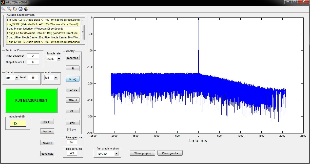

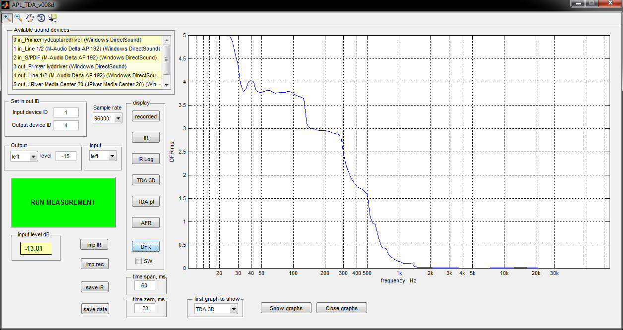

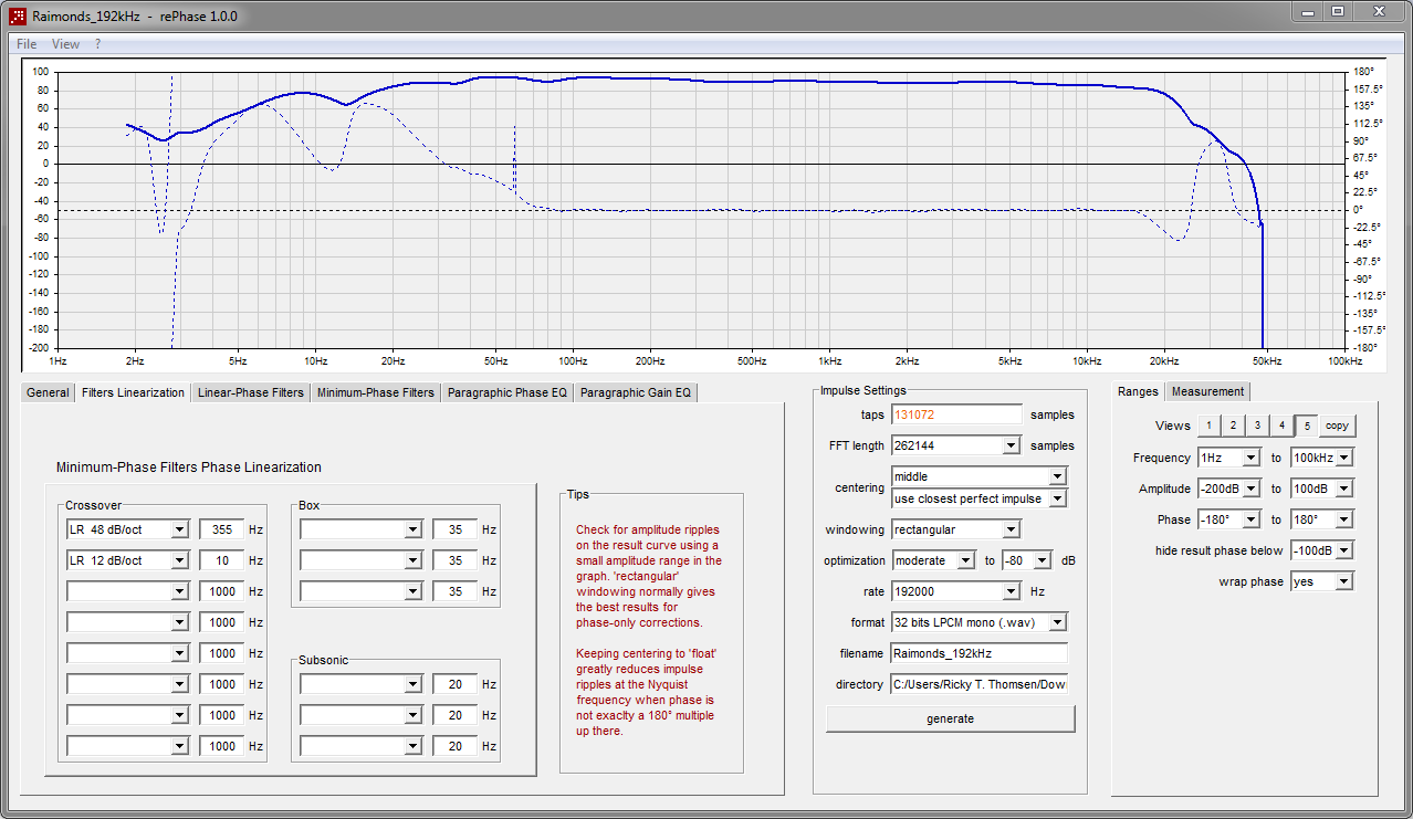

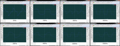

Got some progress on paper in that took REW measurement from post 177 added FDW 1/6 octave (4,3 cycles) and exported as frd-file.
That file got some dirty quick massage into Rephase as visual in picture-6.
More listening tomorrow its late in the night : )

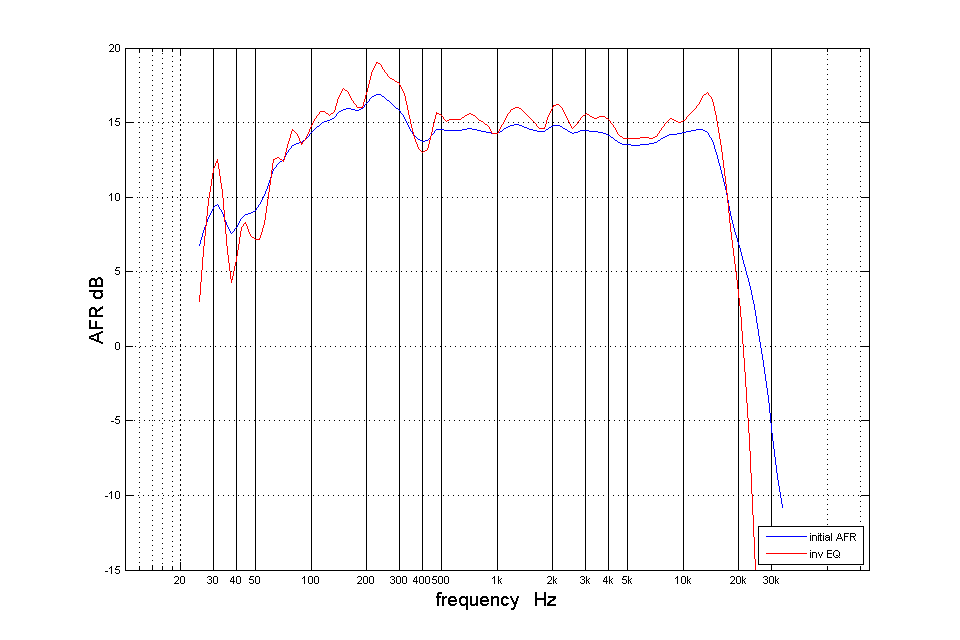

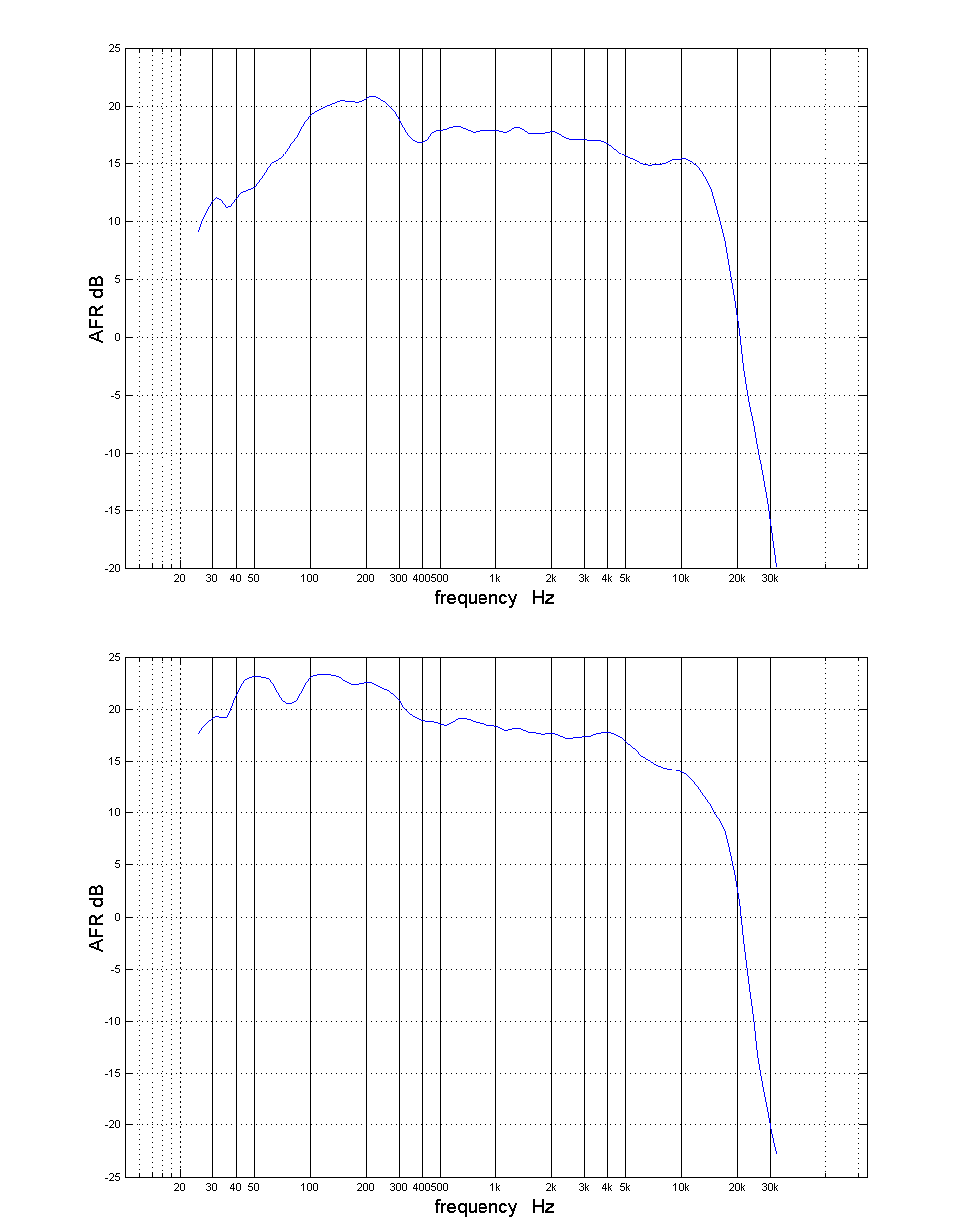

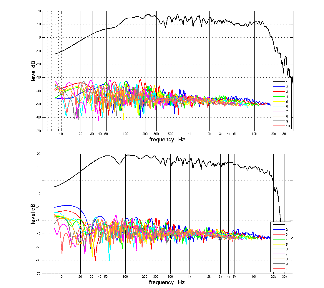

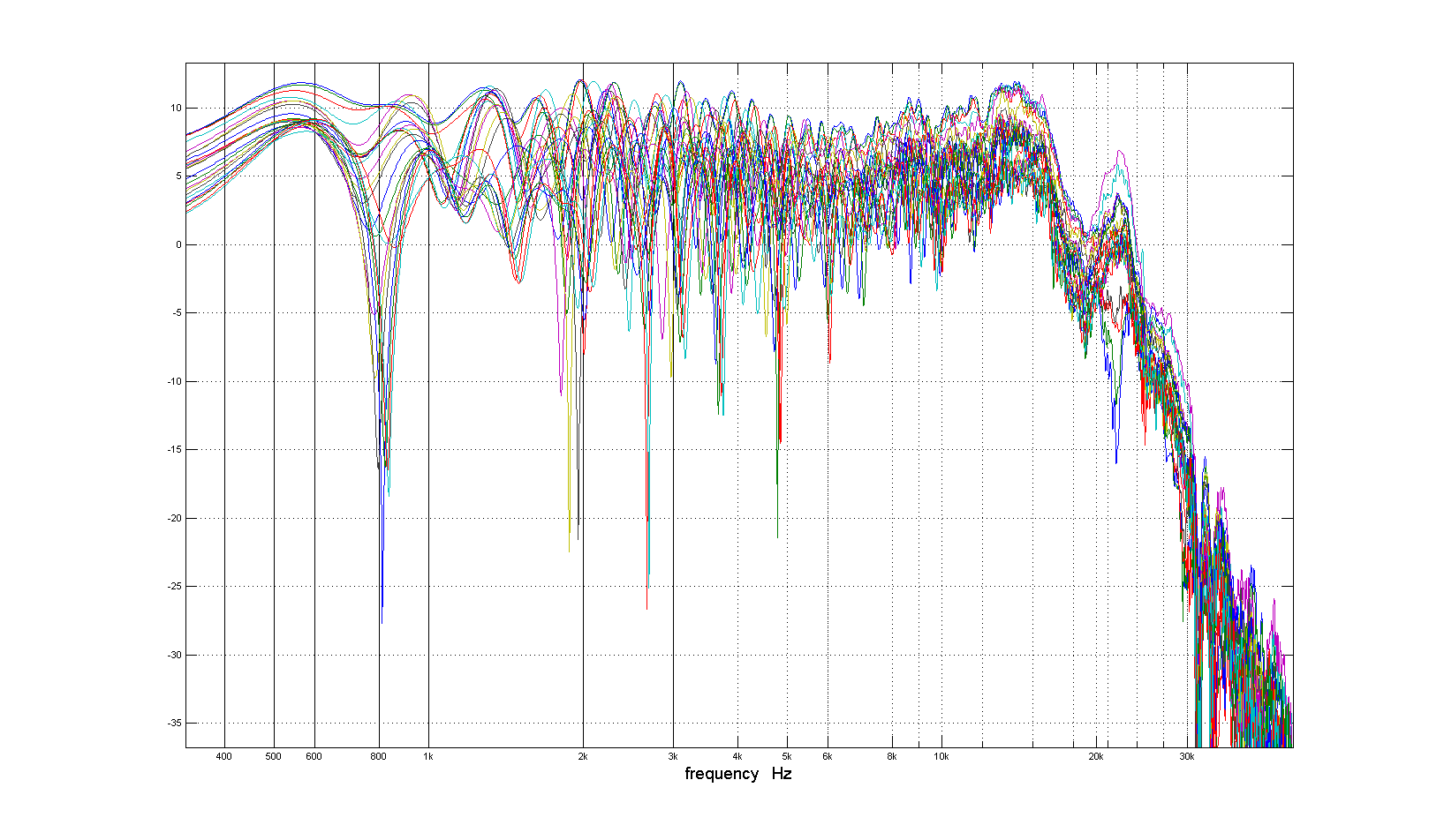

Hello,
There is a problem that the measurement was made at 25 points but its equalizing result is being tested on 1 point. Please see attached image with all 25 FR.
So, I decided to take just one point (most powerful HF) and did all eq work for it.
You can see:
initial TDA image
AFR equalized TDA image
AFR and DFR equalized TDAimage
initial AFR
And please find attached 2 FIR correction files:
1) just AFR correction BYRTT_1p_AFReq.wav
2) AFR and DFR correction BYRTT_1p_A&Deq.wav
