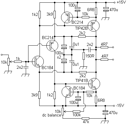

the 2n2 cap has another function, to keep the hf loop gain high by grounding the bases of the input transistors. the dominant poles are from the output transistors at Ft/beta, so most likely the PNP
still the loop gain is very poor. the transistor output current is divided between the load and the feedback resistor, then at the entry into the emitters there is another division due to the gain dividing resistor. no current gain in the input transistors, only the beta of the output transistors. that is why we have to rely on linear beta transistors.
> The 2n2 cap has another function, to keep the hf loop gain high by grounding the bases of the input transistors.
Correct. So the usual trick of increasing the cap to limit bandwidth for stability does not work, because it actually increases OLG at HF.
Took me a little while to realise that.
Already explained in the article. See post #35.
If you can make it drive 30R load, 1k in addition is no issue.
Hence the use of Darlingtons in the modified version.
Linear beta transistors is ALWAYS a good idea for any analogue audio circuits.
Patrick

It could be an idea to put the RC filter before the potentiometer. That way it won't be a variable filter.
You can use a split-resistor approach to control the hf olg (just insert a couple-100ohms resistor betwenn the hot end of the cap and inp. transistors bases, aka "base stopper"). Will need a spice probing first and after that a hf square-wave oscope test - and finetuning for the optimum value.> The 2n2 cap has another function, to keep the hf loop gain high by grounding the bases of the input transistors.

The original version will stay original, as far as I am concerned.
But of course indivuduals can decide how they want it.
Our modified version is now stable without caps in the feedback, with or without load.
And you can see the clean frequency response in post #80.
Patrick
Patrick
As promised, including frequency responses with or without load.
You can see when when not loaded the amp has a slight (1.5dB) overshoot at ~ 2MHz.
But it is now kept stable by the Zobel network.
At 30R load, it is stable on its own.

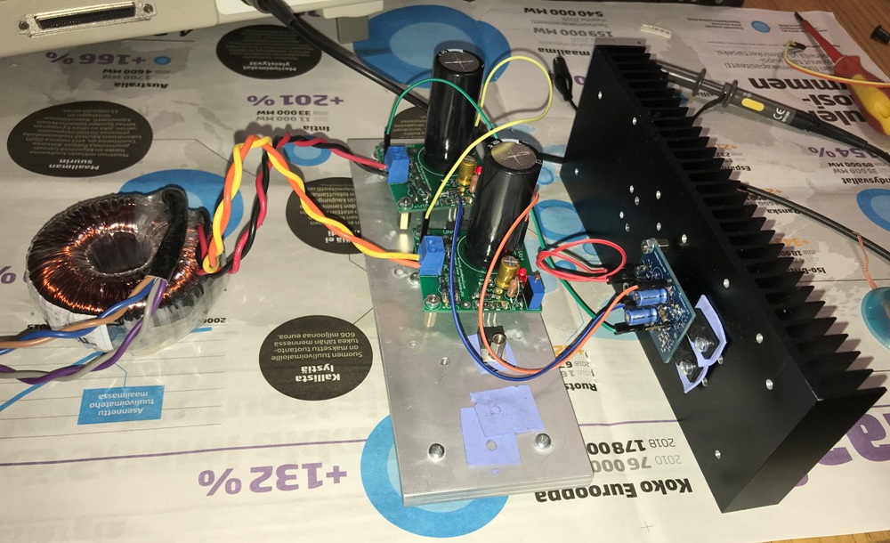

At last, after the oscillation problems, I got it all together and had some time to listen to the Xen version of the JLH headphone amp. The circuit is really simple to build as you get familiar with smd soldering with only few parts in this Xen version. The DC offset on the output was quite easy to set to a level of +-10 mV and the bias was configured to 150 mA.
So here are my first impressions with a basic power supply (common for both channels). Usually my first impressions don’t change much.
It seems to be a very musical and pleasant to listen to. You easily forget yourself in listening and in no time the song ends and you have no notes about sound quality in mind. I would say that’s a pretty darn good feature for a headamp.
What else can I say... Soundstage is wide, sound signature is clear and crisp, very effortless. Bass is tight, but not quite as deep as with UTHAiM, still very good. Vocals are good but I think some contestants are better on this regard. The highs are really sparkling, but not too much.
Great design once again. There seems to be some magic with this simple circuit!
My test setup was the following:
- Raspberry Pi with Moode Audio player software => Ian Canada's isolator board => Allo Kali reclocker board => I2S output
- I2S input to DDDAC DA-converter (a single Tent shunt board version)
- All music files were FLAC 16bit/44.1kHz ripped from original CDs with dB Power Amp software.
- The volume levels were matched by feeding a 1 kHz test signal to the DAC and the voltage was measured from the headphone jack while my Audeze LCD-2 phones were connected.
- Volume control was the same for both headamps: Arduino based LDR volume and source selection controller.
- My headphones used for the test were Audeze LCD-2.2 Fazor
