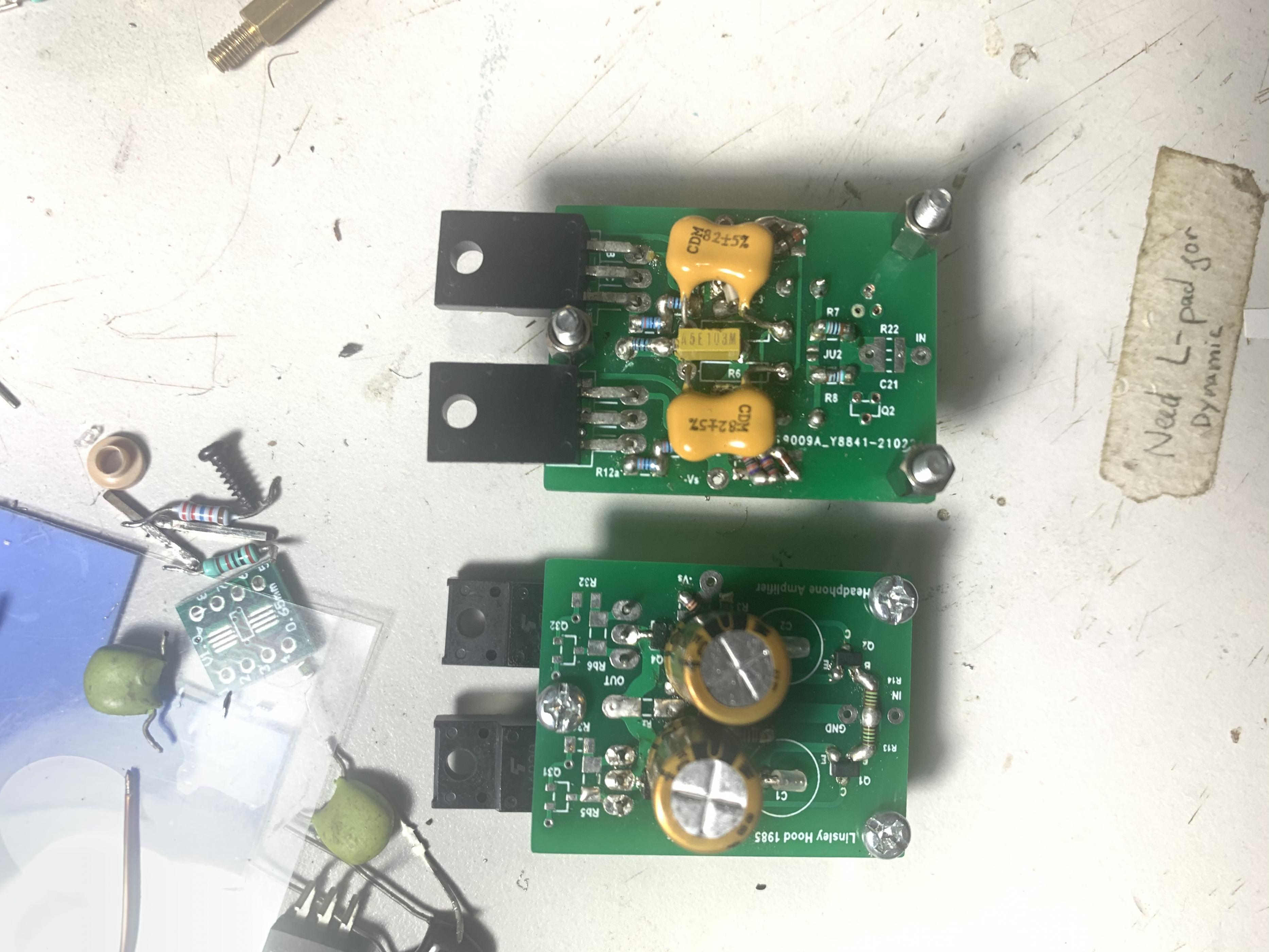

My attemp at the Xen Version. Input trans are 1% match, output trans are 1% match Toshiba, I used Vishay Melf 1% because it’s available in local store, same for silver mica caps because I couldn’t get C0G.

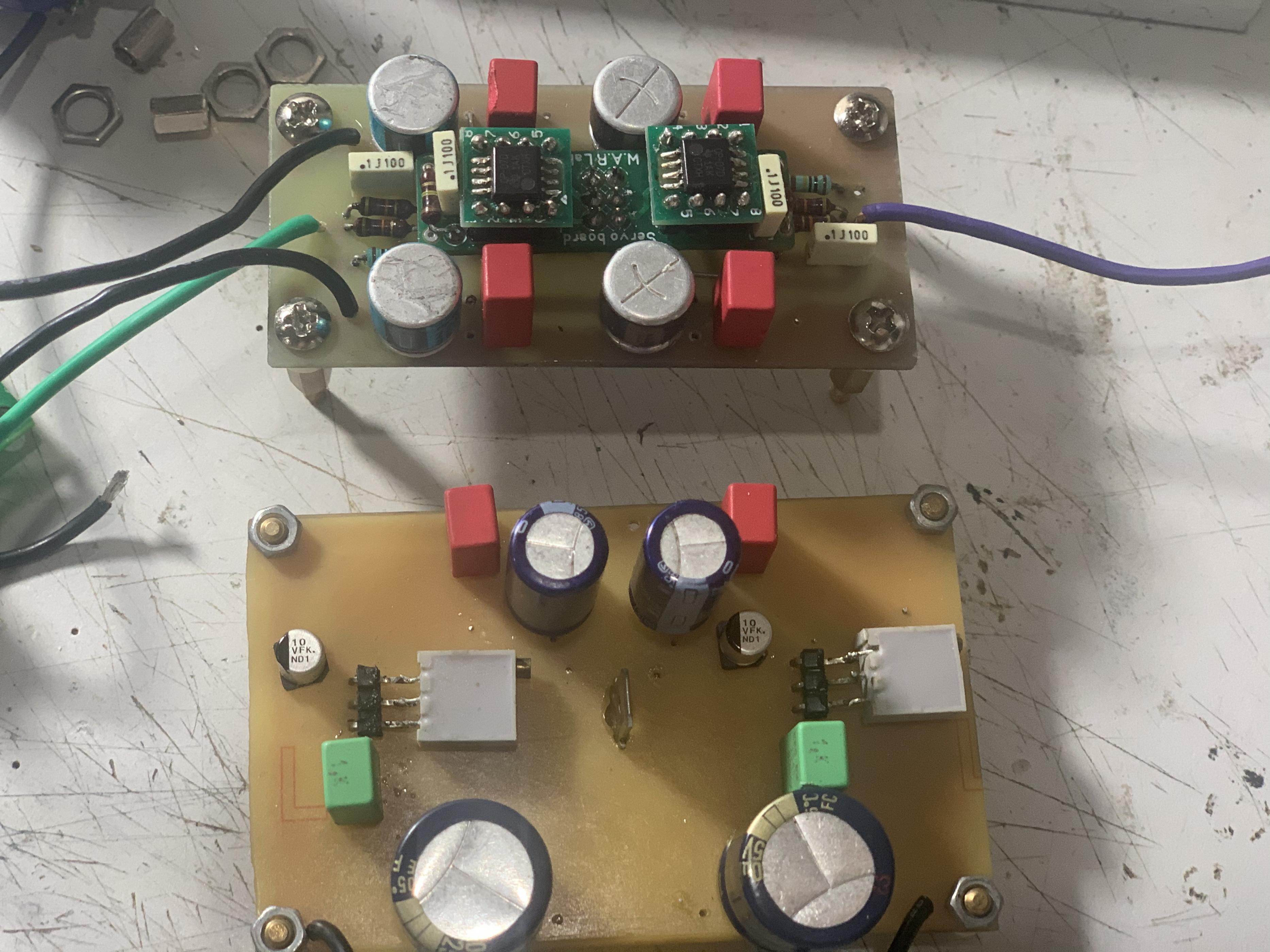

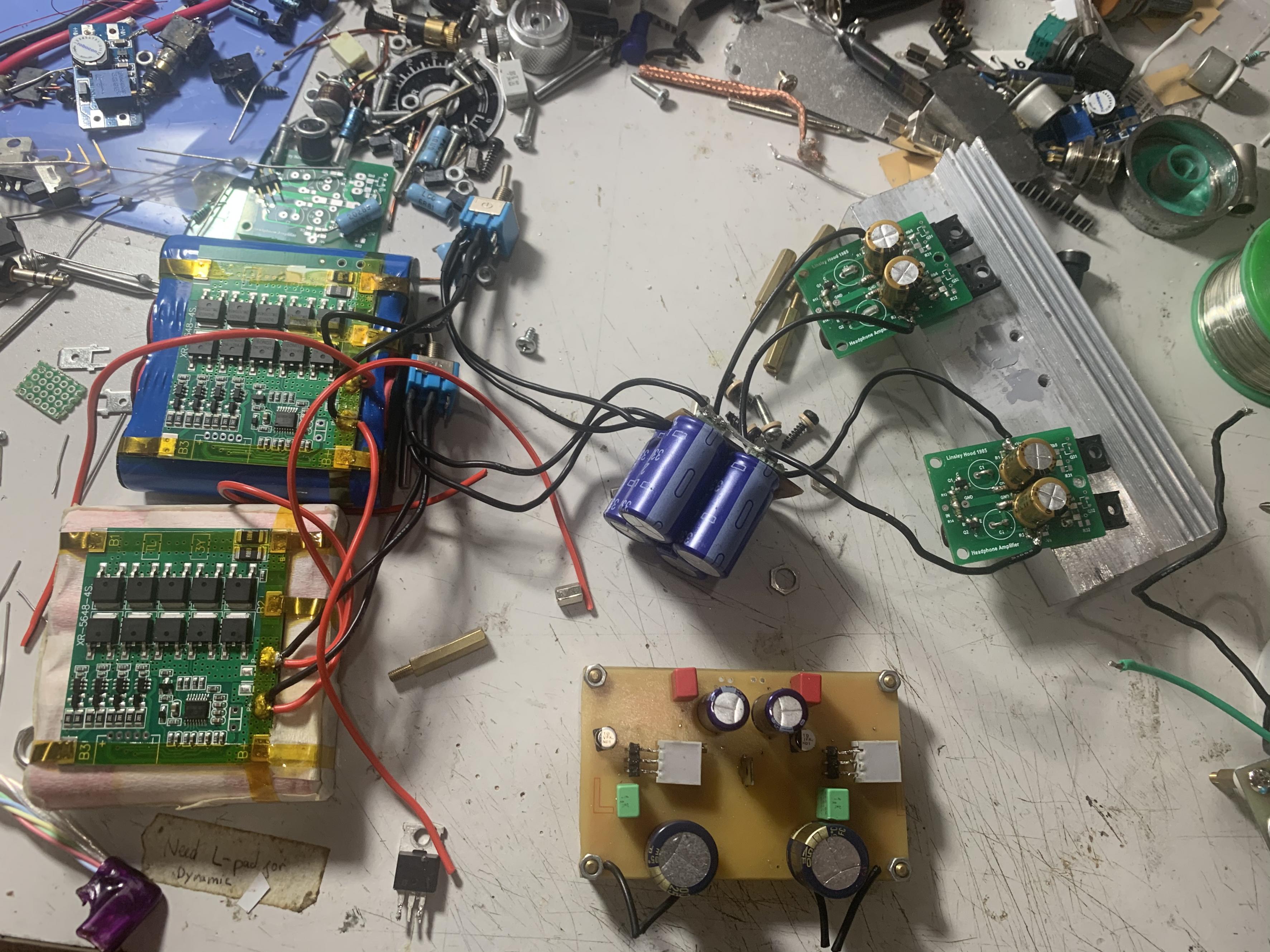

Finally I found my time to get this project done. I used two 4S li-ion cell, through some cap and feed straight to the amp board, +/-16.49V. I made a simple lm317 tracking pre-reg board and a dc servo board just in case.
Biased is 120mA. I found some big heatsinks like the one in the picture. I think one heatsink for both channels should work, but I got another one if this is too hot.
Thanks for a great project Patrick!

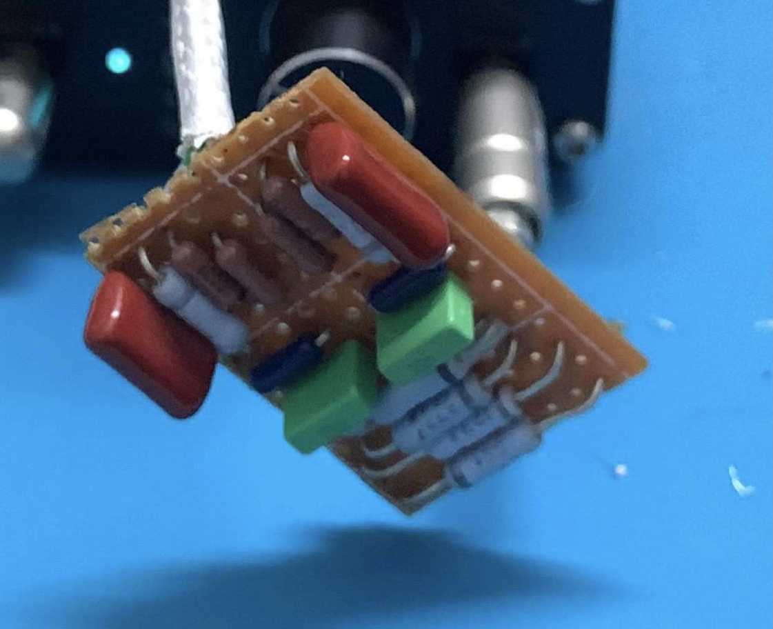

Hi Patrick.Someone wants to build the JLH HPA with our passive Danyuk crossfeed.
Since we stop all GB activities because of Corona, we cannot provide PCB.
As a compromise, here is a layout that you can easily build with standard Vero boards.
Component values :
R1 = 11k
R2 = 5.6k when used alone; 12k when in parallel with a 10k pot.
R3 = 100k
R4 = 18k
R5 = 27k
C1 = 2.2n
C4 = 22n
We recommend Vishay Dale RN55 and WIMA FKP2 or MKP2.
Blue colour indicates jumper.
Patrick

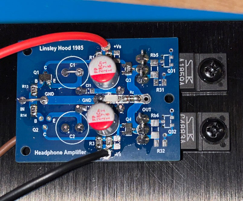

I assembled a circuit board for one channel, on+/-15V rail voltage bias is only 84mA, dc offset 60mV, so how to increase bias?
You should first check voltage across R1,3 to be about 1.66V.
If lower than that, then reduce R2,R4 would increase that, and hence bias.
Patrick
Patrick
Then voltage across R11,12 should be ~0.4V.
Divided by 3.3R gives you ~120mA.
If it is smaller than 0.4V, then something not right with the Darlingtons.
Because 2x Vbe should be about 1.2~1.3V.
Patrick
