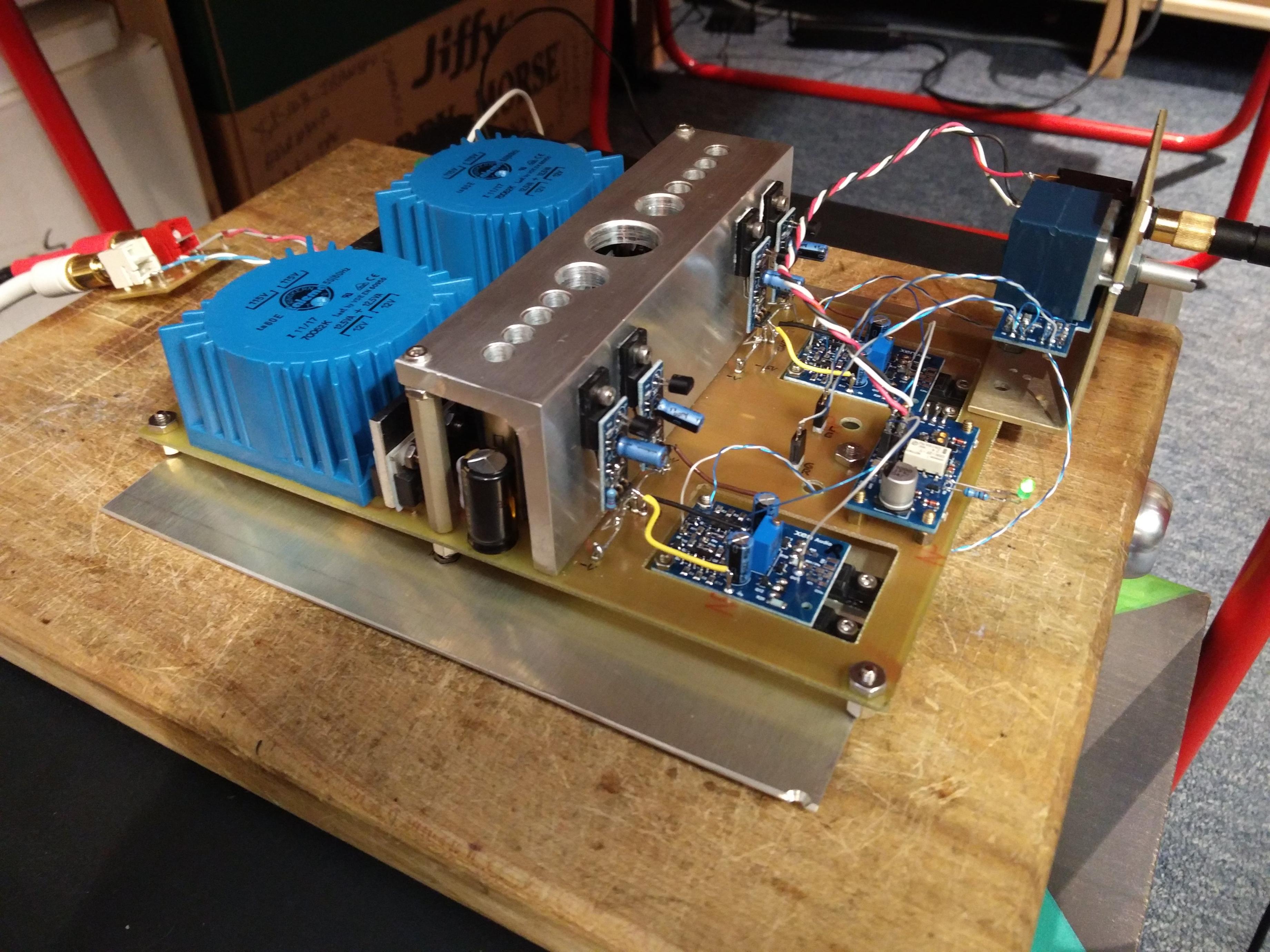

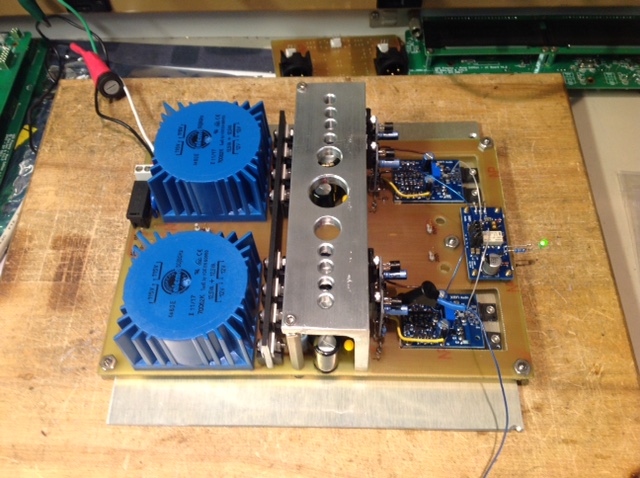

Complete amp prototype working, with the actual assembly, the output DC offset settled at very low values, 5mv and 3mv. No need to tweek the CCS, and/or the supply regulator output voltages. It is pretty stable, quite impressive.
BTW my regs heatsink is not too big, it is warm to the touch. In the enclosed chassis everything will easily stabilized at least 35C...
Time to work on the Volume pot/crossfeed PCB
Many congratulations. Very fast progress, unlike us. 🙂
Because you are using both CCS and servo.
You will find (as we did) that when you use CCS only, you can trim and then there is no more need for servo.
But it is personal taste. I try to get rid of servo if I can.
I consider 35°C to be very low for Class A.
In the example I showed earlier, the AL angle is connected to the bottom (aluminium) plate via brass standoffs.
The latter in turn is connected to the side heatsinks of the 2107 case.
So the heat dissipation has an additional path to the side heatsinks.

These DC offset numbers are without the servo, I didn't install the Servo parts, since I was using the CCS...
Cross Feed/Volume pot connection questions:
Q1: If I understand the small cross feed pcb, the small On/Off pads for a jumper/switch turns on/off only the Cross Feed effect, but leave the treble boost network in circuit?
Q2: I don't see soldering pads for the Volume pot to the amp input, or are we using the unused pot pads for this purpose?
Q3: The small pcb input marked Fi, should be Li, insn't?
To resume, from the rear RCA inputs, up to Ri/Li pads on the Crossfeed PCB, and then the volume pot middle wiper pads up to the amp inputs, right?
Then your matching is very well done. 😉
Correct, but the boost is really minimal.
The switch is there for you to make a quick comparison between XFD and no XFD.
Once you decide that you do not want XFD, you want to remove the entire board anyhow.
I normally solder the amp input wiring directly on the pot pins.
Correct, plus Gnd wires of course.
And use twisted pair for each channel.

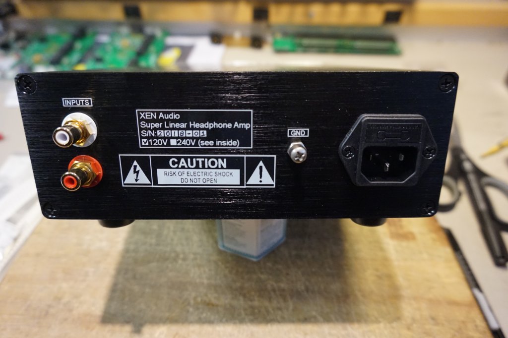

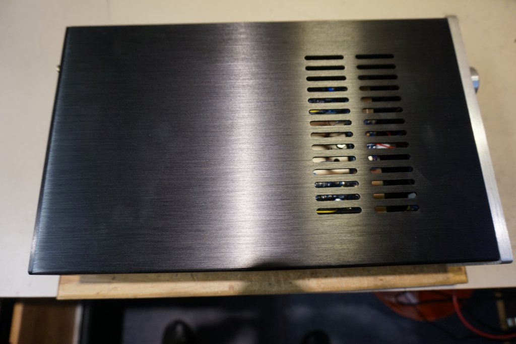

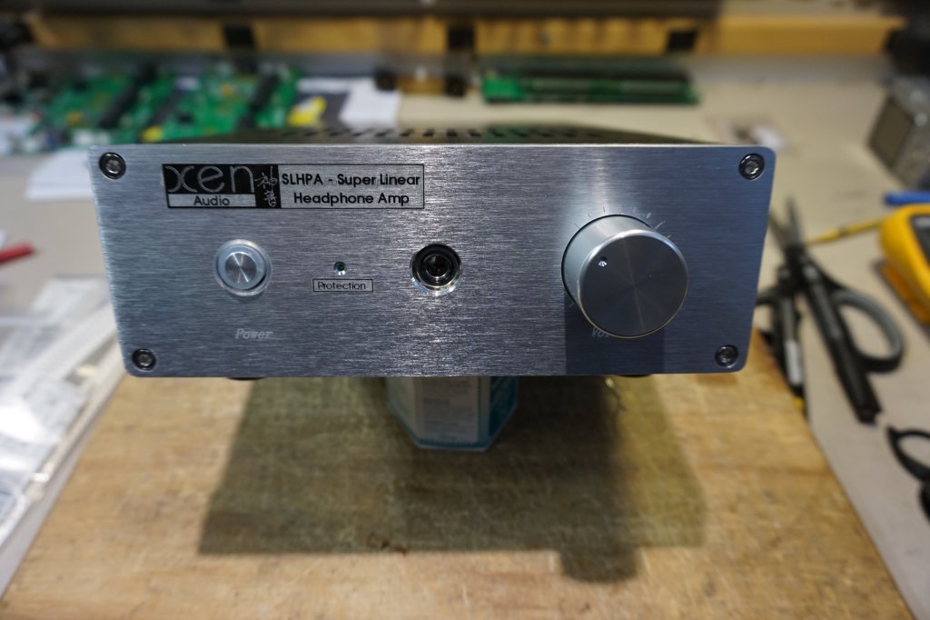

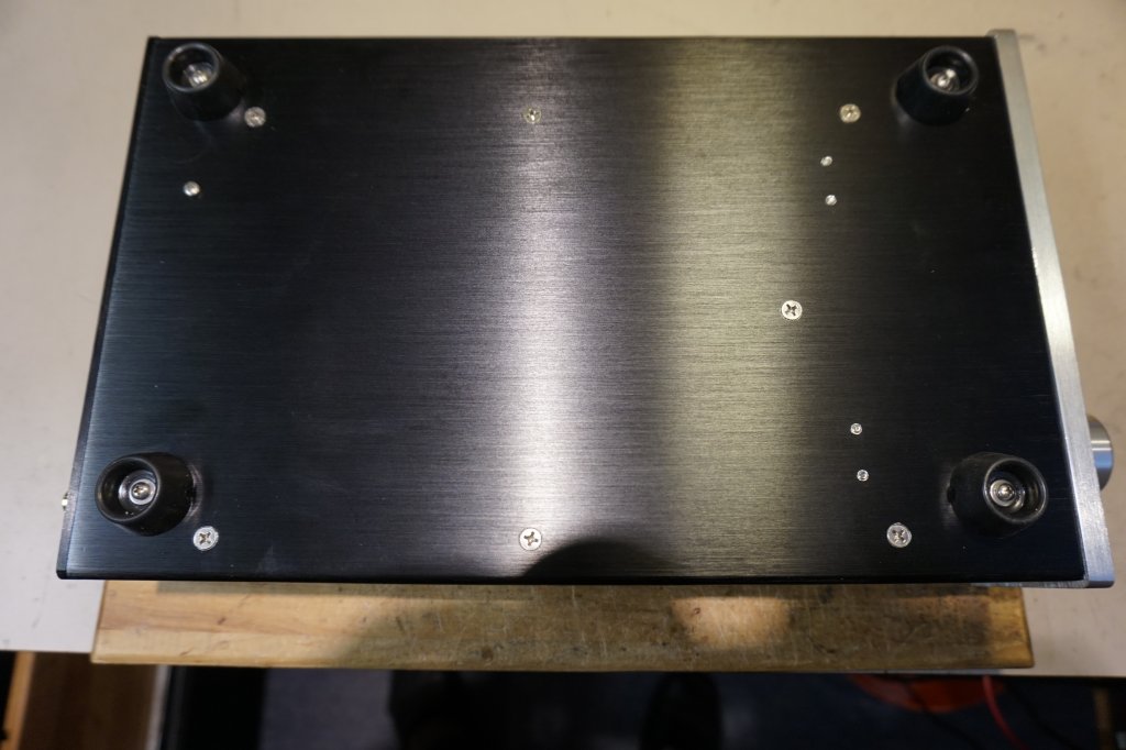

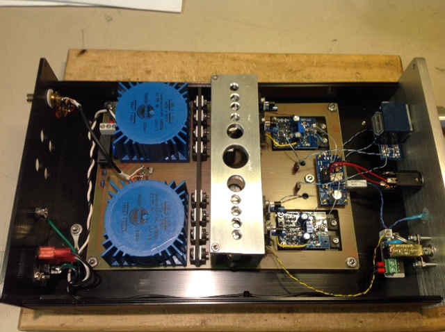

Completed the built, all done now. The chassis was probably designed for a small Class-D amplifier, hence the ventilation holes on the top. It was perfect for the SLHA. Once warmup, inside and bottom cover temperature is 36C, the regs heatsink is 41C, nice and cooking as a Class-A amp should be 😉
An other happy Diyer, see the pictures...
