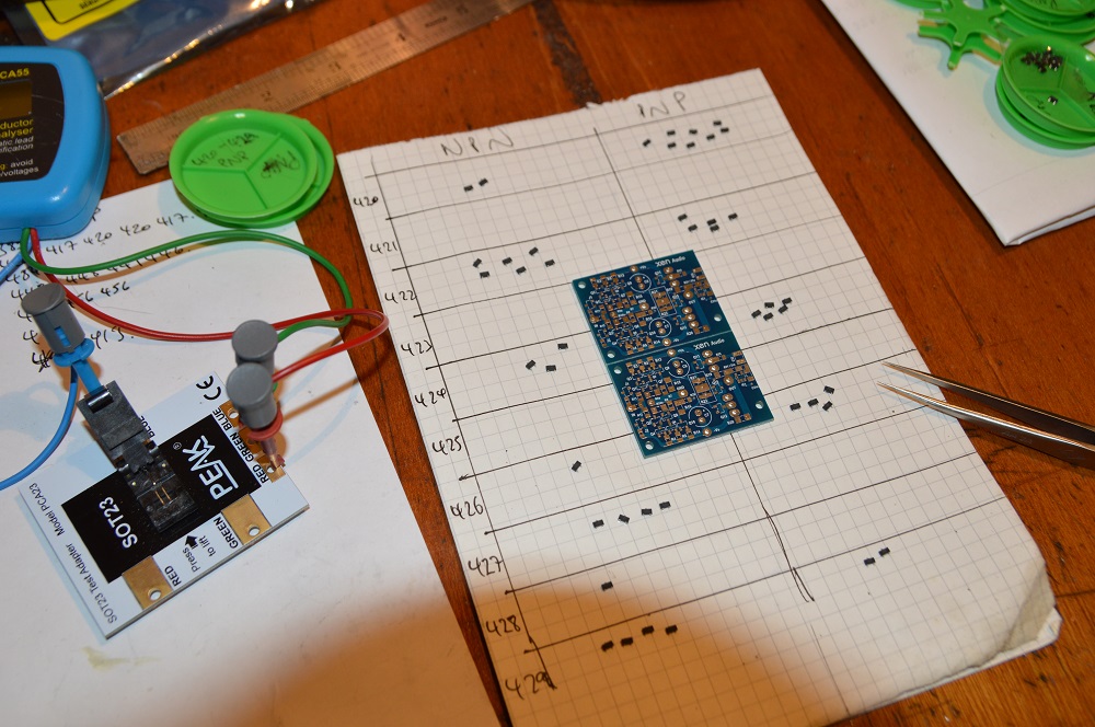

Afternoon matching BJT's yielded enough N&P's to get started on one pair of boards.My hfe distribution for both types was mainly in the 420 - 429 bracket and specifically within 422 - 427.
Looks like Q1-2, 7-8 will be exactly 422 and Q3-4,5-6,9-10 will be 424 - 427.
If I can help anyone with some values that they need should they not find enough complimentary matches, let me know I have many left.
Quite a few N&P's in the 430 - 439 bracket and many in the 440 - 470 spare.

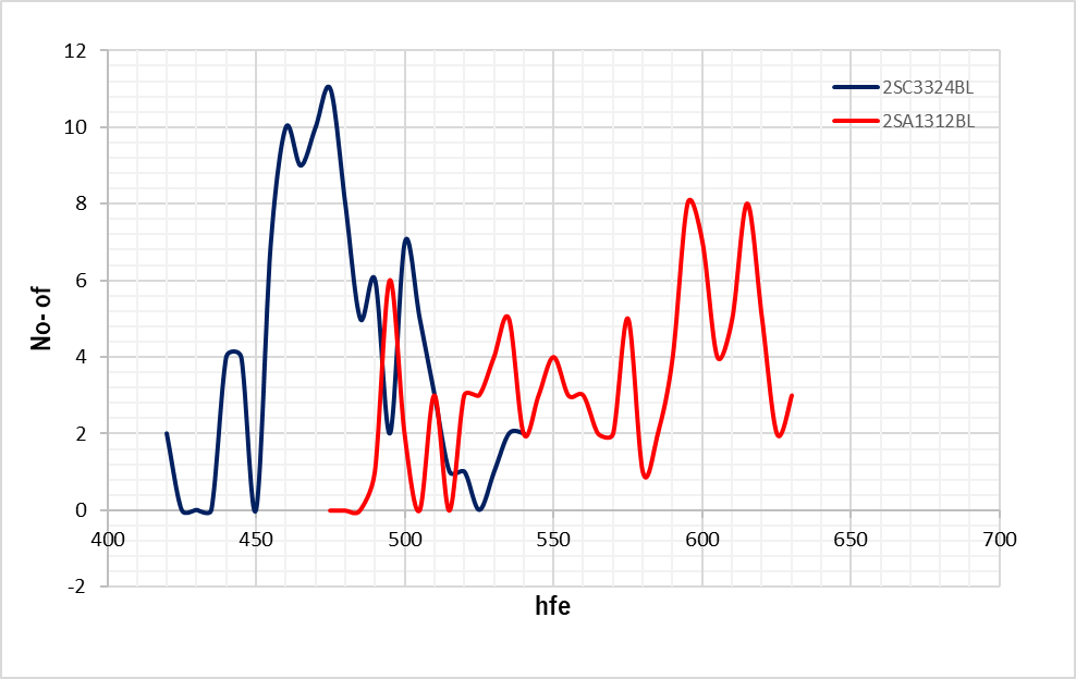

Interesting Patrick, it looks a similar distribution to your last graph a while back, your cross over values between the two seem the same as mine maybe slightly higher. Where did you get your parts? Mine were Mouser.

My test device is the PEAK DCA55 and their PCA23 adapter. Very easy to use and double tests on BJT's seem to hold consistent measurements. But I agree, in your local environment and kit they would be slightly different. In fact, it looks like my sweet spot is slightly lower than yours here in the UK Midlands.

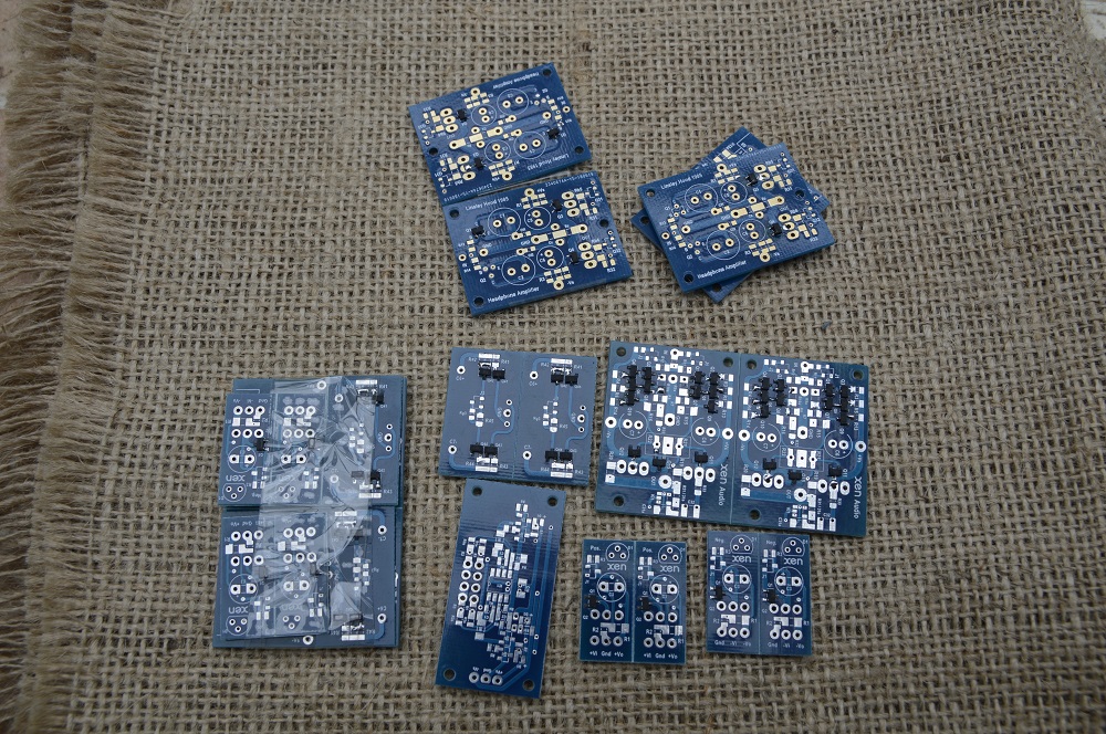

So all my BJT's are in. Both sets of Pioneer kits and two JLH1985 sets were fully equipped with appropriate matched parts. I have to say it is very enjoyable to work with SMD. Although quite exhausting, the focus and calm required is quite therapeutic.
My intention hopefully, is to try one set with JFET input, CSS without servo first and then one set different with resistor bias and servo depending on how my supplies behave. It would be interesting to try the new Salas ultraBIB regs on the Pioneer boards but they do take a while to settle.
Lovely little design Patrick, looking at hem it is hard to believe they are the business end of a good amp.

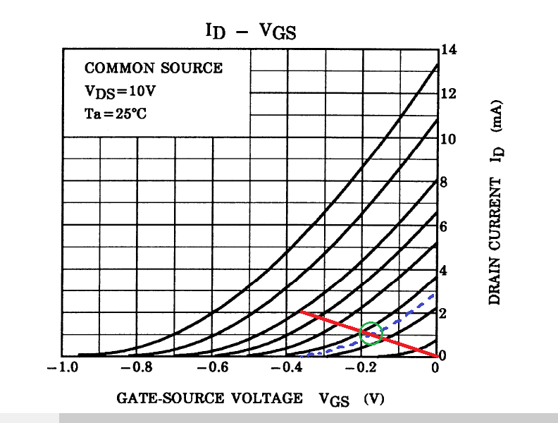

Patrick, the FETs are measured, forgive my ignorance but just help me check if I'm doing this right to find the CSS R45..
The Idss is 2.98mA for both CSS boards - looking at the datasheet Id-Vgs, 3mA is hitting the curve at 0.5V. So 0.5/2.98 = 0.1677 - 167R?
This is an example to degenerate a 2SK209 with 3mA Idss to 1mA Id.
The JFET's curve is approximately that shown by the blue dotted line.
Draw a (red) line from the originalto the intersection (green circle) of the dotted line with the 1mA horizontal line.
The slope of the red line gives you the resistor value.
In this case approximately 170R.
Patrick
