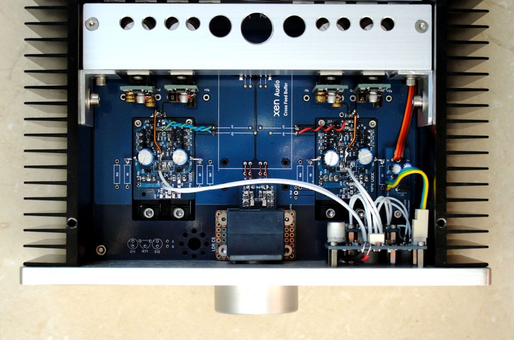

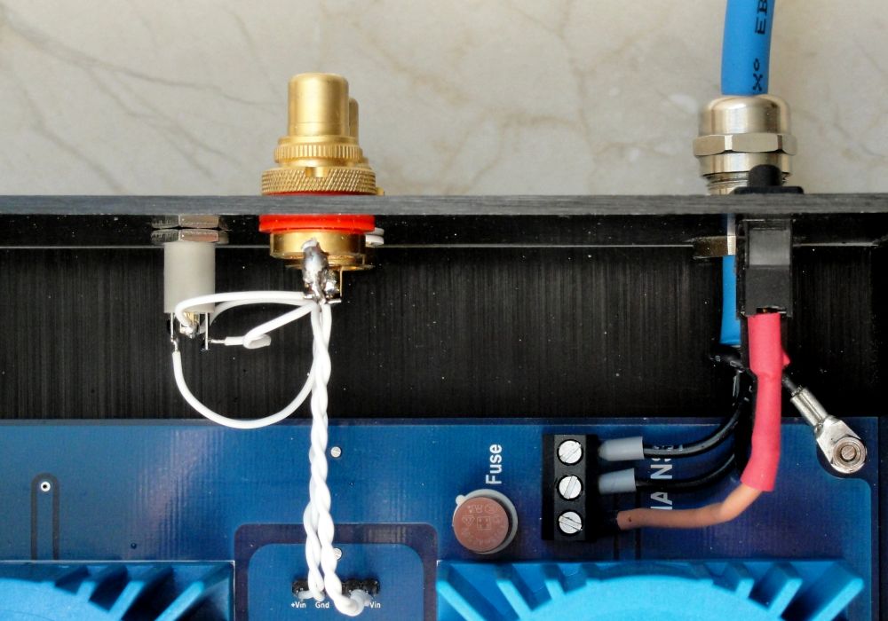

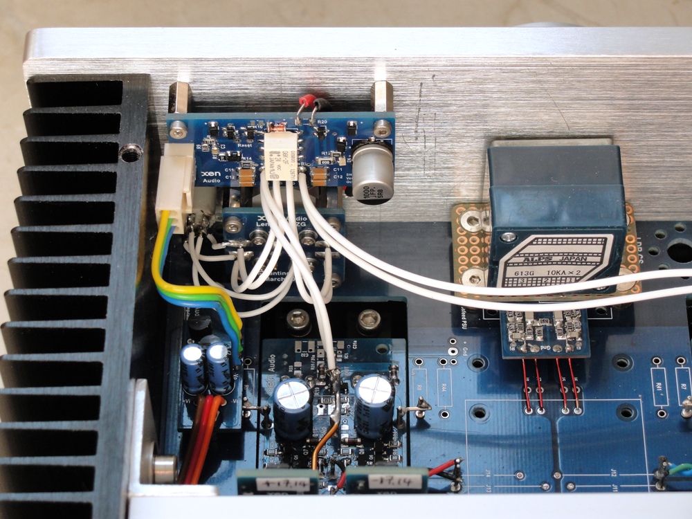

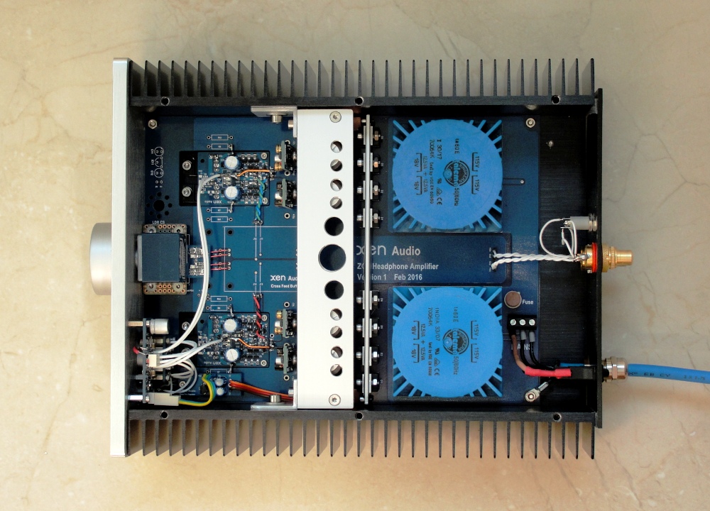

As my first proto amp went to another XEN team member, I wanted to build one for myself to keep.
Voltage is +/-18V; bias 160mA, using Didden Regulators.
SHPP is powered by separate 78L18/79L18 regulators.
Input has a 4-pole 3.5mm TRRS in parallel with normal RCA.
Output has 4-pole Lemo 2B sockets, also in parallel with 3.5mm TRRS.
Crossfeed is normal SMD XEN XFD Passive.
Pot is XEN modified ALPS with Susumu thin-film ladder network.
The aluminium top plate of the Breeze 2107 case is replaced by an anti-static tinted acrylic.
When the amp is powered up, the LEDs from the Didden regulators reflects off the aluminium angle to give a warm glow.
Patrick

I always use separate Gnd wires for the two channels for best image separation.
The only point where the two Gnds of L & R channels are connected is at the crossfeed.
They MUST be connected at the crossfeed.
All my headphones have 4-pole connectors, as if they were balanced.
Patrick
Mine is dual mono with one DCSTB for each channel with input Gnd connected to chassis.
Do I have to remove any Gnd connection to chassis? What's about an adapter when using SE wired headphones. Normally the adapters are putting the Gnd wires of both channels together.
Arnd
